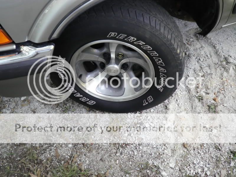

This is the same for all four wheels. The front you can turn the wheels to make easier access. If your doing left front you turn wheels to the right all the way. Right front to the left all the way. Rear...your just SOL.

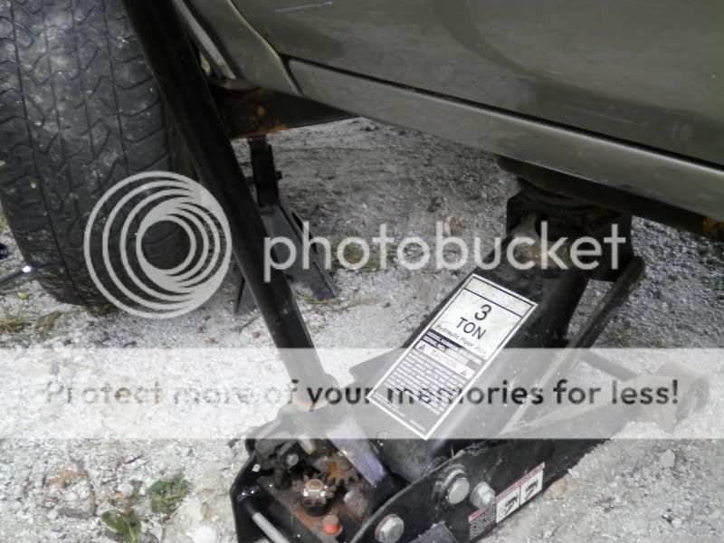

JACK-AVOID SCISSOR JACK IF POSSIBLE
Jack stand - a must...the vehicle is not worth killing you if the jack failed and came onto you dismembering you are killing you.

2) Jack up the vehicle and support it with jack stand
3) Remove the wheel

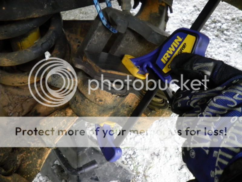

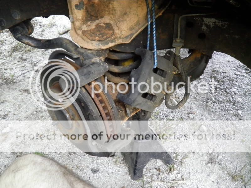

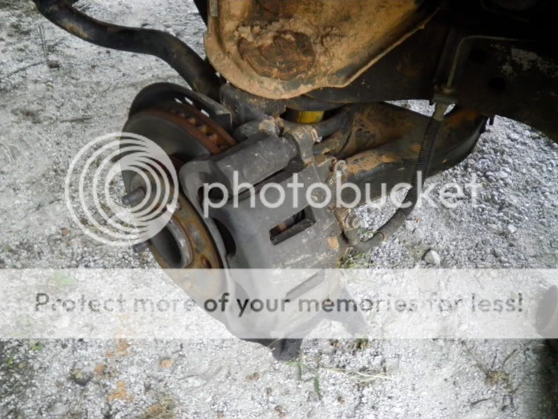

4) Locate the two 18mm bolts holding your caliper to the caliper bracket...remove them
5) Support the caliper with a bungee cord or anything keeping tension off the line

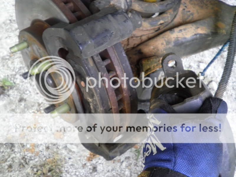

6) After doing this remove the two 18mm bolts holding the caliper bracket onto the vehicle and remove rotor at this time

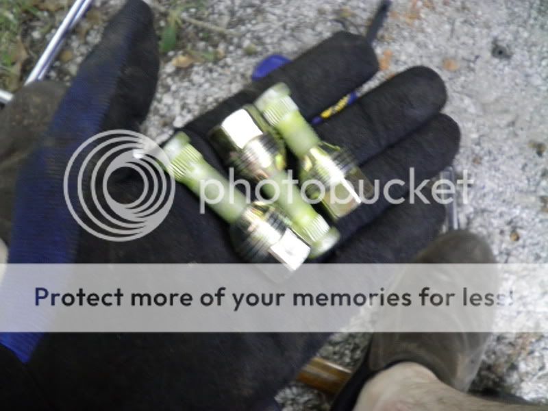

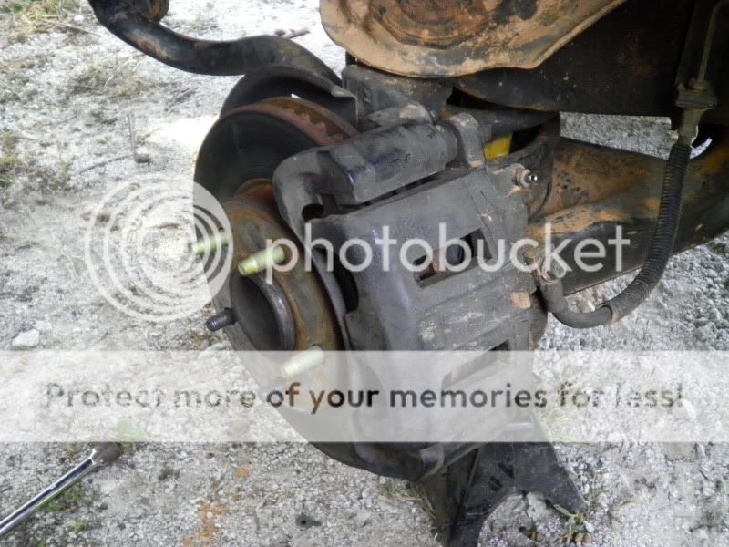

7) Now you have access to the wheel studs...nice huh wonder why I needed to replace them

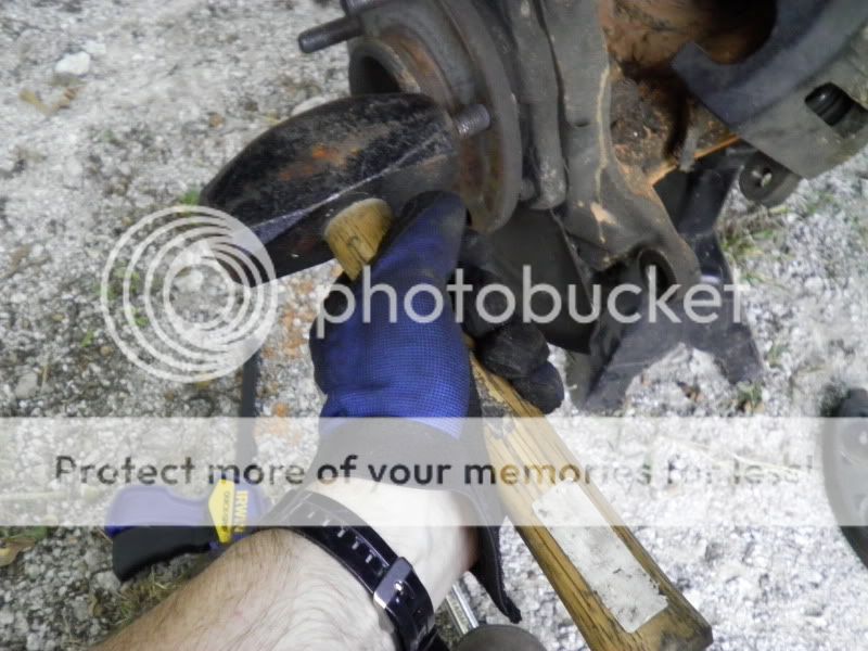

8) Using the 5lb hammer take powerful short control slams into them...mine took about 5 each

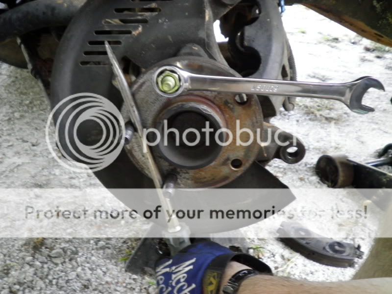

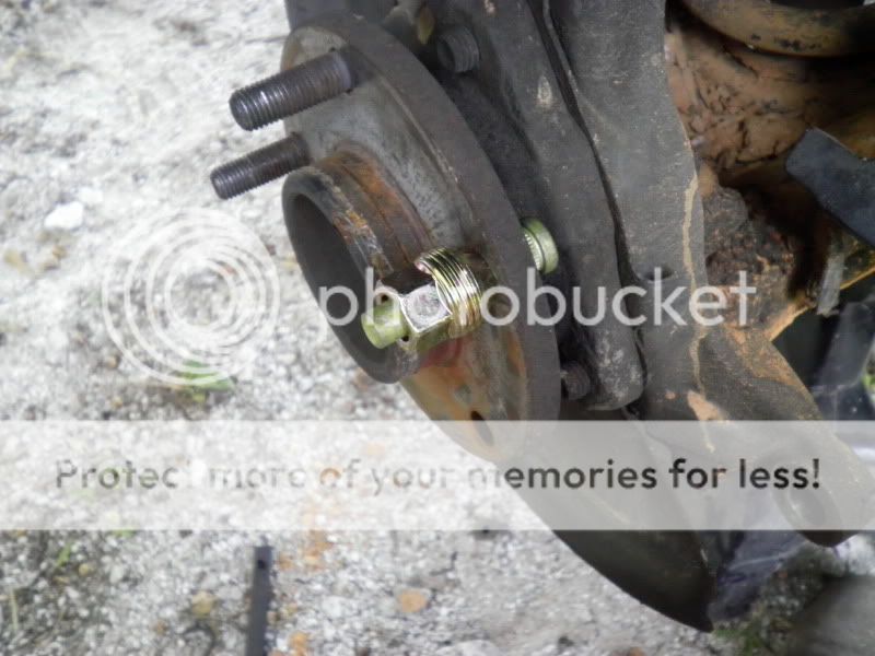

9) Now that you've removed all of them it is time to install the new ones. Slide them in and take the nut and screw it all the way. DO THIS ONE STUD AT A TIME...its just easier.
10) Now using the screwdriver and 19mm wrench...tighten down the nut until the wheel stud is FULLY SEATED on the wheel hub.

12) Install rotor, caliper bracket and pads in reverse order. Compress the caliper pistons prior to install as this will make it easier.
13) Install caliper

one thing i'd suggest is using a bigger nut, one that the lugnut will seat on. put the stud through the plate, then put the bigger nut on there, then screw the smaller nut on the stud. grease the bottom of the lug nut so it spins on the bigger nut without the bigger nut spinning against the plate. then screw it in until the stud seats.

I'm curious as to why you removed the caliper from the bracket and then removed the bracket? Why not just remove the bolts holding the bracket and save a step? Seems to work for me any time I change pads or rotors or hubs or...well, you get the idea.
