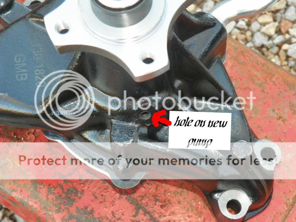

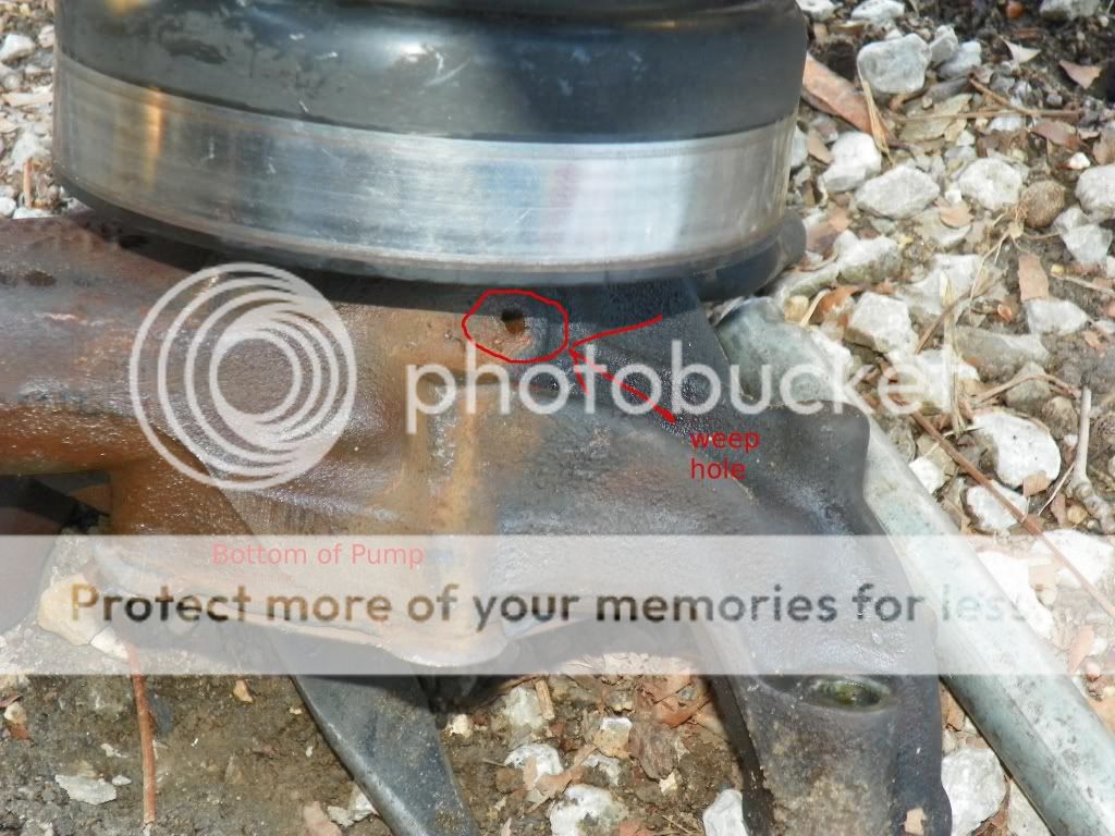

Originally Posted by jamel
What are the signs of a failing waterpump? I have a 2000 chevy blazer and I think I have a failing waterpump. info from anyone would be helpful!
Mine started leaking. There is a little hole on the front part of it that leaks coolant once the seals get bad. That was the only symptom I got from mine when it went bad.
Where is this hole? Under the pump? So no leak, no play in the waterpump itself and no overheating = good pump? If there is an antifreeze leak anywhere, wouldn't it smell like it? I had a blown radiator and old radiator hoses when we bought this truck (overheated on the way home from the dealer. Steam coming from the 4" gash in the radiator tank) and we could smell antifreeze coming from somewhere.
I drove mine for a year with it leaking out the pump. It seeps out and forms a puddle under the front end. You can also feel under the water pump after running it a little. I could also see coolant leaking down the front of the engine. I'll put some pictures on here to show you the hole I mean. It didn't leak out enough to cause an odor, and didn't cause any overheating. It always ran too cool. If you can still smell antifreeze after ruling out everything under the hood, check you heater core. I had a mid 80s Cutlass blow one, the windshield would steam up and the inside smelled like coolant. It was pretty obvious what had happened in that case.
