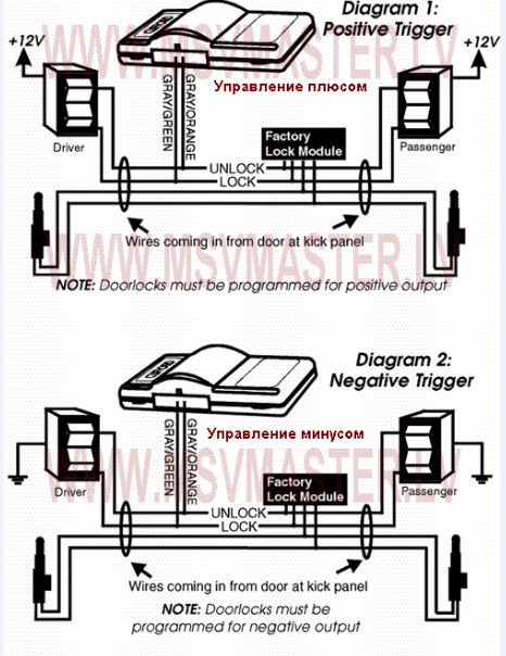

hI BLAZER DOOR LOCK HAS A NEGATIVE TRIGGER ?
CAN YOU EXPLAIN THAT?
I thought Blazer has a positve trigger. The Hot orange ist doing to the door swicht?
BR
Bob
BR
Bob
