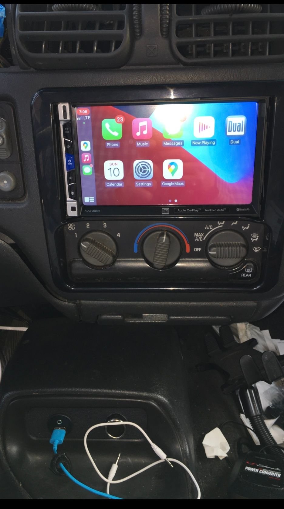

I’m using a low budget Dual XDCPA10BT with a Metra dash kit 95-3027 . Radio head unit is like $120 and kit is like $39 . Has Apple wired CarPlay , Bluetooth and Android auto . Also has backup camera snd voice control capability . Sounds ok and seems to drive upgraded speakers I have .Requires slight modification to dash plastic between existing radio and HVAC controls and instructions are in kit , but after install looks pretty factory install. Metra also has a wire harness adapter kit that may make it easier, but I just cut and spliced wires .
I also removed the factory remote cassette unit in mine and fabricated a plastic plate to cover it with a USB port attached to head unit in it for phone and usb thumb drive connection and an additional power outlet . It’s been 3 or 4 years and have had no issues with it
