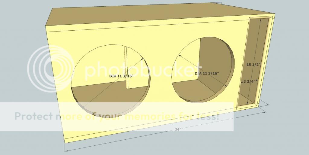

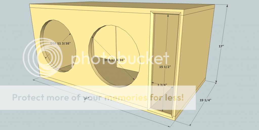

Hey Alton. Can you please get me a box drawn up soon? Guys over on CACO and SMD forum are being a holes -.- and I'm about ready to build this box. Tomorrow if I can get a design from somewhere today..

I drew this up real fast from the dimensions you gave me in other discussions.
It's 3.5cuft NET tuned to 33hz with ~58sqin (3.75" X 15.5") of port area. The enclosure measures 34" W x 17" H x 19.25" D and is about as basic as one gets. If you want to do something any more elaborate such as a double baffle to flush mount the subs or anything like that it wouldn't take much to make those changes. This should do you very well for the SQ212's and most other 12's would be at home in it as well.
Have fun with the new setup!
