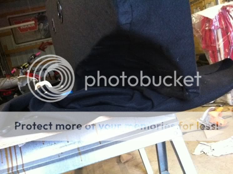

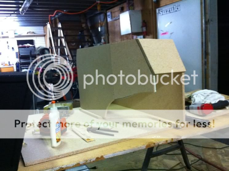

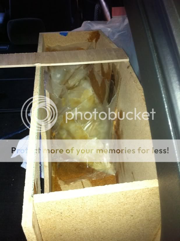

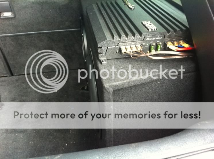

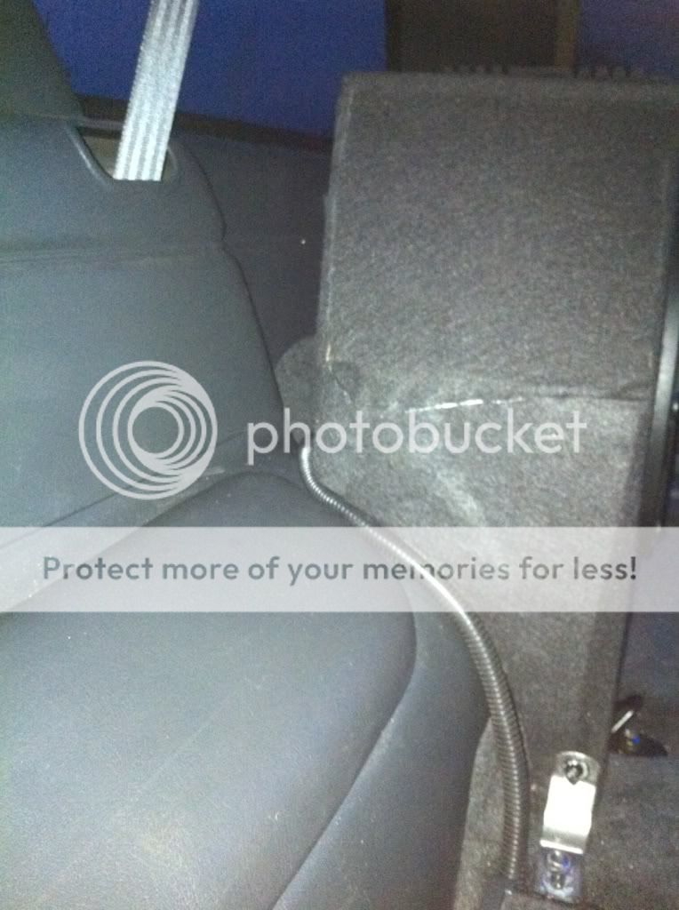

This weekend i finished building a custom sub-woofer box for the back of my blazer. Here's what i got!
Making out the shape
Starting to come together.. with a whole cut out for the wheel well.
Fiber glassing a mold to form over the wheel well
Box is now wrapped, and there's the mold..
And here is the finished product!I had to take off the ring on the outside of the right sub, it was rattling around.
And a better look at the custom mold, its not perfect but it'll do.

looks very nice! Are those the KFC-W3012's? and what kind of amp?
I have a single KFC-W3011 and man that thing hits hard. Shakes my whole truck with my 600 watt JBL powering it.

One is a KFC-W2513PS and the other is a KFC-W2512. Made a mistake when ordering them and got two slightly different ones. The amp is a PhoenixGold XS2500. (Kinda old school)
My old set-up would hit hard with just the KFC-W2512 and a jensen power 400 amp but this set-up is just insane.
