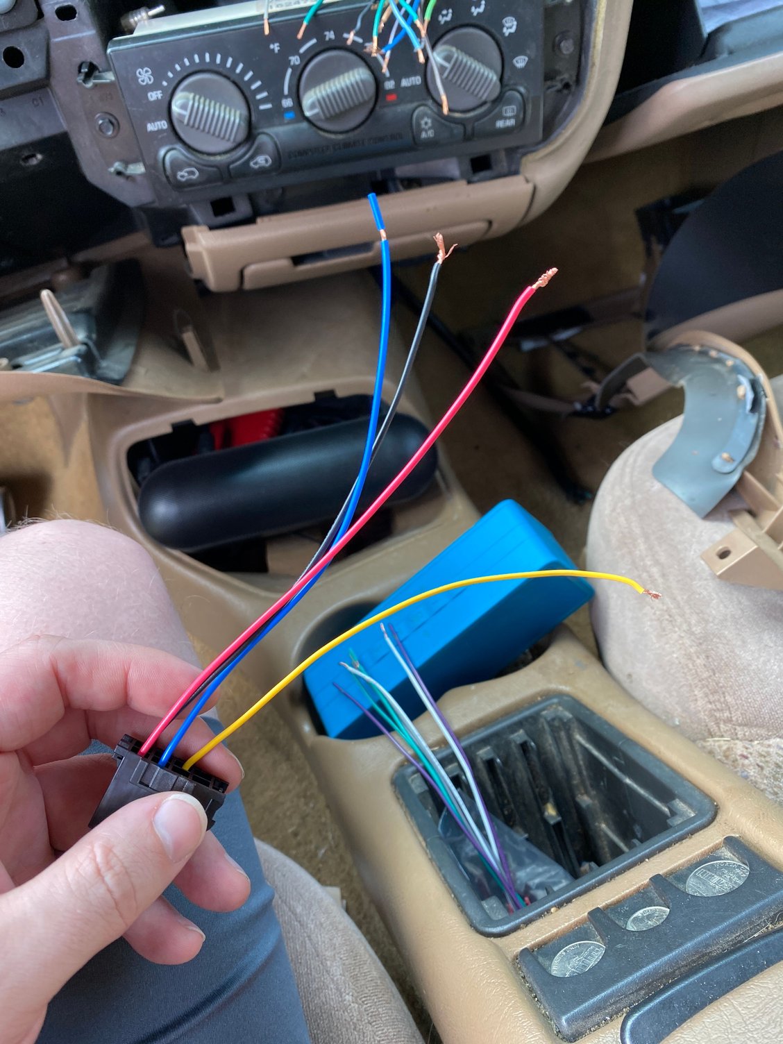

Hey guys I need help with the radio installation when I got this truck from a friend didn’t have a radio and the radio plug was stripped from the wires so I’m trying to figure out what wires goes with what. The radio I’m trying to install is a
boss 616uab
This is the truck side radio harness
This is the radio side

Someone really didn't help you there but find a wiring schematic it will identify the speaker wires so you can hook those up. Traditionally Black is ground and you may have to ground the chassis, red is power which I don't see on your truck side wires and orange is the dimmer.
Looks like there is are steering wheel controls and possibly a bose amp under the console but those are just guess from some of the wires I see.. Best bet would be obtain a factory plug and solder it on of buy a new one and re pin it.

What year. If it is a 99 I can help with a schematic for you.
it is a 99. Anything will help
Old Apr 13, 2020 | 02:08 AM
Here ya go!
Report back if these are what you need or not.
Good Luck!
