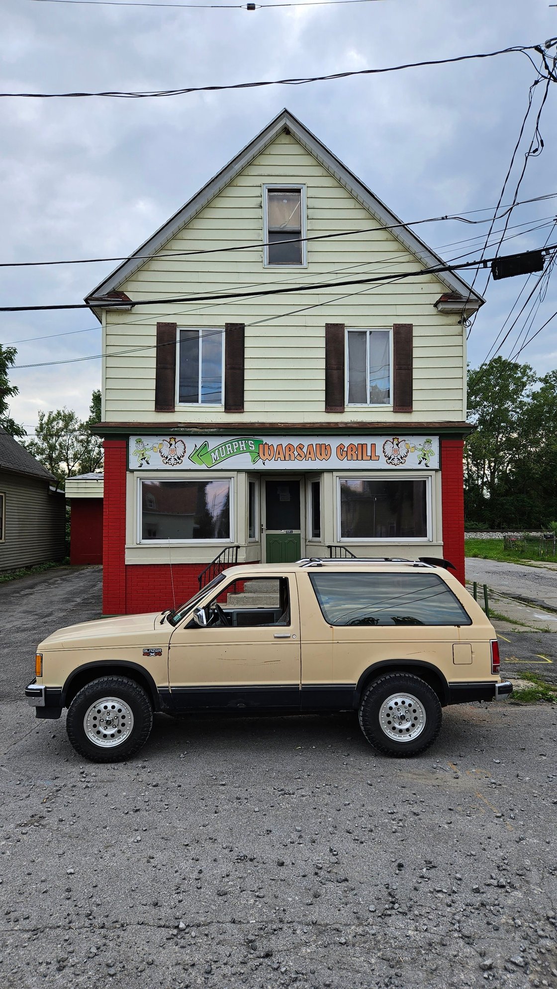

Recently got an 84' Blazer S10 in pretty good shape, but the head unit wasn't Bluetooth so I wanted to upgrade. The old head unit was having power issues, cutting out and restarting intermittently and eventually every five seconds.
