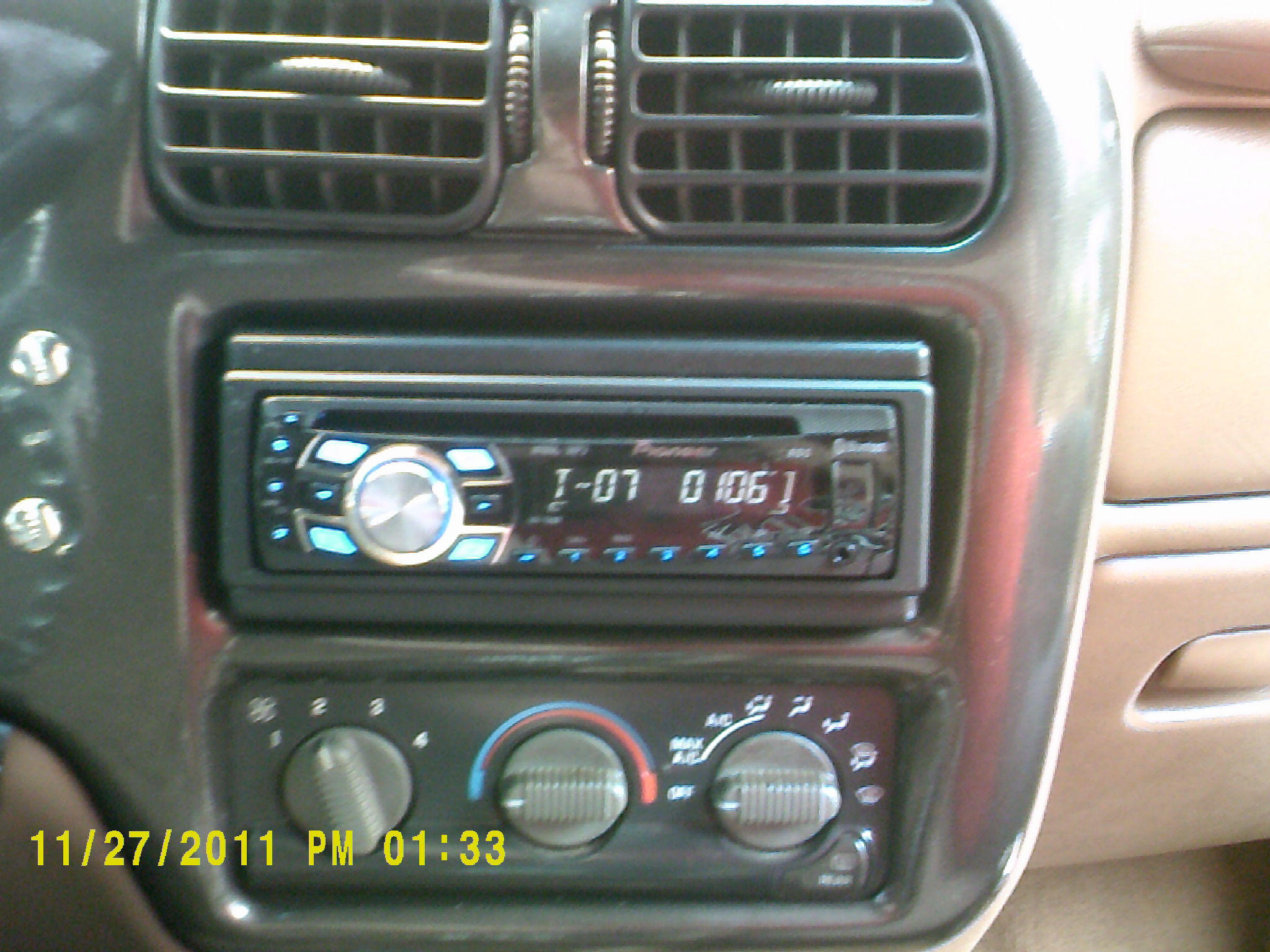

My new head unit with built in blue tooth.50/4 channel and came with 2 new speakers. What an deal It sounds great and the phone thing makes it even better.

Cool stuff. BTW Pioneer EXCESSIVELY over rates the power on EVERYTHING they make. 50x4 is the peak wattage but the RMS is actually something like 11 or 18 watts. Not that it's a problem with a head unit and if you're happy with it great. Just keep that in mind if you do add ons. Ex. If you want to put a sub in and go with a pioneer that's rated for 1000watts but use say an alpine 1000w amp.....You'll be SERIOUSLY overpowering that sub because when Pioneer says 1000w they really mean 300w RMS 700W peak and who the heck knows where they got 1000 from.
Just a head's up. I found this out (and it was proven to me) from an audio installer I know.

Looks good man.

Yep that'll work great just to power door speakers

Yes 2 speakers that went in the front doors, and then picked the best out of the four factory speakers for the rear until I get some more cash.
