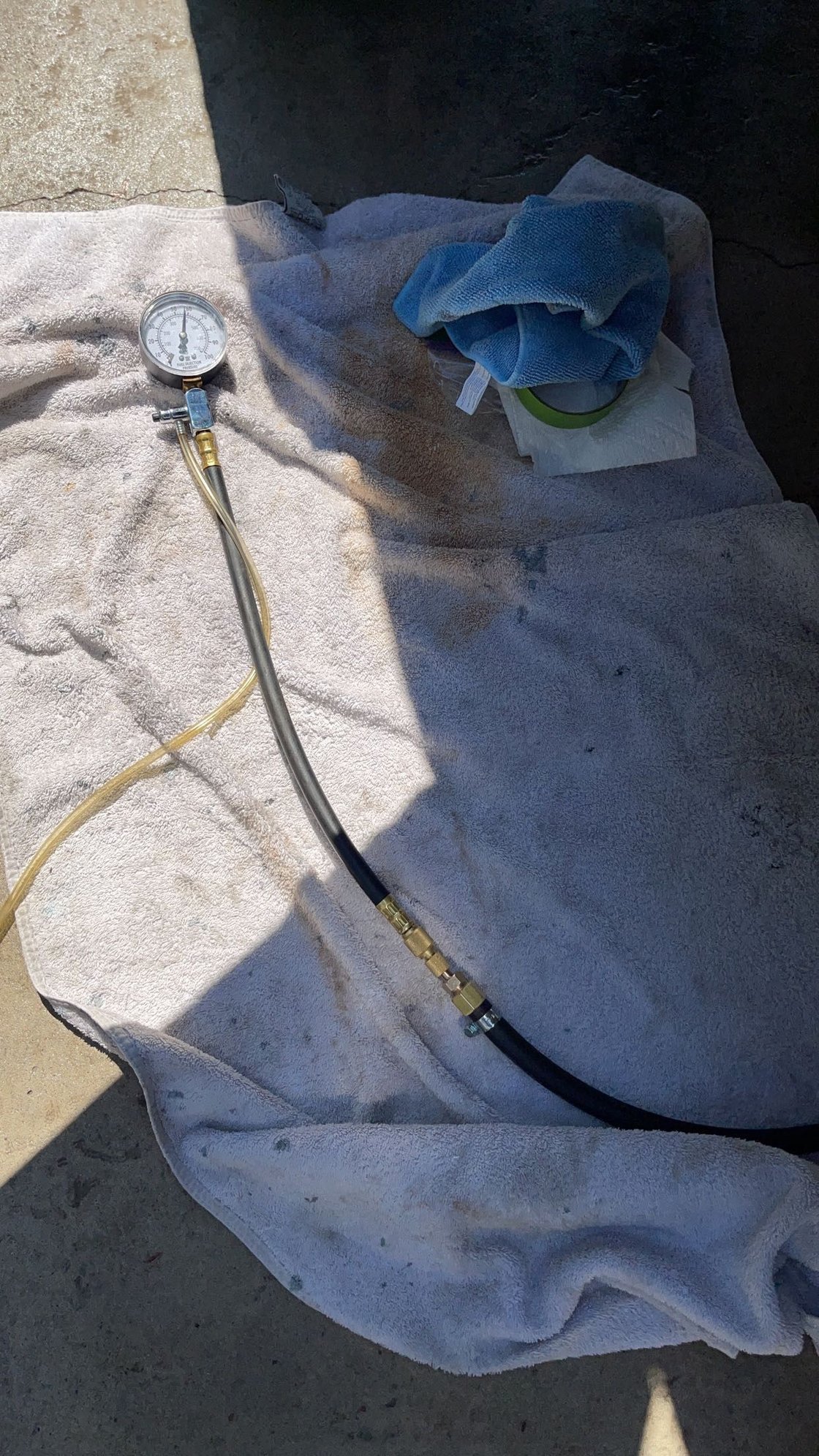

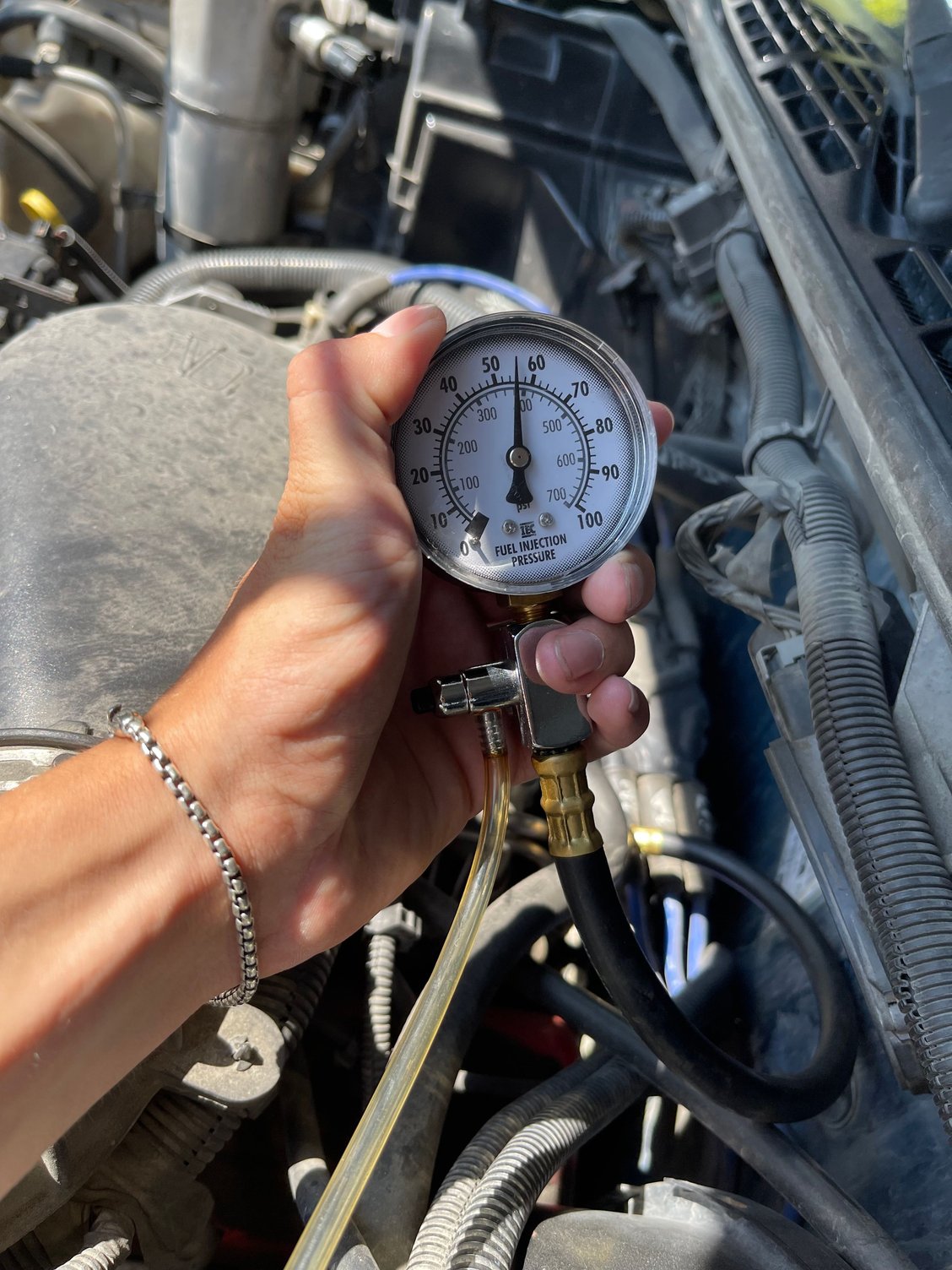

Thanks Les, I took the blazer into town twice without issue now and got the adapter made! NAPA had one of those Dorman fittings in a nearby store and I was able to get the 3/8" hose and fittings from my local hose store. BIG THANKS to Christine and the info posted on the "Fuel pressure test results interpretation help needed" about the adapter fittings, couldn't have done it without that, even the guy at the hose store needed the picture of the setup to know what I needed LOL. I have looked at making this adapter for a long time now, Christine's method of using the adapter that comes with the pressure tester makes it so you just need to go from the normal Schrader valve thread to a 3/8" hose, and those fittings are much more common, pics below.
So after letting the thread sealant dry last night I was out ready to test today, I'm very relieved my pump would only pump to 58psi!! It was crazy, like I still had the regulator in the mix because I see the same pressure at the service port lol. I tried over and over I think 5-6 times of priming it once it was at 58psi and it would not go up anymore, I also checked my battery voltage just in case and had a strong 12.8V. Needless to say I'm very relieved I got this adapter together when I did and finally did this test! I have falsly blamed the fuel pump a few times before as its about the only thing that's not brand new and could make the engine not run well, but this time it looks like its really the problem. I guess it's only fitting, I've probably had it gasping for air running at highway speeds pretty much all day everyday for the last month. Now I'll order the new Delphi pump and get on installing that, I think I will also do the fuel filter and get a new lock ring while I'm in there, and maybe also clean out the tank while I have it out. I'm so happy I have found the problem! Once it's fixed I'll be able to take it back up in the trails with confidence. Pics below of pump test first, service port test second.

58psi is pretty odd, but definitive on the fuel pump. Good job diagnosing.
