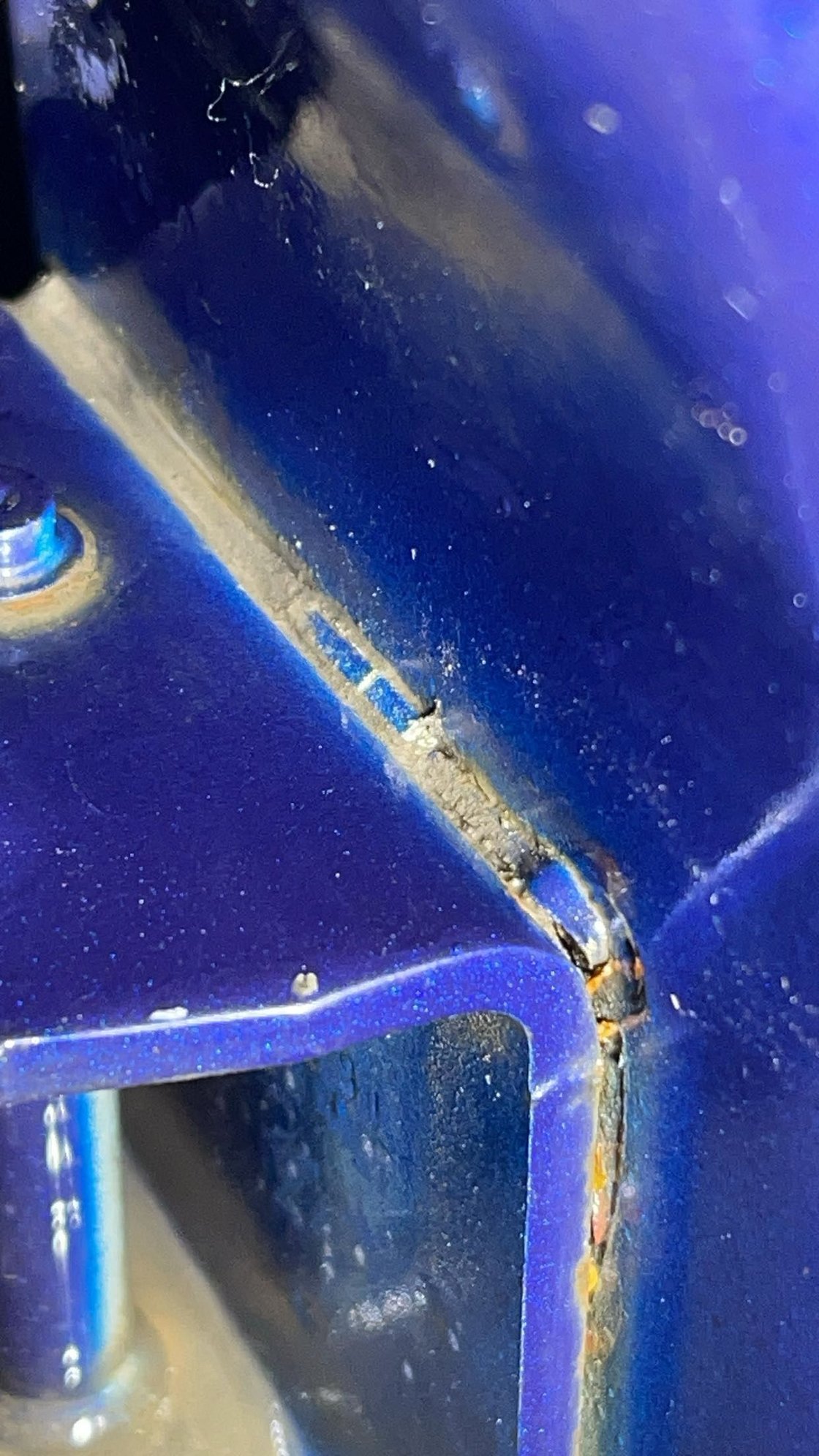

The blazer has continued to go strong everyday ever since the fuel pump replacement a few months ago. I have even got it up in the snow more than I have other years, I went up with a few friends for some Christmas Eve snow wheeling, at one point the blazer was stuck in snow all the way to the frame. I've been airing the tires down to 10psi for the snow whereas in other years I only did 20psi, the difference is pretty incredible.

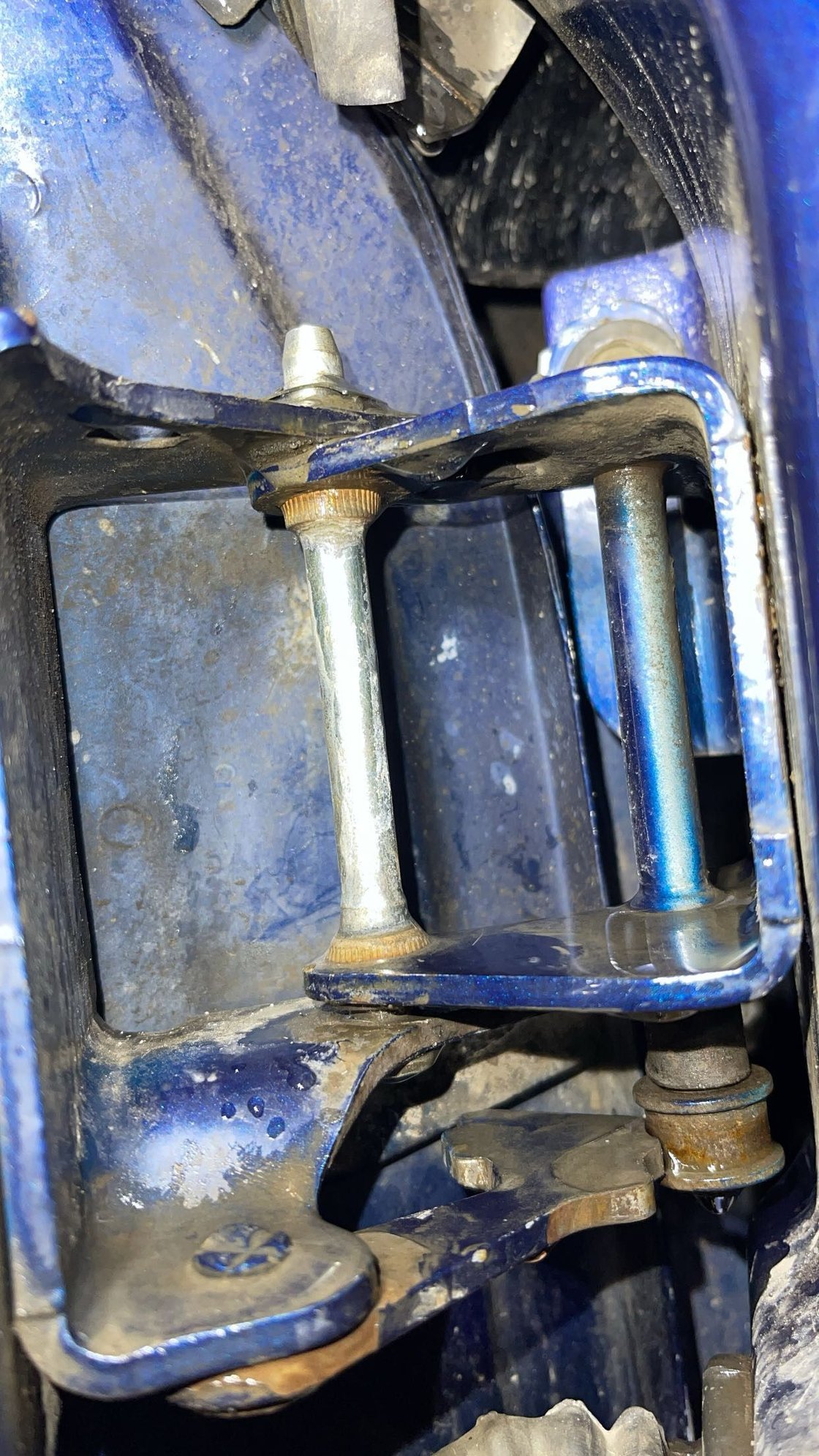

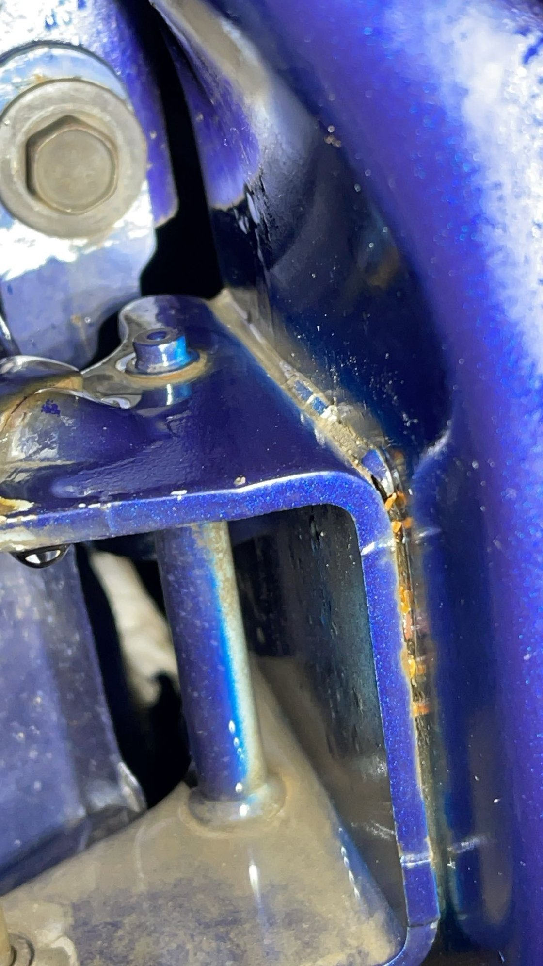

Now not all is perfect, I'm lucky I have some time off now so hopefully I can sort out a few of the problems with it. Some of you may remember the clunking sound I was trying to find a bit ago, well the sound finally got worse after I had checked just about everything already, eventually making the sound every time I close my door as opposed to just while going over bumps, it also does it constantly while driving now. Anyway, it turns out the weld on the door mount broke on the body side and that's what's been making the sound. I plan to take the door off and put some wet towels down to block the interior then weld the mount back on, picture of the crack below.
In addition to fixing the door, I also have to figure out my steering box. It has so much slop in it already since replacing it over the summer, I have driven a very long way but still, it shouldn't be this sloppy already. I'm deciding now whether it's worth getting another box under warranty then it will most likely need replacing in a year or so again, or get the redhead and hopefully be happy for a while. For now, I'm driving around with the steering wheel crooked everywhere and it's already cooked the driver-side tire to the wear bars on the outside. Wheeling is also no fun with this much play in the steering, I'm kind of leaning toward the redhead for that reason, I will keep you guys updated with what I end up doing though!

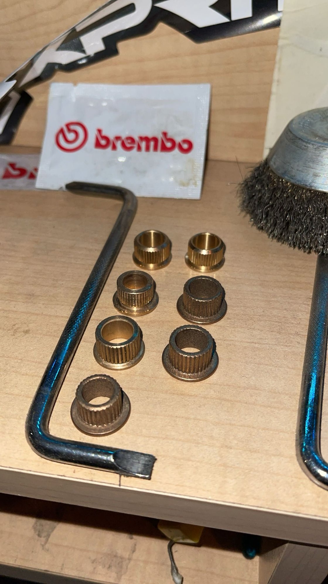

So I have a few big updates here! First the door, I took the door off and almost immediately noticed what was going on, one of the bushings was in 2 pieces! So upon further inspection, the door mount is fine, however the holes for the bushings were worn out badly to the point I could just drop the bushing in the bottom hole. So I went off to get the oversized bushings blazen red made a thread on a bit ago, I used 0.01 oversized on both the top bushings but got the 0.02 as well just in case. Those bushings seem much stronger than the stock ones which is an added bonus. I guess that takes me here, it turns out that clunk I have been wondering about for the last 2 years was the door bushing all along, LOL. Let me tell you the satisfaction of going over bumps and it doesn't sound and feel like the body is falling apart, it's much better now. However, not all is fixed, after a few days the clunk started to come back and I still have some sag in the door which I'm guessing is causing the noise. It seems like the hole on the door side of the upper mount has also worn out so it has play on the pin and that's whats causing the sag, the new bushings and pins are all tight. I'm not sure what else to do other than replace that door side upper mount, it will be pretty nice with a door that doesn't clunk or sag at last though. While I had the door off and the blazer in the garage for a bit I jacked it up to see whats going on with the steering, and my pitman arm already has tons of play! That one wore out crazy fast, but that explains why it's feeling so loose. I guess I have some work to do here...

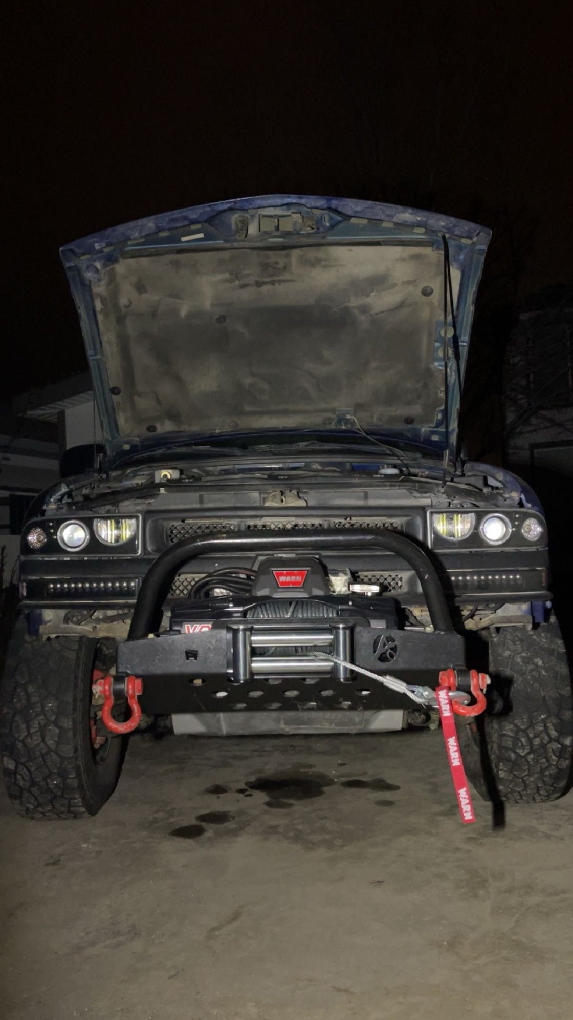

Today I got myself a late Christmas gift, a Warn 10k winch. I just have to hook it all up but it should bolt right into the spot on my bumper, I'm so excited to get out there again and try it out!

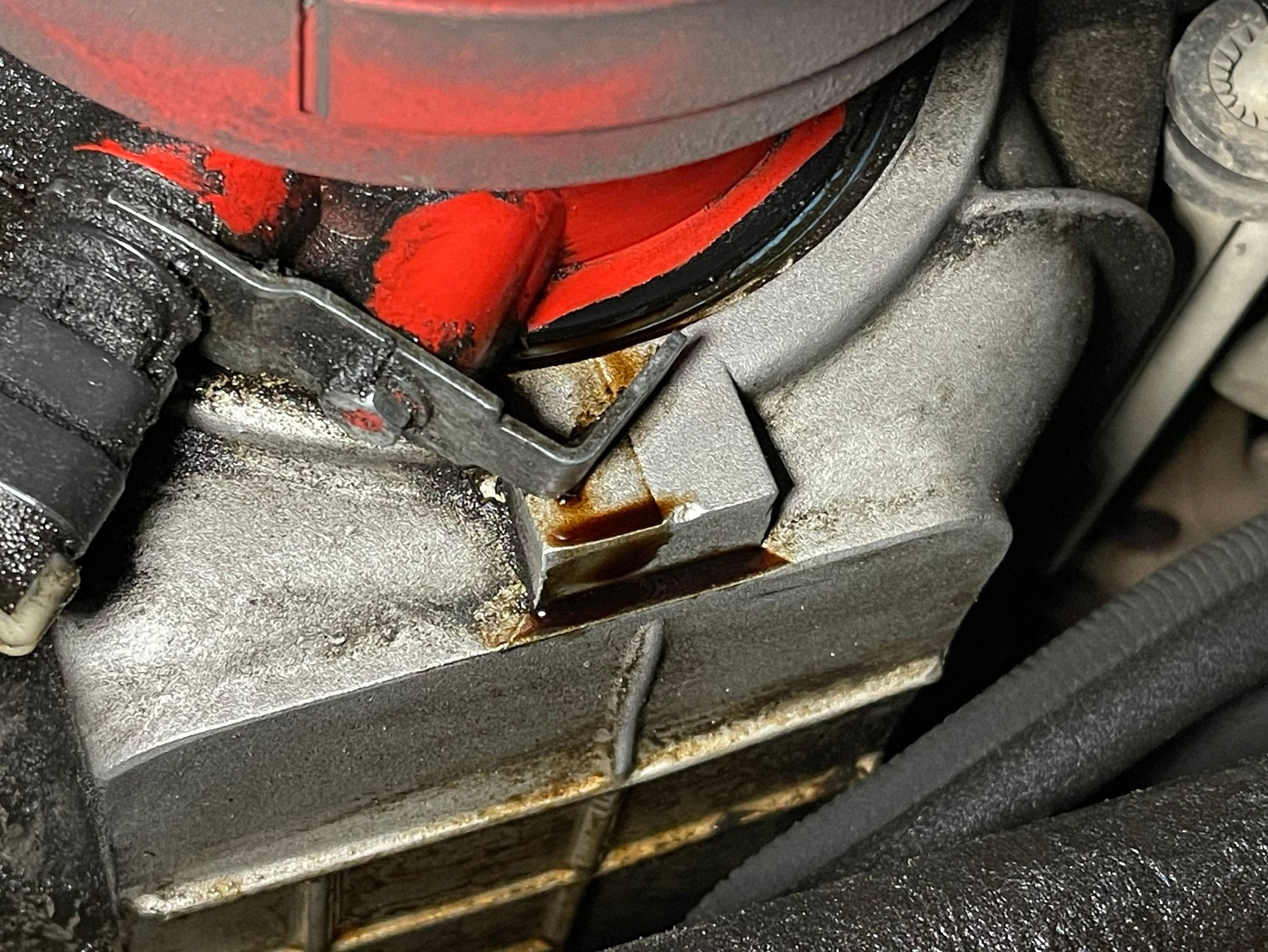

The new rad that I put in before the cross-country trip last summer has also recently failed and now has a small leak from the core it looks like, I'm already looking at a new one maybe with some warranty this time! On top of this, the blazer has started dumping oil from what used to be a very slow leak, I took the skid plates off yesterday and cleaned the area so I could see where it was coming from and I saw it coming right from the front of the oil pan. I think it has been leaking there since I did it a few years ago just never enough to leave drips anywhere or even make a difference between oil changes. I haven't re-torqued the pan bolts since putting the pan on so I may try that this weekend, it would be a real bummer if I had to drag the engine out soon to fix this leak though. This picture is after I cleaned the area and ran it for about 5-10 minutes.
I got the winch installed the other day as well, it fit just barely without trimming the grille or anything. I turned the torsion bars about a turn on each side to get it back up where it was before.
