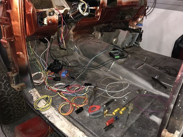

Default Engine Ready and Wiring Fun
Generic 22 Circuit kit from Speedway .... seems simple enough. Just don't throw away your wires from temp control unit to the blower / compressor / etc., cause they ain't here, only the power to the control panel.
Dakota Digital instrument panel. Comes with sensors, so those wires from the 22 Circuit kit will go unused.
Not sure how this aftermarket steering column is supposed to attach .... the wiring connections are fine, but the hardware ain't plug and play.
Fun with fittings on aftermarket intake ... Still trying to find a vacuum fitting that will clear the back of the carb.
A 3/4" aluminum angle bar across the fan shroud made the radiator install pretty clean and solid.
