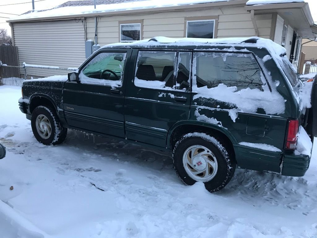

I haven't posted a photo in a while, so I figured I'd post one today. It looks good in the snow:
