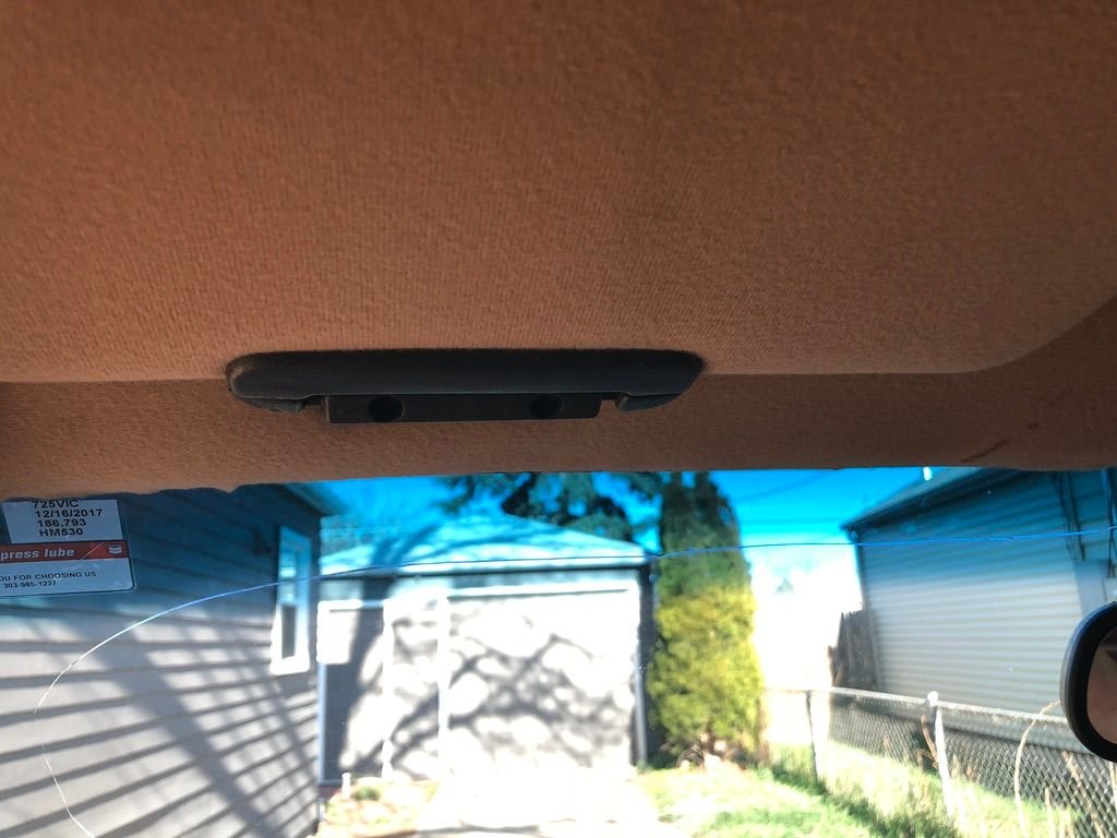

I used hem repair tape to stick the headliner edge back into place. I'm not sure how long to expect it to hold, but we'll see.

Your headliner pic showed up yesterday, but I'm not seeing it now, or whatever you posted before.
Headliner looks good. Better idea than what I had. I got a bunch of those upholstery tacks/screws and used those in the same spot on my blazer. At least I don't have to worry about adhesive, but it doesn't look as nice. Hope yours holds though.
