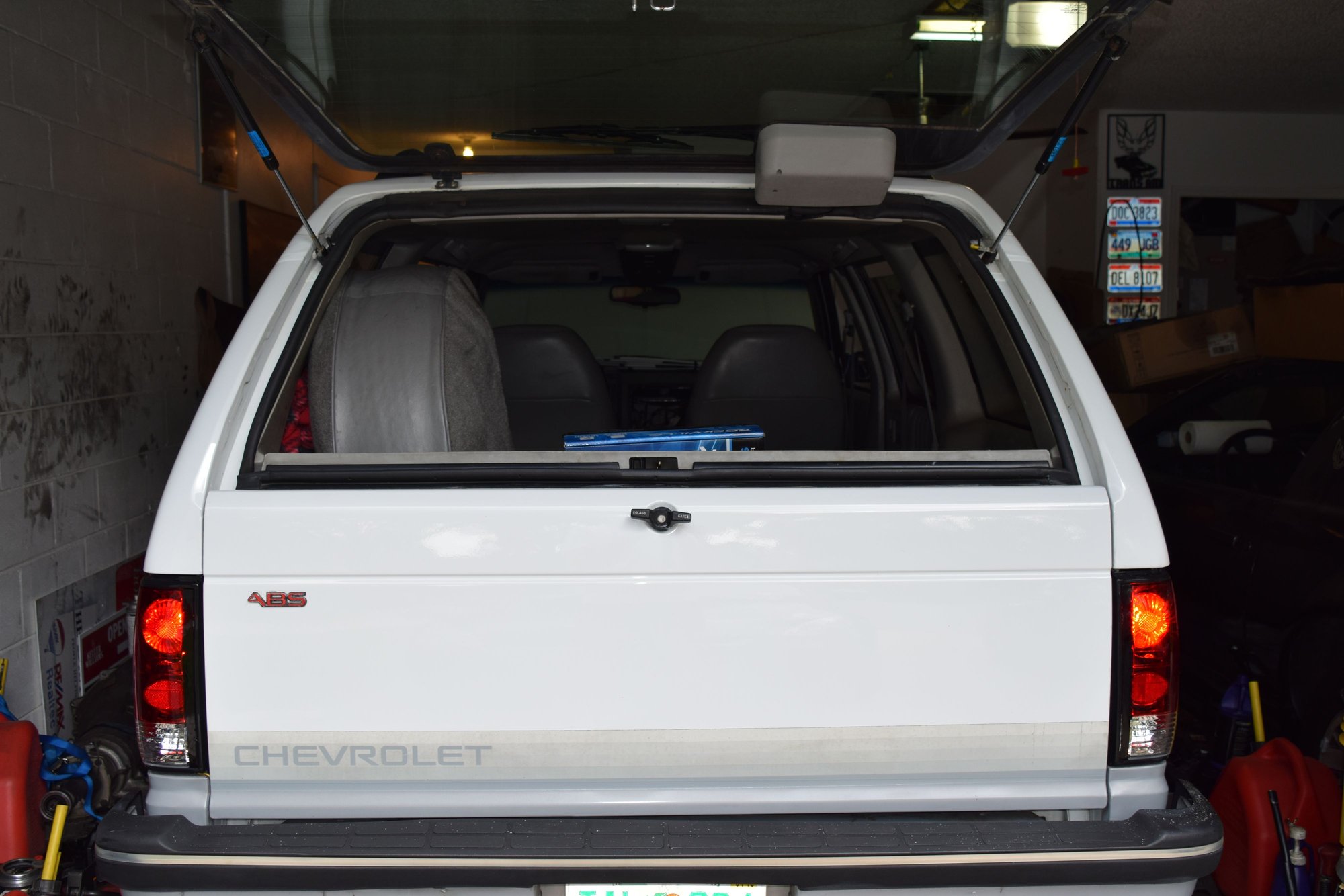

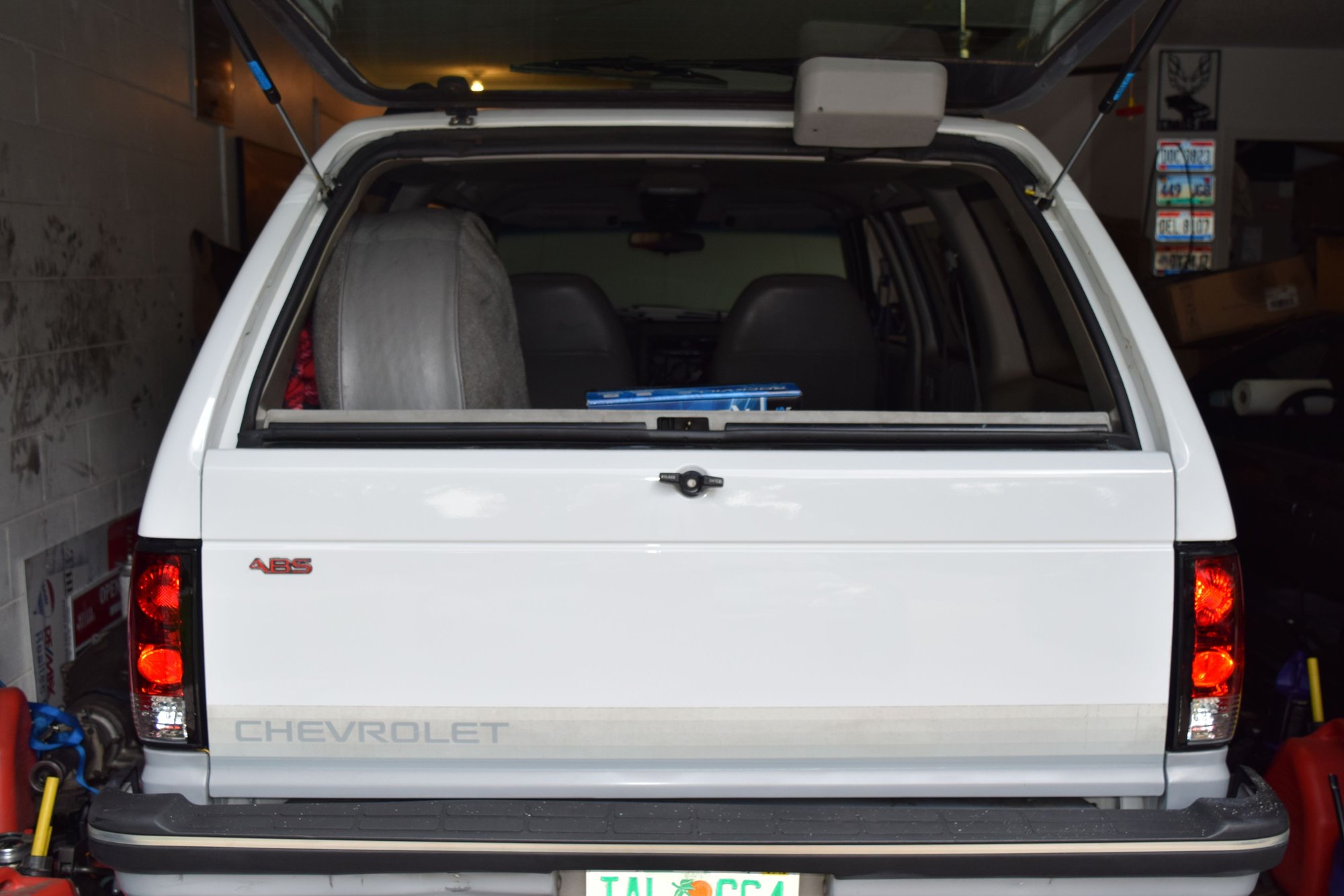

Here are a couple pics of the LEDs I installed for the tail/brake lights.
Both pics are with LED installed on Pass Side, Stock on the Driver Side.
Parking/Running Lamps:
Brake Lights:

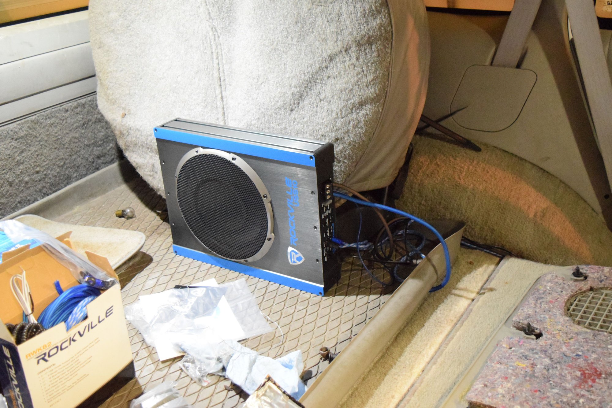

Here's the sub installed in it's stop for the time being:
I'll work on a more permanent install once I get the rear tire carrier, and get some more room inside.
