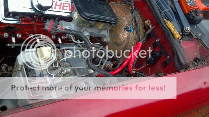

looks like i'm gonna learn how to make brake lines, the factory brake lines on the driver side all coiled up is touching the headers... Guess i'll just delete the abs module while i'm at it

Old 09-05-2013, 06:30 PM

Beauty, makes me wanna get mine swapped! You should pull the ABS module out as well, it won't work anyway with the ECU removed. It helps brake pedal feel immensely!

i was thinking about it but then i'd have to get creative with the brake lines. Lol. I'm still trying to figure out the power steering hose
