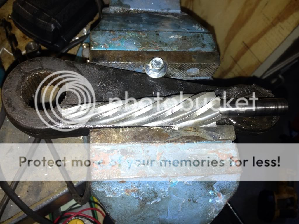

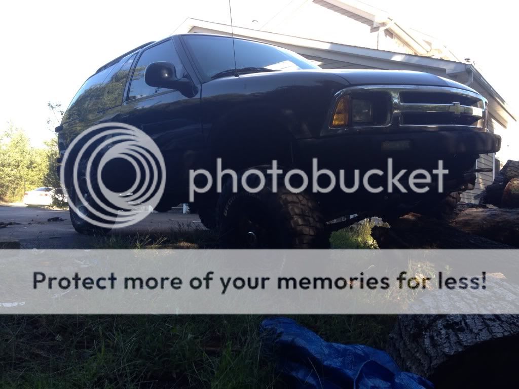

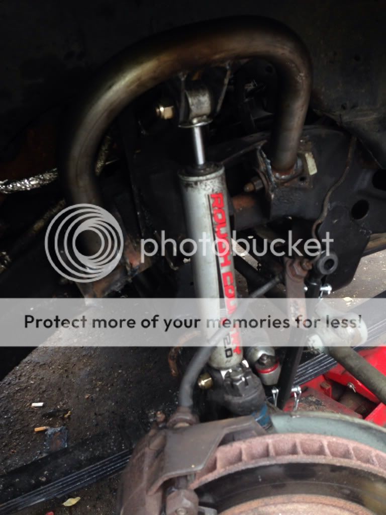

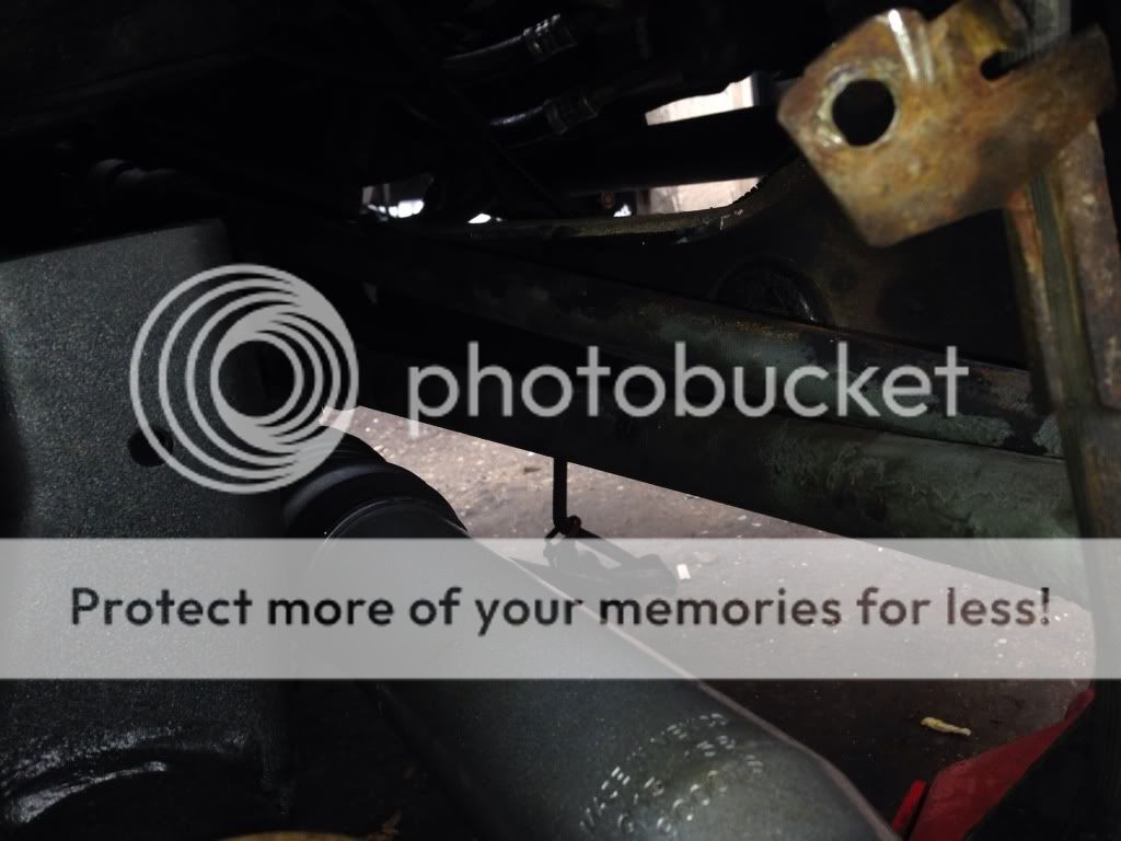

so I got some pics .... don't know if I covered it but I am going to get different shock hoops ones that are larger as in taller I have barley an any up travel space left on my shocks ... have to figure out track bar but truck drives straight just has alittle bit of bump steer
heres a picture of the reamer I used for the pitman arm
I think I want to cut of front cross member and flip pitman arm around opinions
oil pan clearance its close but no way it will ever hit

Looks pretty tight under there... Cutting the cross member out / running an astro box will definitely free up some room.
Id also think about getting some bump stops fabbed up just incase.
Edit: check out the Ford F250 shock towers PN E5TZ-18183-A. I swapped my ORD hoops for them to get a better angle.

there no clearance issues with the axle coming up and hitting something but I am concern about adding the track bar might

Hey km any way you can post a pic of them on your rig

I don't have a pic of mine, but here's one from Buzzers rig over on s10forum that i found.

I used trail gear shock hoops, they were a simple weld in with NO modifications.
It looks really tight for steering clearance. Astro box and remove the crossmember, or move the axle rearward.
