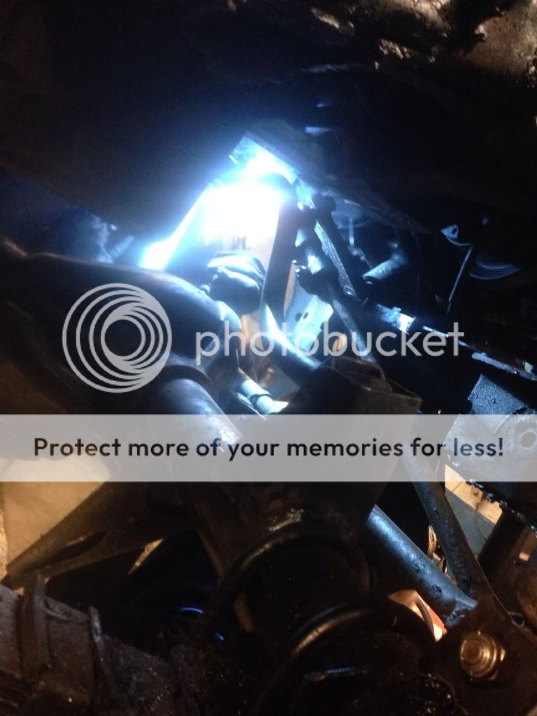

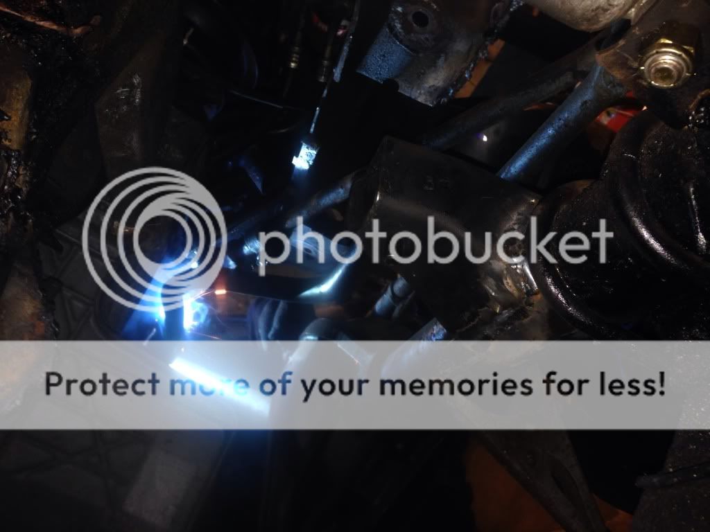

the axle used a track bar on the wagoneer originally .... but I installed it today
we had to relocate the axle side track back mount and we had to heat up the bar and twist it .... some thick *** metal was hard to twist
I saw the trailgear hoop but bought this one yesterday
All Pro Off Road Universal Shock Hoops | eBay
its 1 inch wider and .5 shorter
so with the track bar in its like a whole different world no bump steer at all
km if you thought it was tight before you should see how tight it is with a track bar now

So the track bat ended up rubbing on oil pan so we heated it up and bent it down more

So the track bat ended up rubbing on oil pan so we heated it up and bent it down more still handles the same and no rub now
