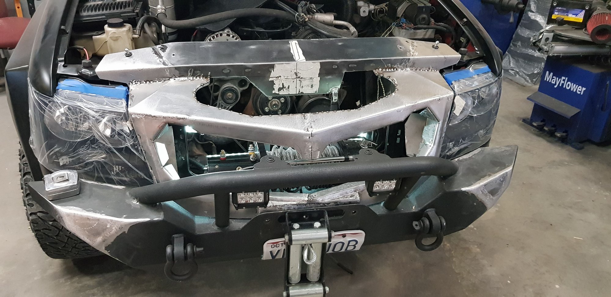

Did you notice the angle of the grill matched that of a 2017 Camaro? I have the Chevy bowtie that will be placed upper middle.

roughed out the front opening in the grill.
