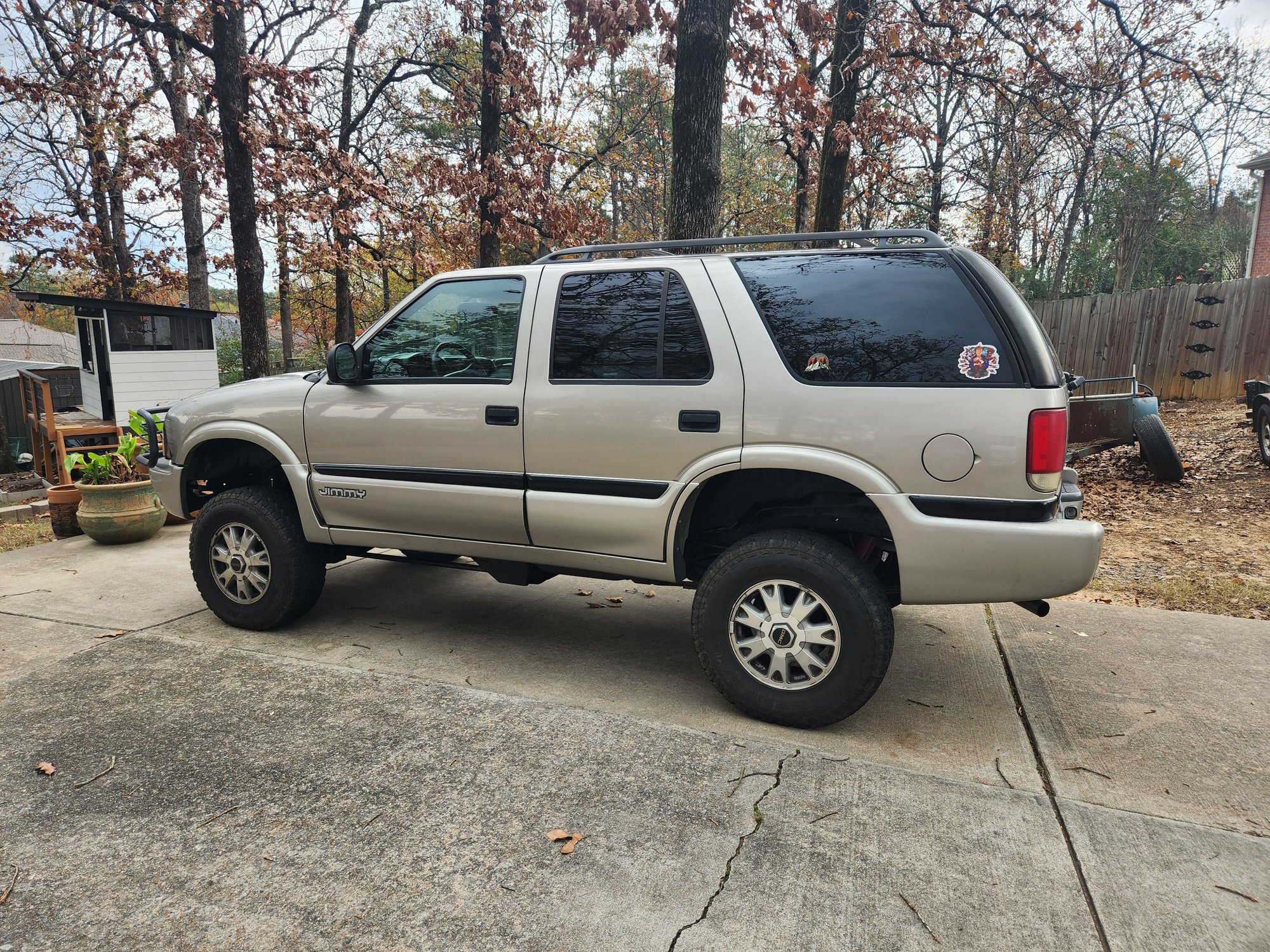

Back on the road.
It is back on the road, and we are working through the little odds and ends that pop up. I'm still planning on replacing the cat and muffler. We also have the iroc wheels, factory nerf bars from a diamond edition, and rear spare tire carrier that all need to be mounted. It's turning out to be a pretty clean little rig, and it feels good to see it back on the road and being enjoyed.

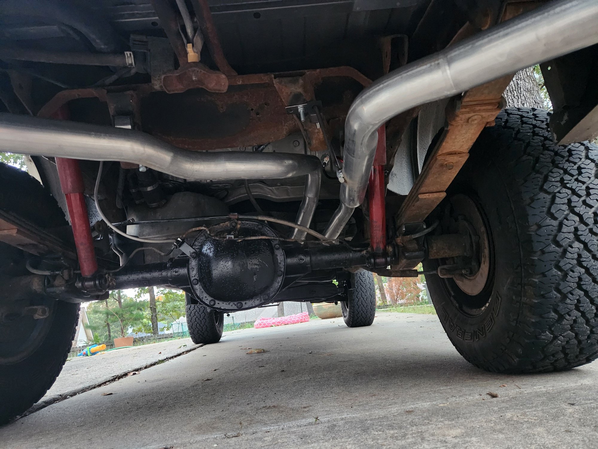

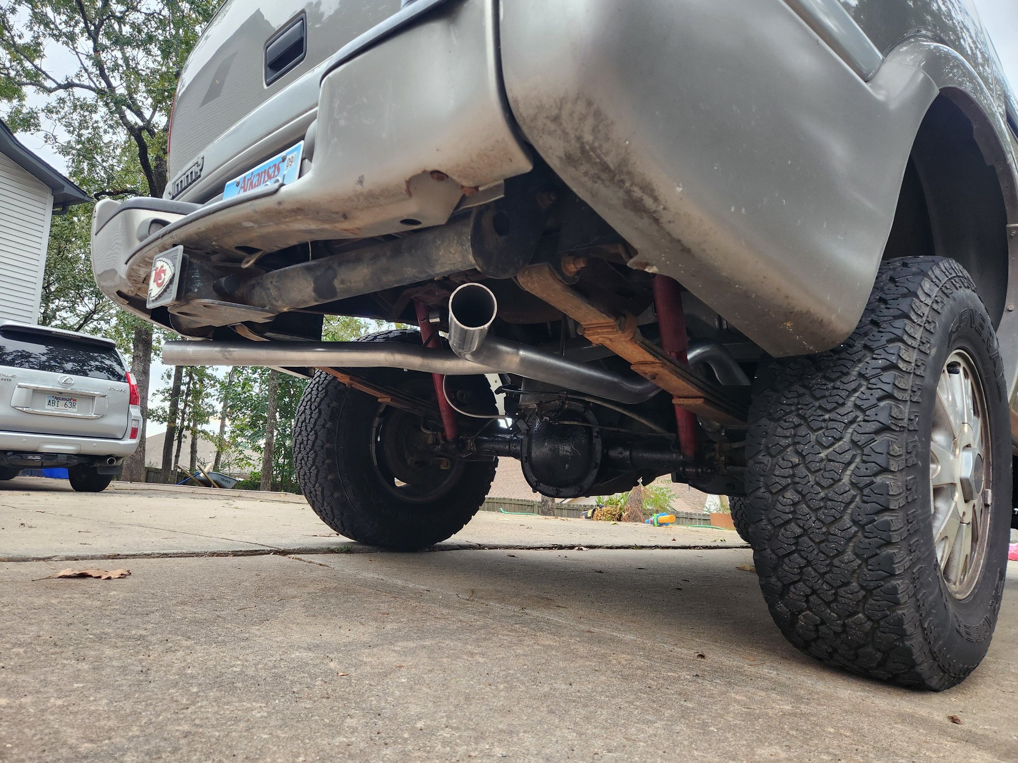

Thanks for the kind words. We got it in to the muffler shop. I don't mind doing most things, but I let the shop do the exhaust. They put a permanent bend under the lowered front drive shaft, replaced the cat with a high flow factory replacement, replaced the muffler with a flowmaster 40 with dual outs, then added two pipes out the back corners. The gas tank breather box on the drivers side makes it a tight fit, so we removed the spare ran the pipes inside of the rear leafs. We're putting on the spare tire carrier anyways. The old cat was empty, and the old muffler was full of all kinds of crap. It sounds great and runs smooth. Now he's looking for some tips for it.
New cat, flowmaster 40, and dual outs

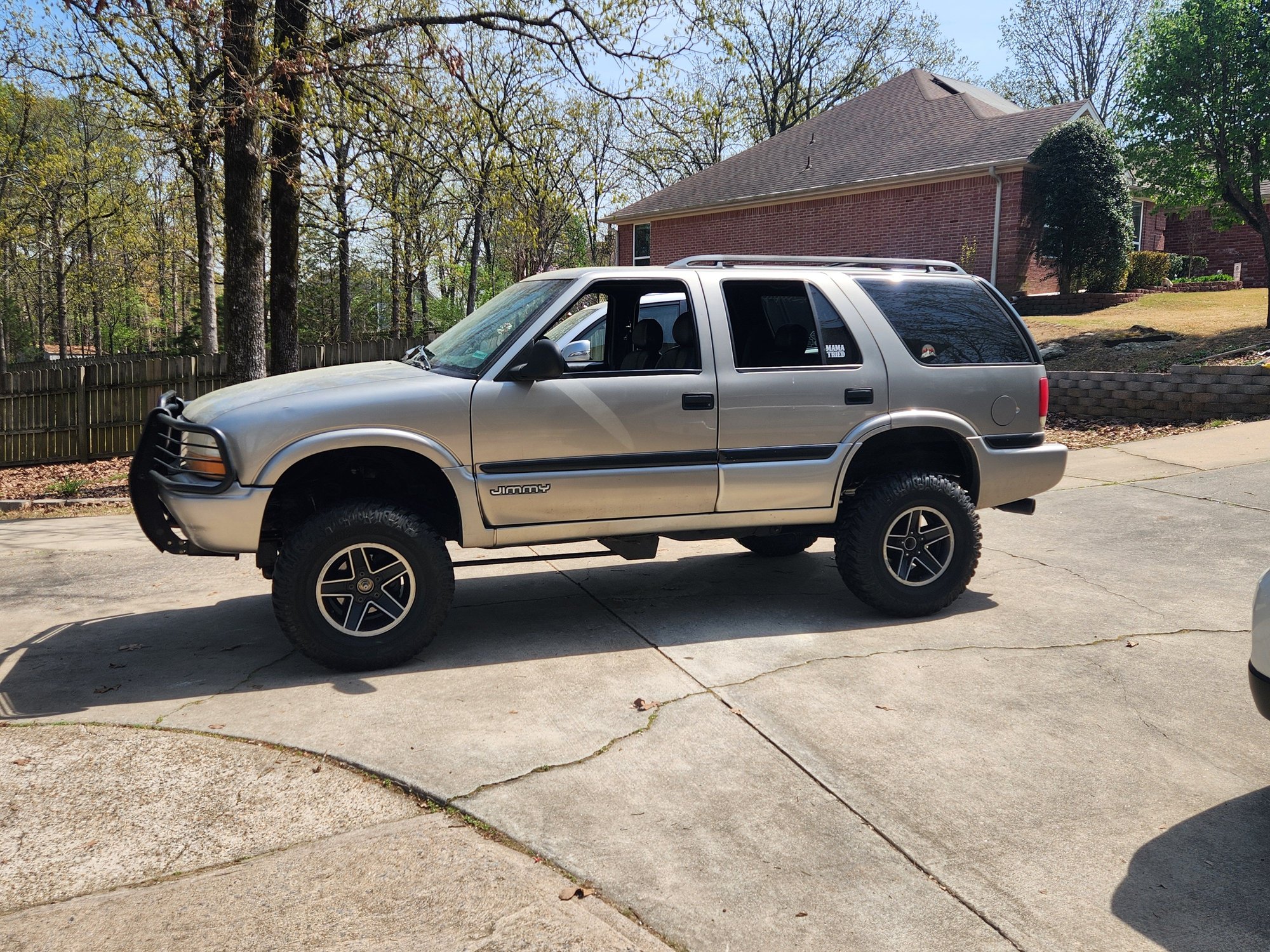

My son is continuing to make progress.
blacked out side trim
Set of 31s mounted up to the z-28 rims
Wheels and tires all painted and mounted.
Still several things to get done, but it's definitely getting there.
