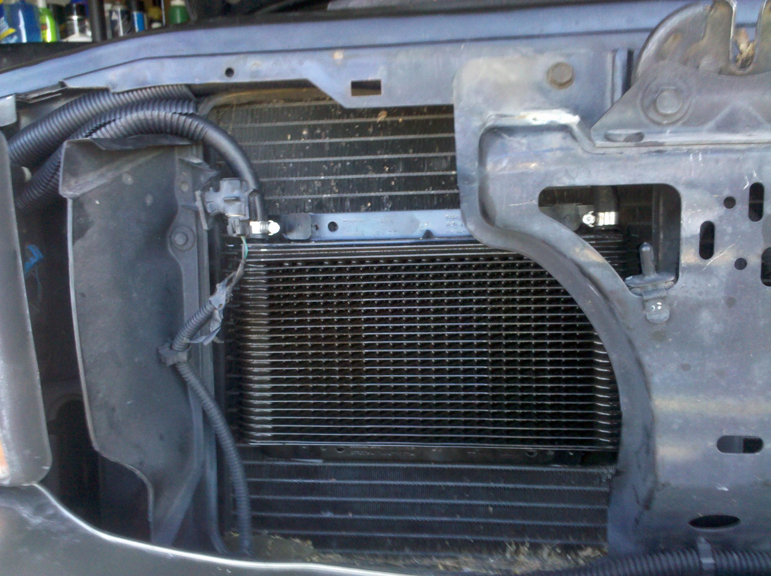

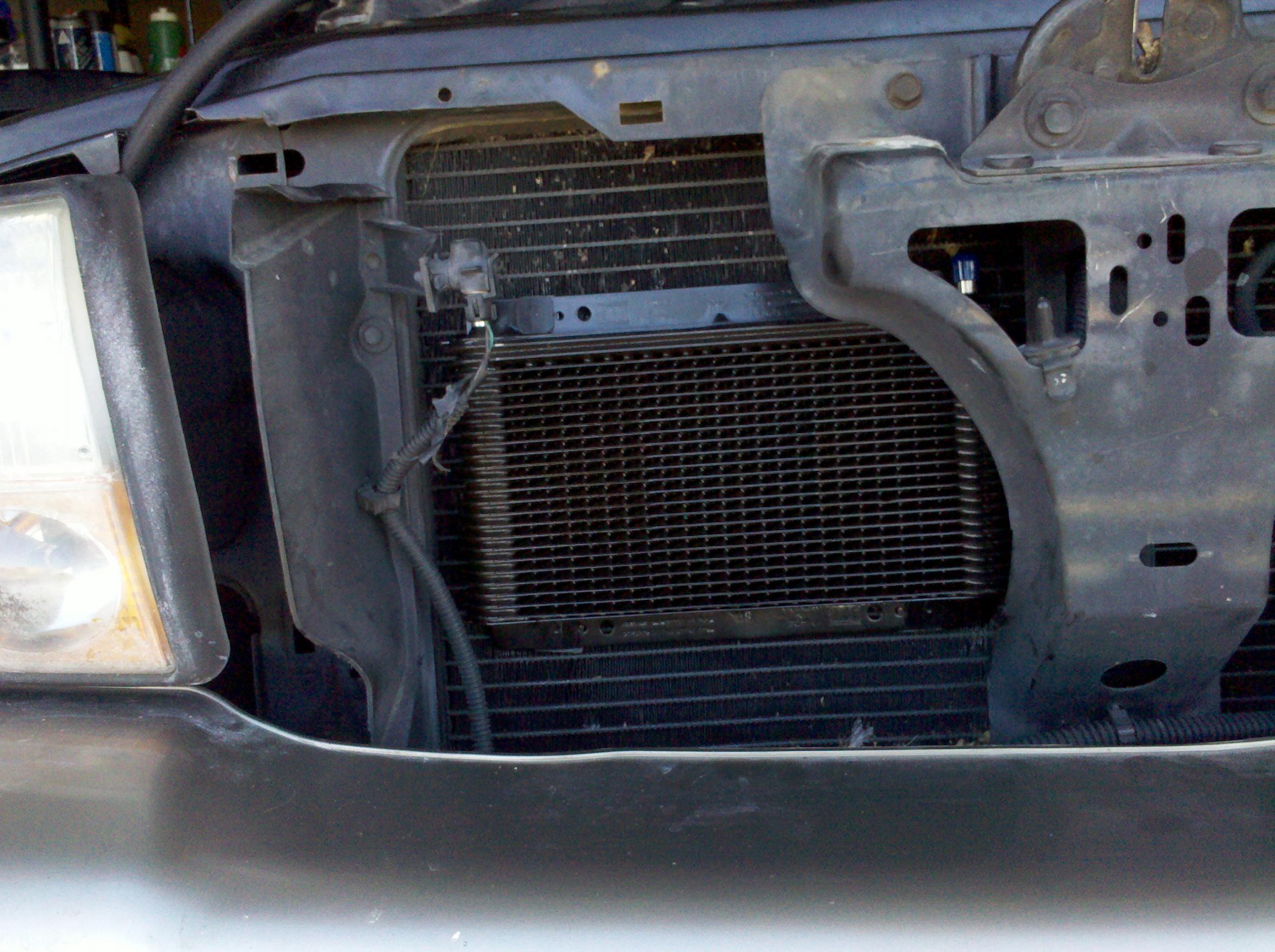

But onto the good stuff- the truck is in the garage on jackstands with one CV axle out. I dropped the trans pan and threw a new filter in it last night. The transmission cooler came in from Summit last night. It doesn't specify under the part description but it does come with hardware so don't add the extra mounting hardware and hose. I picked up another few feet of 3/8" fuel line at Autozone for the return line. Both feed and return lines are routed through the opening behind the passenger side headlight housing. I put looms on them to cut down on friction around the frame and battery.
4WheelParts finally got back to me yesterday and said the bodylift was in and the wheels were supposed to come today but I didn't have time to check. I need to finish up with the CV's and front differential so I can get to the other fun stuff. I also picked up some lower ball joints today since I'm in a good position to change them out with the CV job.
