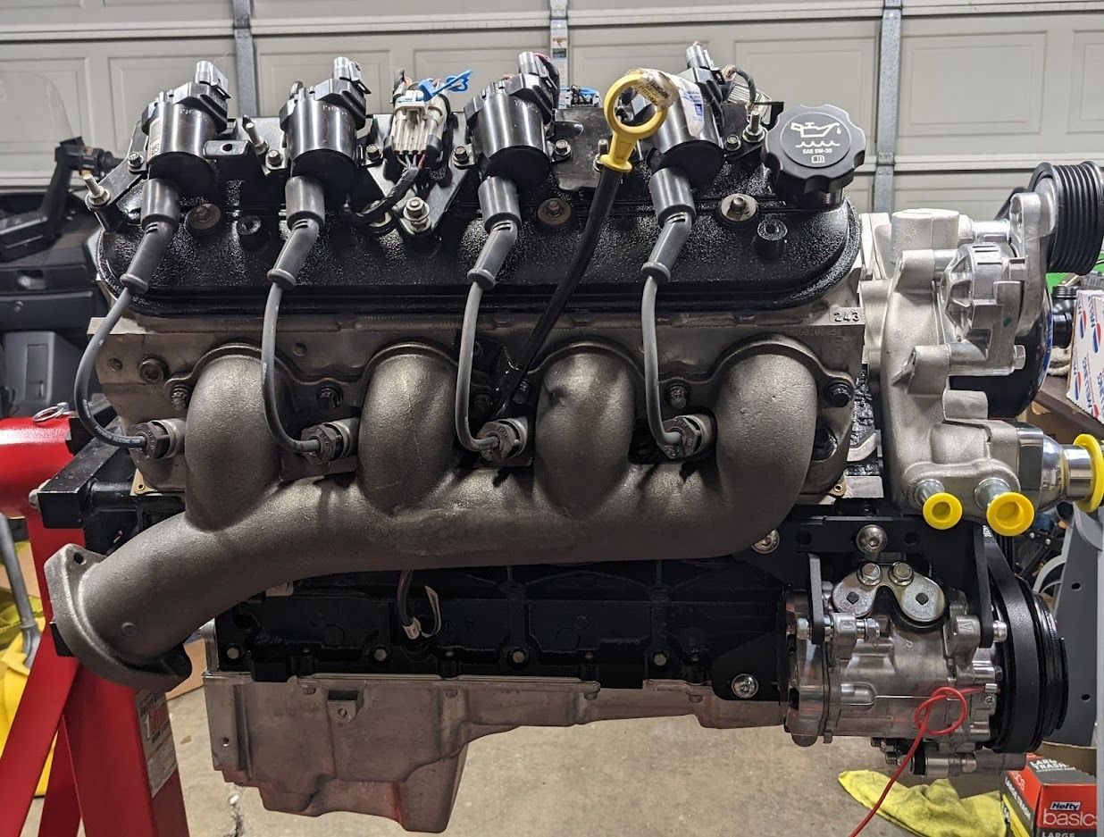

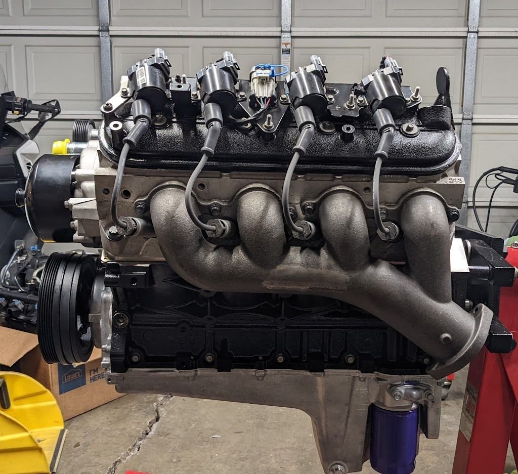

2004 Chevy Blazer Ls 2dr. I am putting a 5.3L (L59) from a 03 GMC Yukon drive by wire with 4L60E . So far have parts on order from current performance and Holly just waiting for them to come in so I can start fitting the 5.3 into the Blazer . With the summit racing Pistons Chevy performance head gaskets and 243 heads Mill down to 62 CC my compression will be 10.6.1 CR. Should work well with the 2004 LS6 Corvette camshaft I'm going to be using.
Parts List:
5.3L L59 from 2003 GMC Yukon SLT.
159K Miles on it when pulled.
New GM Performance Camshaft from 2004 LS6 Corvette P/N 12565308.
Gen 3 243 64cc Heads milled down to 62cc.
Chevrolet Performance Head Gaskets -12575329 Compressed Thickness 0.052 in.
Chevrolet performance valve springs P/N 19420455.
Brian Tooley Racing Rocker Arm Trunnion Upgrade Kit BTRTK001NB.
Gen IV Rods P/N 12607475
ARP 134-3609 Performance Series Cylinder Head Bolt Kit.
ARP 134-6006 Connecting Rod Stud Kit.
Current performance Motor mounts &Blazer 2WD transmission crossmember.
GM 302-1 muscle oil pan
GM PERFORMANCE Dipstick Tube P/N 12570787
GM PERFORMANCE Dipstick P/N 12570788
Holly Blackheart exhaust manifold P/N 7122 30 26 HKR.
Holly Blackhart AC evaporator side cover P/N 71223028HKR.
2005 4L60e with TransGo shift kit. HD-GM92 TMBX torque converter
LS1 Camaro / GTO water pump with LS1 Camaro / GTO harmonic balancer. With modified alternator / power steering bracket to line up with GTO harmonic balancer and water pump.
Melling M295HV High Volume Oil Pump with 60 PSI spring.
Melling BD417-DBRKT - Melling Timing Chain Dampener Bracket
Dirty Dingo DD-LS-AC-LM-CMV lower passenger side mount A/C bracket kit with Sanden SD7B10 mini compressor.
Quantum-340lph-direct-drop-in-performance-fuel-pump-assembly for 2dr 2wd Blazer P/N QFS-A822HV.
AEM (30-4110) UEGO Air/Fuel Ratio Gauge
Summit Racing SUM-326943780-2F Forged Pistons + 2cc dome Bore 3.780.
My compression will be 10.6.1 CR.
New vortec cover and retainer for the truck intake since the one from the Yukon was missing.
Suspension
Front
Belltech spindles P/N.2102 and 2/3-in drop springs P/N.23228.
Rear
Belltech 3-in drop leaf springs P/N.5964. with 1-in lowering block with2 Degree Taper P/N 6002.
Sitting on 20x8.5 Vision-Torque with 235/35/R20 tires.

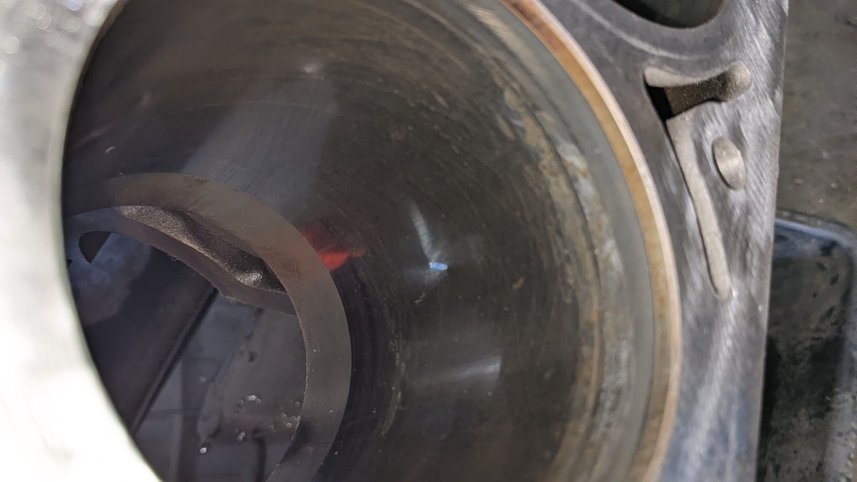

Okay I got the 5.3 all the way down to Bear block. Tomorrow I will run the ball hone through it. since I'm going to have it hot tanked I have them cleans up my mess from that. If anybody's interested in the third gen press fit rods and pistons I removing from this 5.3. PM me and we can make a deal. they are an excellent shape they only have 159k on them. I already sold the 862 heads I pulled off to my machine shop.
Old Mar 13, 2022 | 03:31 PM
Life is a Enigma's Avatar
Joined: Feb 2022
Posts: 45
From: Nor Cal
Life is a Enigma is on a distinguished road
Before
After 320g ball hone.
Old Mar 13, 2022 | 10:28 PM
Nice! Looking nice and flush!
