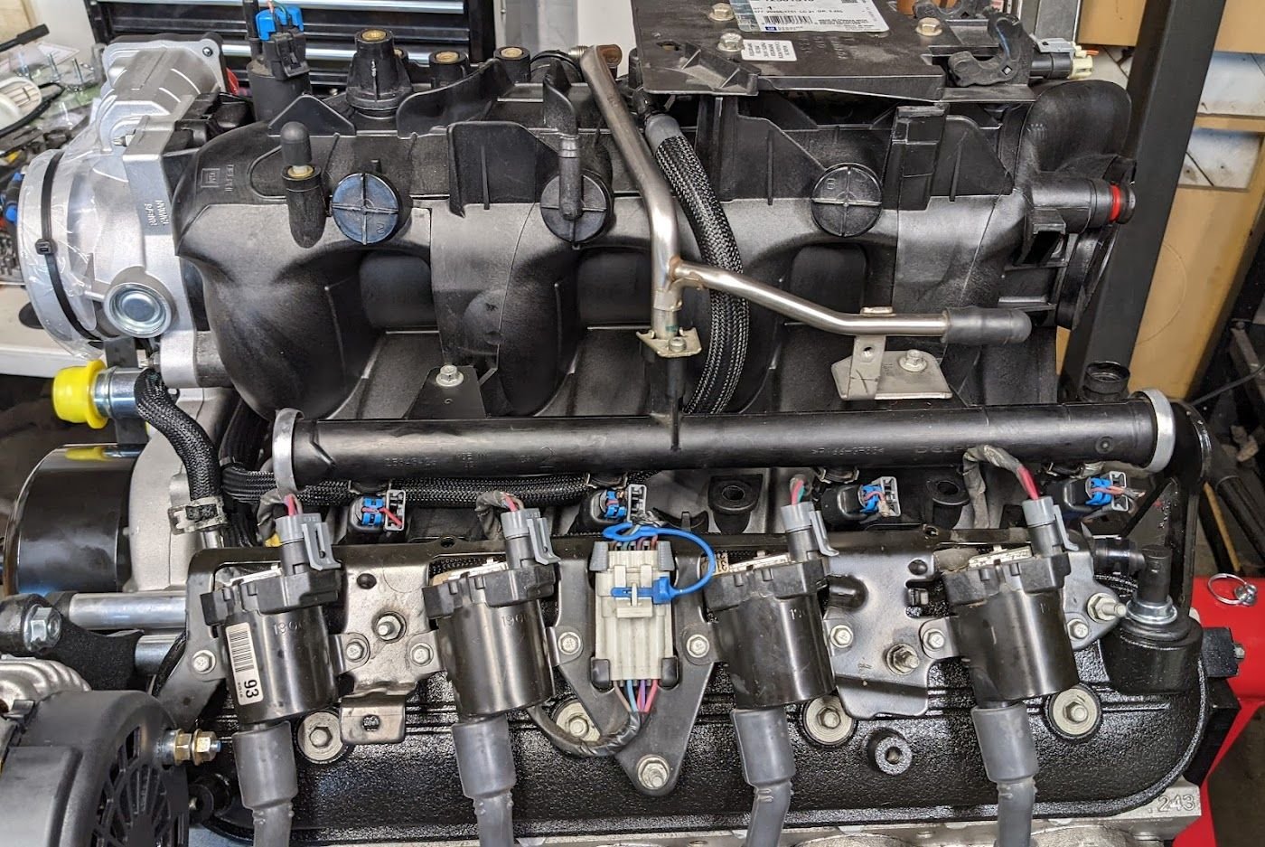

Getting There.

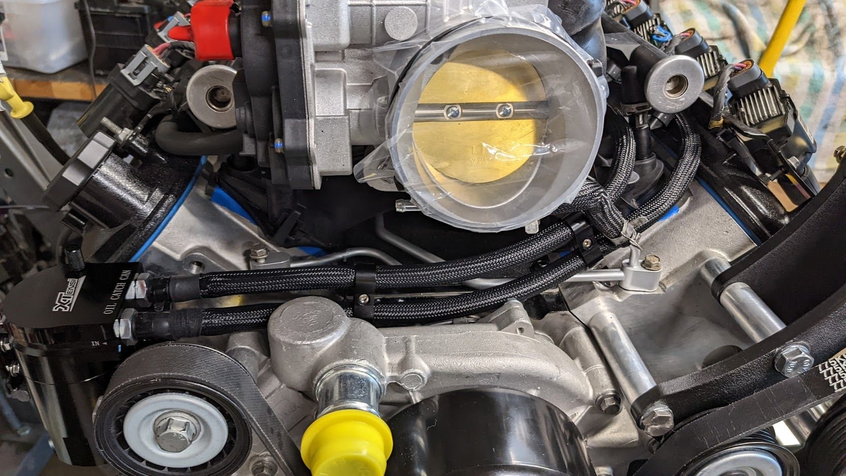

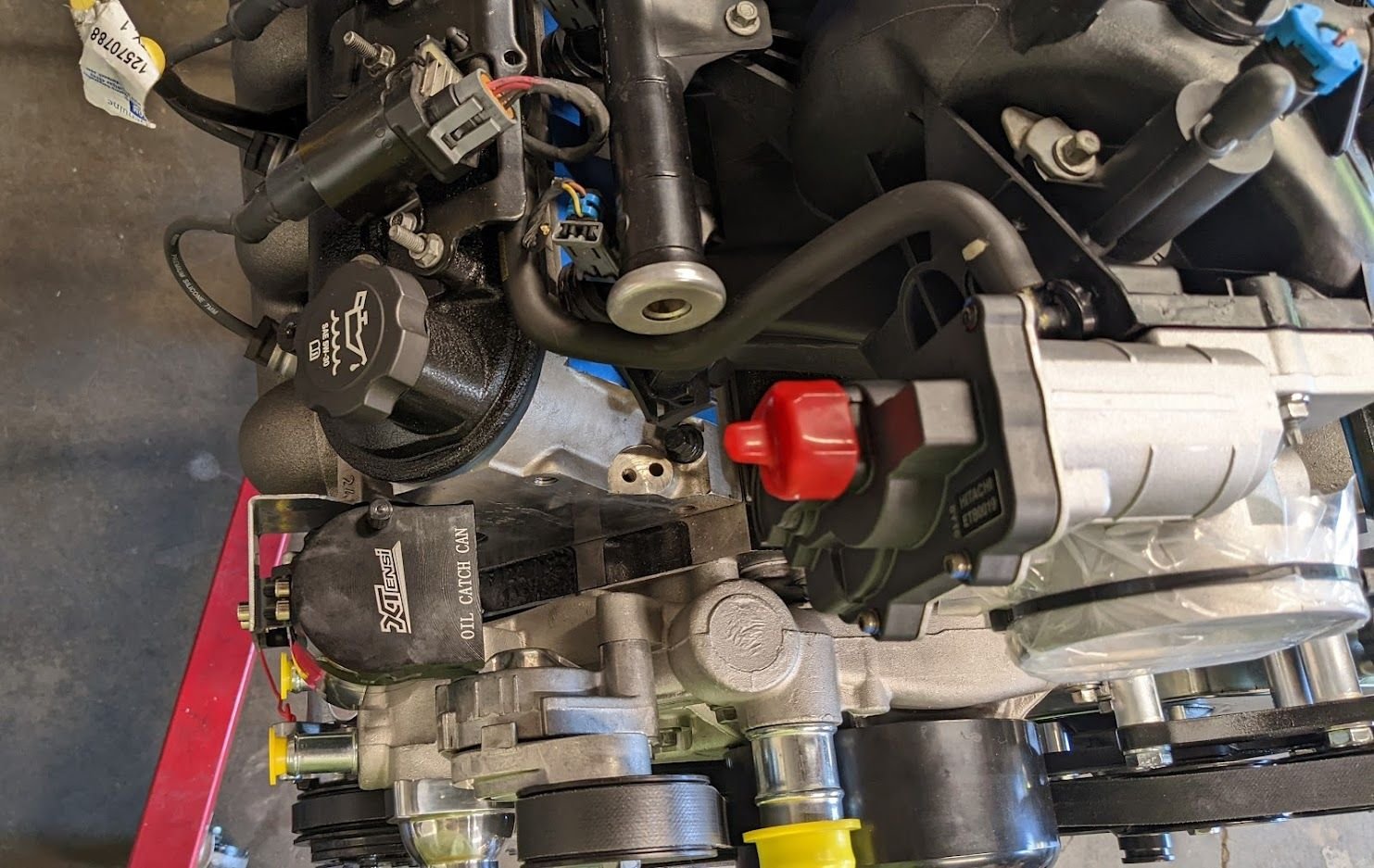

Started to mount my oil catch can and I cleaned and painted the steam Port tube.

Life is a Enigma is on a distinguished road
The oil catch can is ready to go.

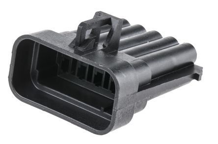

GM drive by wire TAC module cruise control wiring.
I found the male plug that will plug into the factory cruise control female plug on the firewall if you do not want to cut your harness.
This male automotive connector will plug in to your factory cruise control connector.
Cruise control male plug
Part Numbers
10 Position Automotive Connector P/N 12045808 Qty-1 $1.38 Each
Terminal Position Assurance Automotive Connector P/N 12124264 Qty-1 $0.29 Each
Terminals Automotive Connector P/N 12045773-L Qty-6 $0.29 Each
Cavity Plug Automotive Connector P/N 12059168 Qty-6 $0.12 Each
Wire Seal Automotive Connector P/N 15324973 Qty-6 $0.10 Each
And you can get all of them here > https://www.mouser.com/

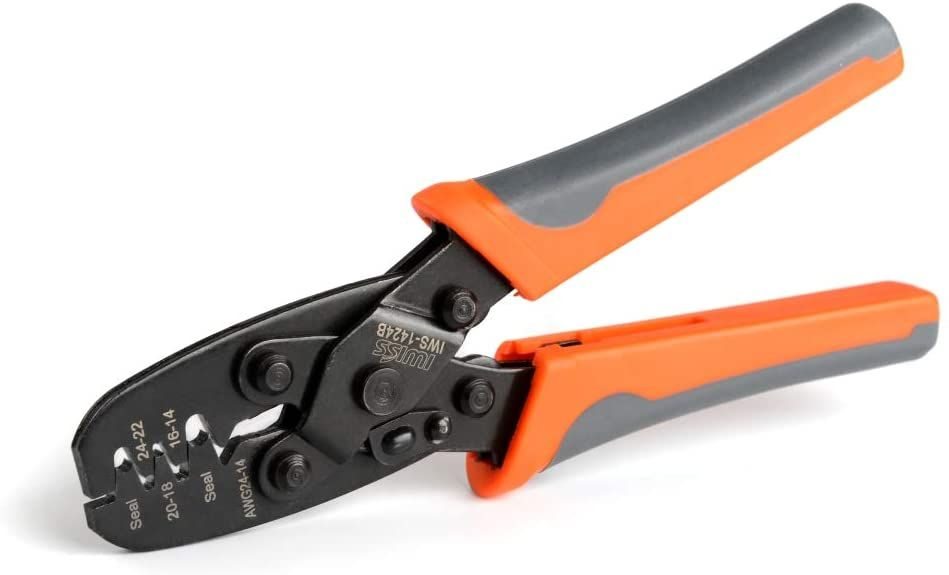

Tool Needed for Terminals. Weather Pack Crimper Tools for Delphi.
https://www.amazon.com/gp/product/B071KFLY43/ref=ppx_yo_dt_b_search_asin_title?ie=UTF8&th=1 https://www.amazon.com/gp/product/B071KFLY43/ref=ppx_yo_dt_b_search_asin_title?ie=UTF8&th=1

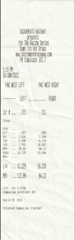

Old Jun 30, 2022 | 01:21 AM
  #39
Life is a Enigma's Avatar
Joined: Feb 2022
Posts: 45
From: Nor Cal
Went to Sacramento raceway with my 04 Blazer 2dr 2wd Weighs 3700. Only mods is K&N intake and running on E20 fuel and mild tuning with HP tuners timing only.
Best time
16.220 @ 84.22mph
Average time
Roughly 16.5
Worst time
16.819@80mph
Now I have my before times before I do my 5.3L swap
When you go to the raceway to have fun when you pull up to the lights look over to your left then you ask God what did I do to you today to deserve this to have my backside handed to me by a Tesla.

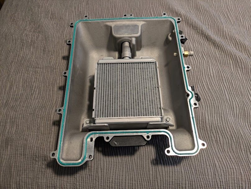

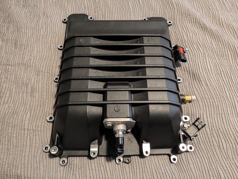

Old Aug 16, 2024 | 12:38 PM
  #40
Joined: Feb 2022
Posts: 45
From: Nor Cal

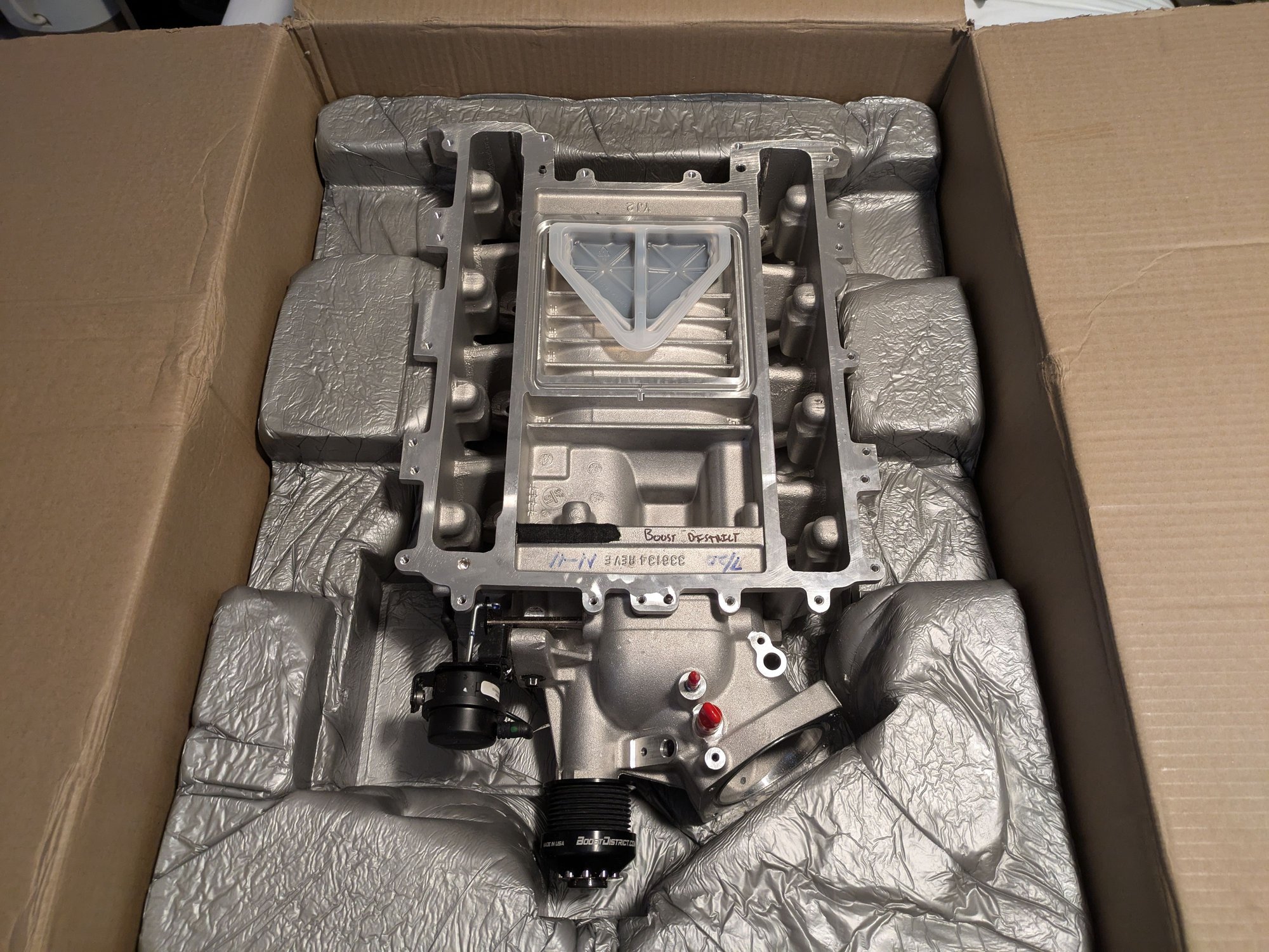

Update on my blazer build I decided to change direction I had time to think while I was down. I had eight back surgeries two shoulder surgery and one neck surgery in the last year and a half so I had to hit the pot button on my build so I can heal. Here is some pictures of the update of what I'm putting on top of my mild built 5.3 Ls.
