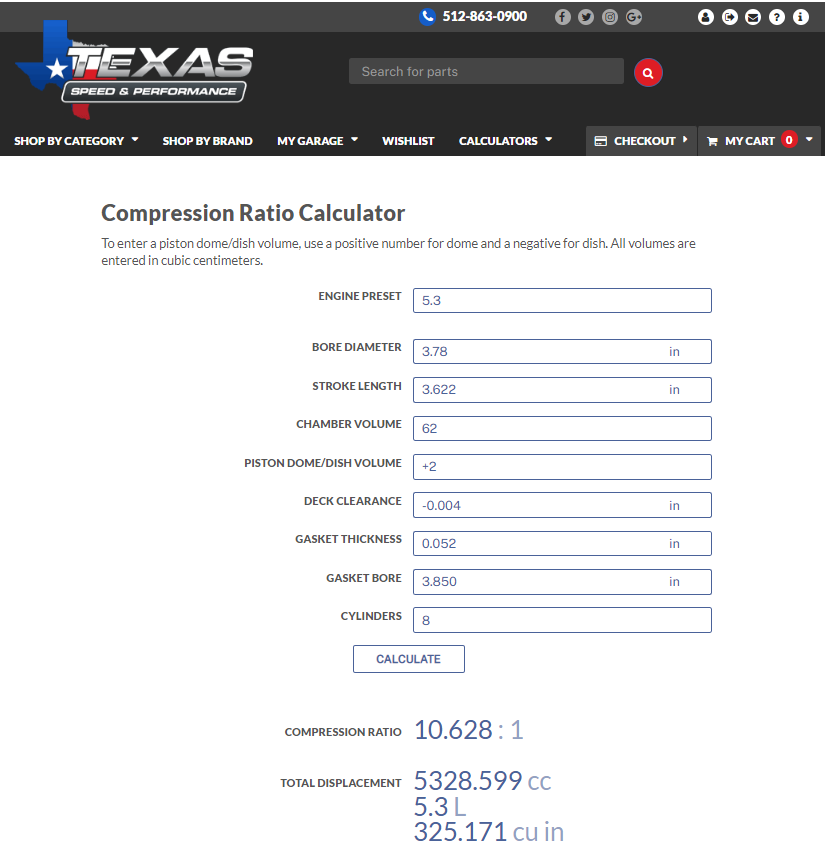

Pistons and rings are gapped for nitrous rods torqued with ARP bolts. I checked the Piston to deck clearance it changed my compression ratio to 10.6.1 I was shooting for 10.5.1 but I guess it's better to have a little over than under. Oil pumps in pickup is installed with ict billet hold down where it has two bolts.
