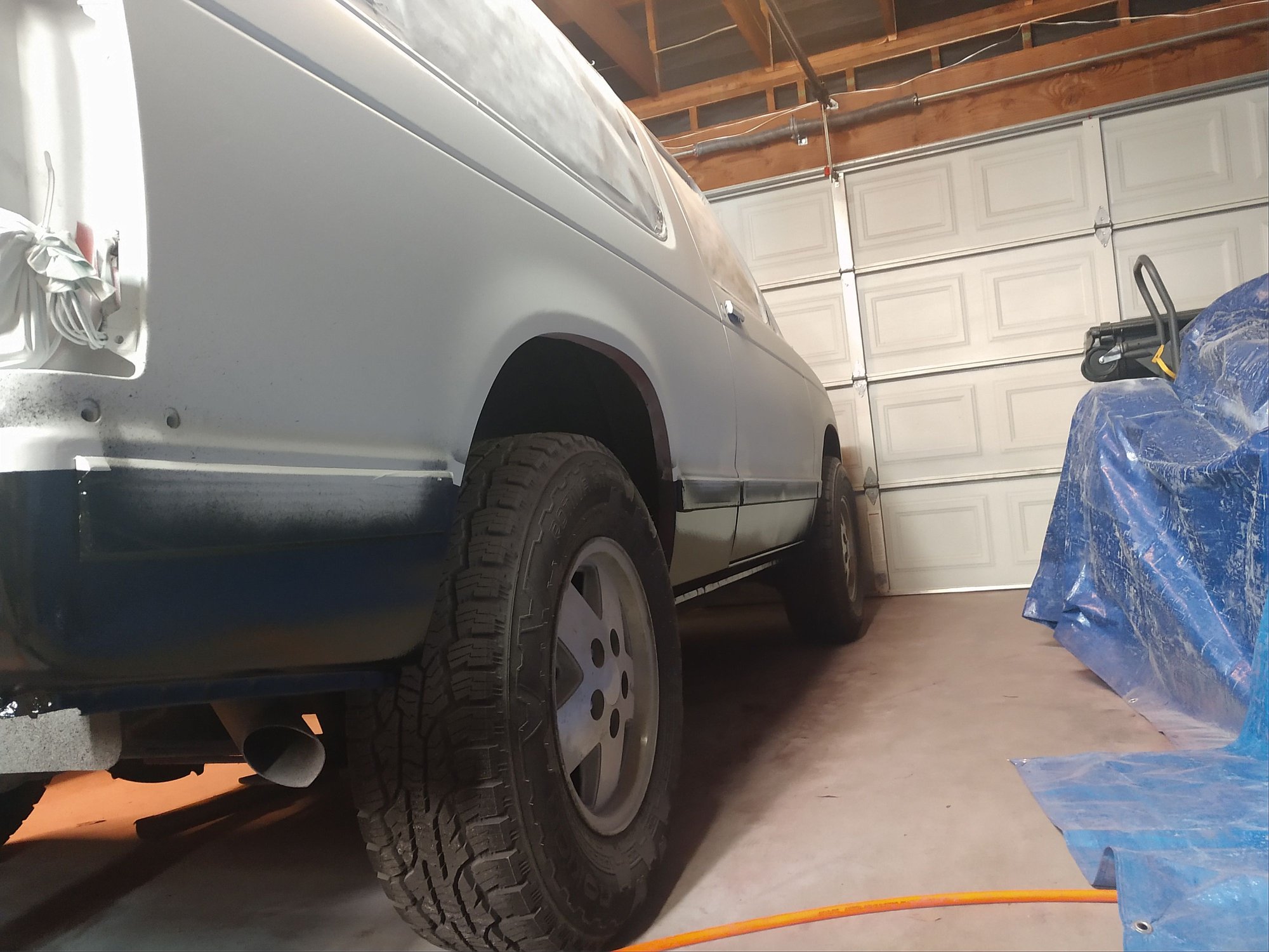

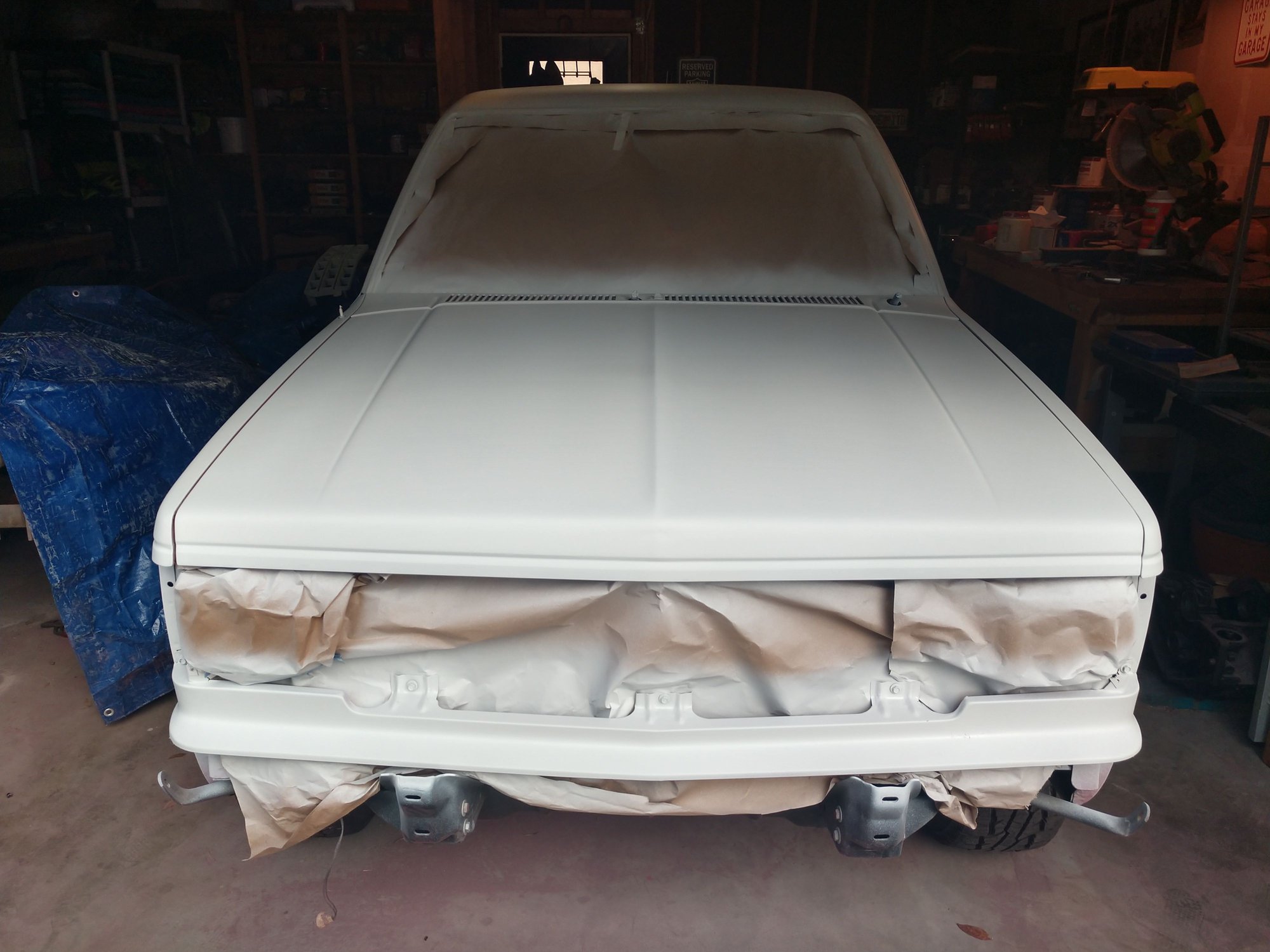

Well engine is still out, so decided there was some surface rust that needed to be taken care of this is current state, body base been completely sanded down and sprayed with primer, doing it two tone the bottom tone is done all that's left is the top Wich will be red
