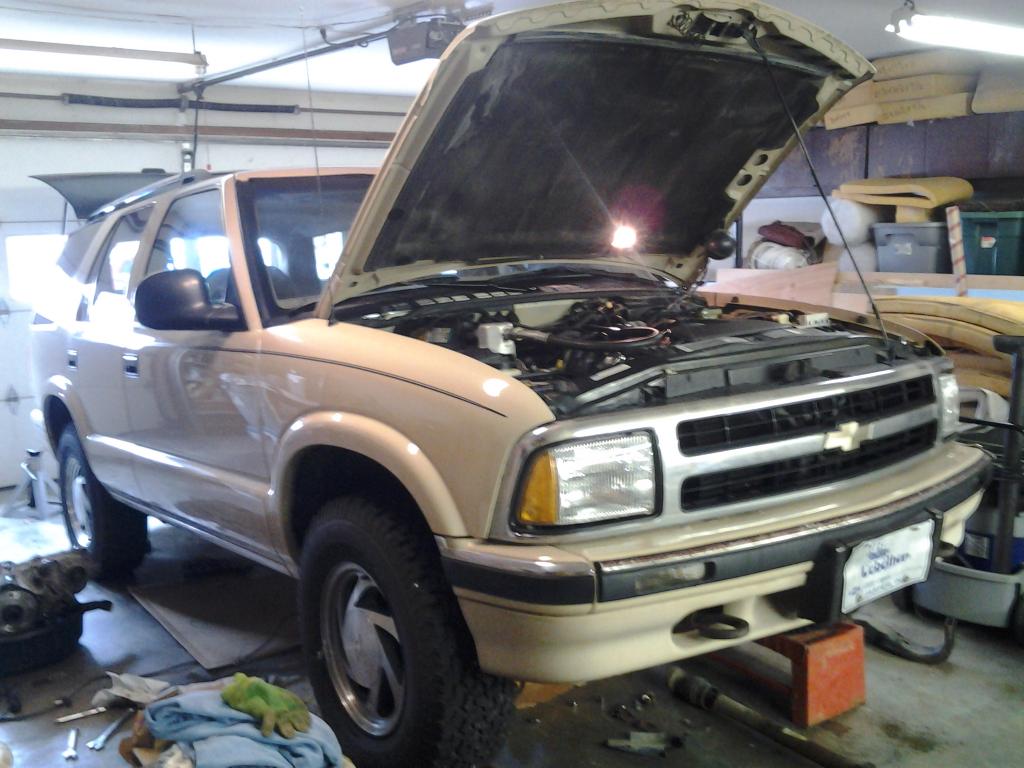

Put a hundred miles on the blazer today running back and forth to a somewhat local rifle range... no leaks thus far.
I noticed I was having a shift issue before we left for teh day... well apparently I forgot to check the trans fluid... 3.5qts later, it was shifting great and was full. I checked the fluid at the barn when I went to look at it to make sure it was clean and what have you... I never checked its level after I got it running... just didnt think about it. It was almost like someone serviced the trans and topped it off without it running...
Otherwise... where did the tranny fluid go since I'm not seeing any leaks anywhere... Something I'm gonna be keeping an eye on for sure.
Also fixed another issue that popped up... temp was fluctuating like crazy... $5 radiator cap fixed a small leak and got temps back in check...
So far, I'm very happy with the little blazer and I'm certain my wife will be too.

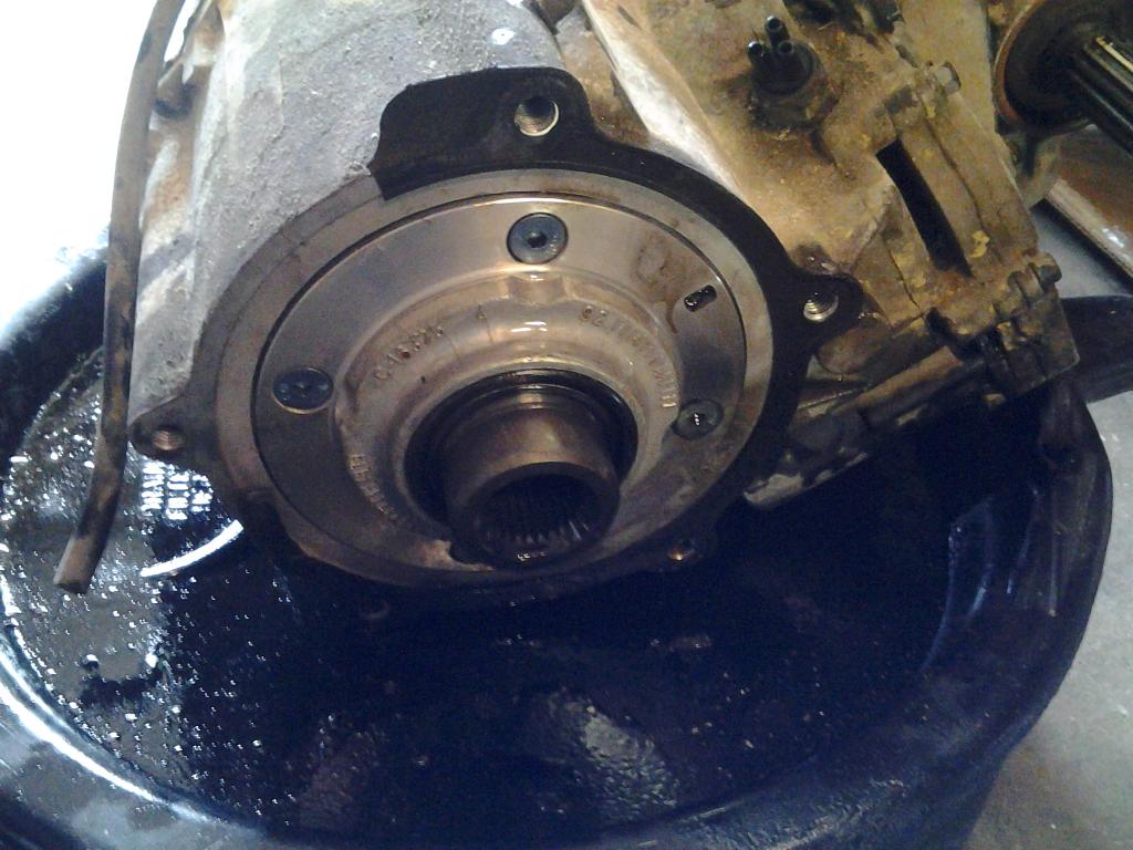

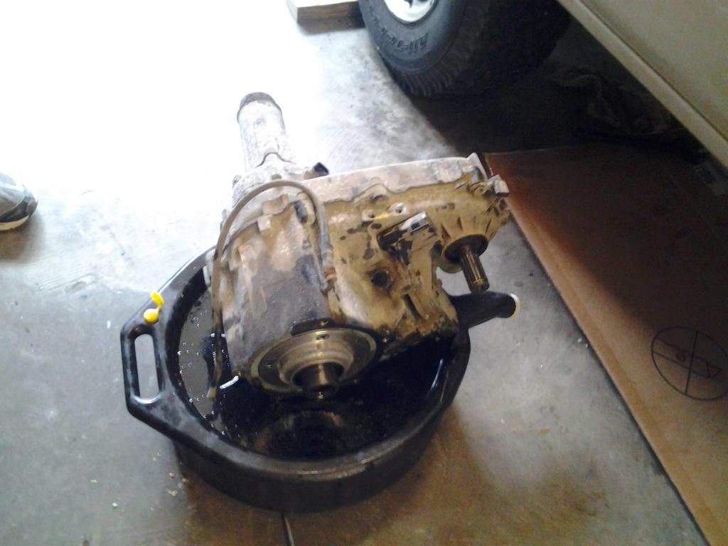

While doing so, I located the missing 3+ qts of transmission fluid... it was in here...
Pulled the transfer case and replaced the input seal along with both output seals and serviced the trans...
