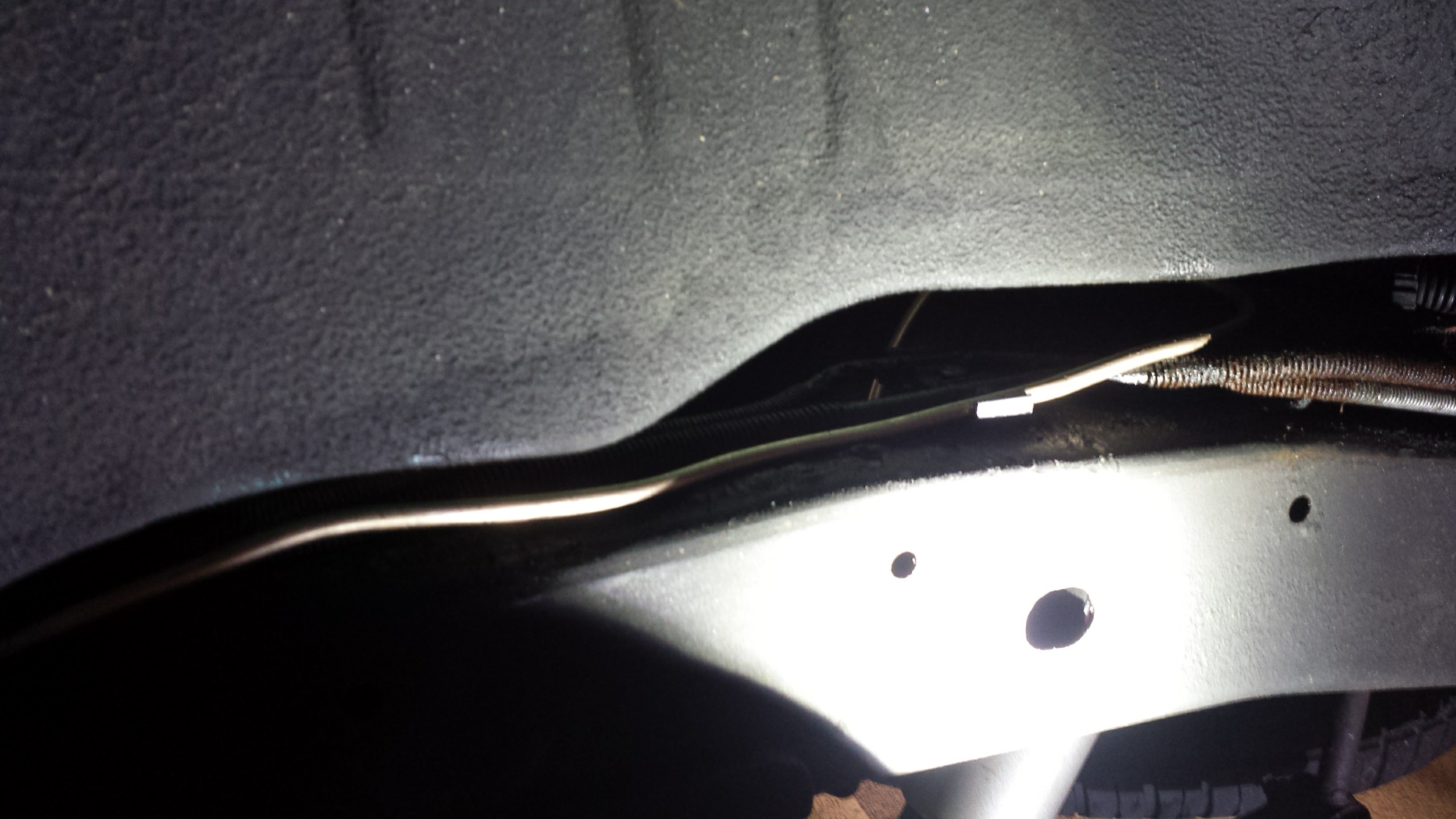

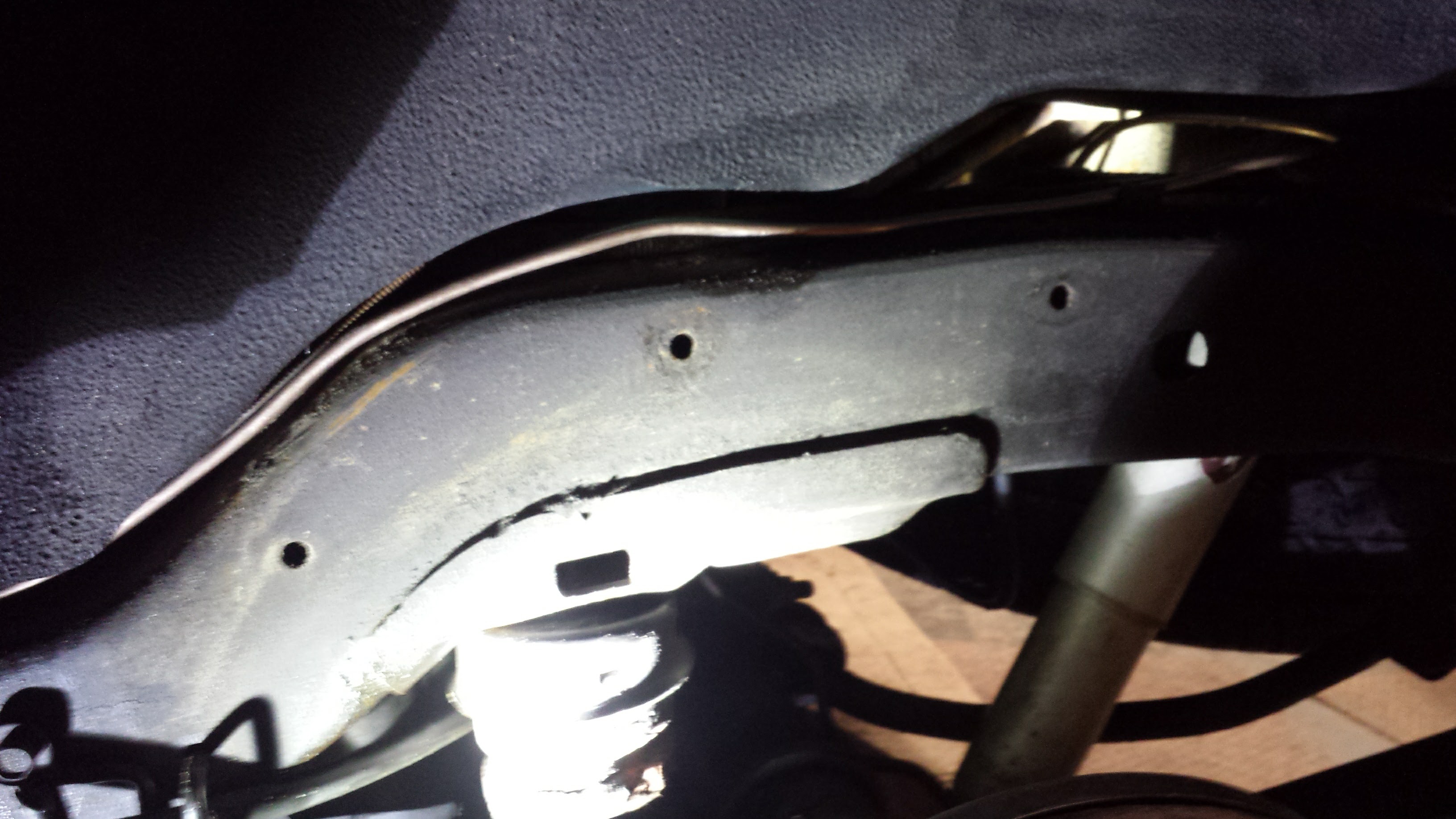

So tuesday i got into the blazer in the parking lot at my school to drive home. Which that day it was also snowing, i started it up and my brake pedal sank halfway down and got mushy. I had a brake light on too. I already knew what had happened. My rear brake line had burst and i now had no pressure to my back brakes.
luckily i am in a special class with a bunch of other car guys and mechanics, so i asked my one friend to get in and press the pedal while i looked at the bottom of the car. Sure enough right at the 90 degree bend at the rear to go into the differential hose i saw fluid dripping and a small puddle on the ground. So i limped it home with only front brakes. immediately pulled it into the garage and immediately started working on it.
I spent probably about 10 hours total doing it right. Which by the way, use lots of WD-40 on everything. Don't want anything to break. I got the old one out and bent a new one out of copper nickel alloy tubing just like the factory one. i was able to fit into every one of the clips except 1. The line runs all along the top of the frame to around the firewall where there is a union. i replaced the front line that goes to the ABs unit since it actually cracked when i tried to loosen it and it was rusty looking.
While i was at it, i replaced the rear differential brake hose. the lines on the actual differential looked fine so i left them. By the way for anyone who needs to do this, the rear brake line is 1/4" unlike the front lines which are 3/16". I tried to loosen the drivers side wheel cylinders's bleeder screw and it just sheared off. i triple checked the ratchet to make sure it was on loosen in fear of this. so i stopped by advanced auto parts on my way home from school the next day and picked up 2 wheel cylinders. If any of you need specifics or have questions, feel free to post them and i will try to answer them while everything is fresh in my mind.
here are the pics:
Where it rusted out(right at the bend there was a pinhole):
What i was greeted by when i got home lol:
Old line out:
New visible part of the line from the wheel well:
It stops great again now and the tubing should never rust. Not the way i wanted to replace it but eh, what are you going to do right?
