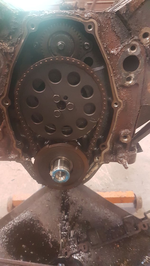

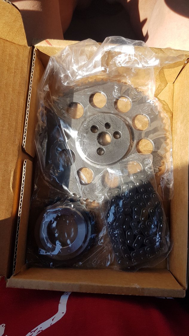

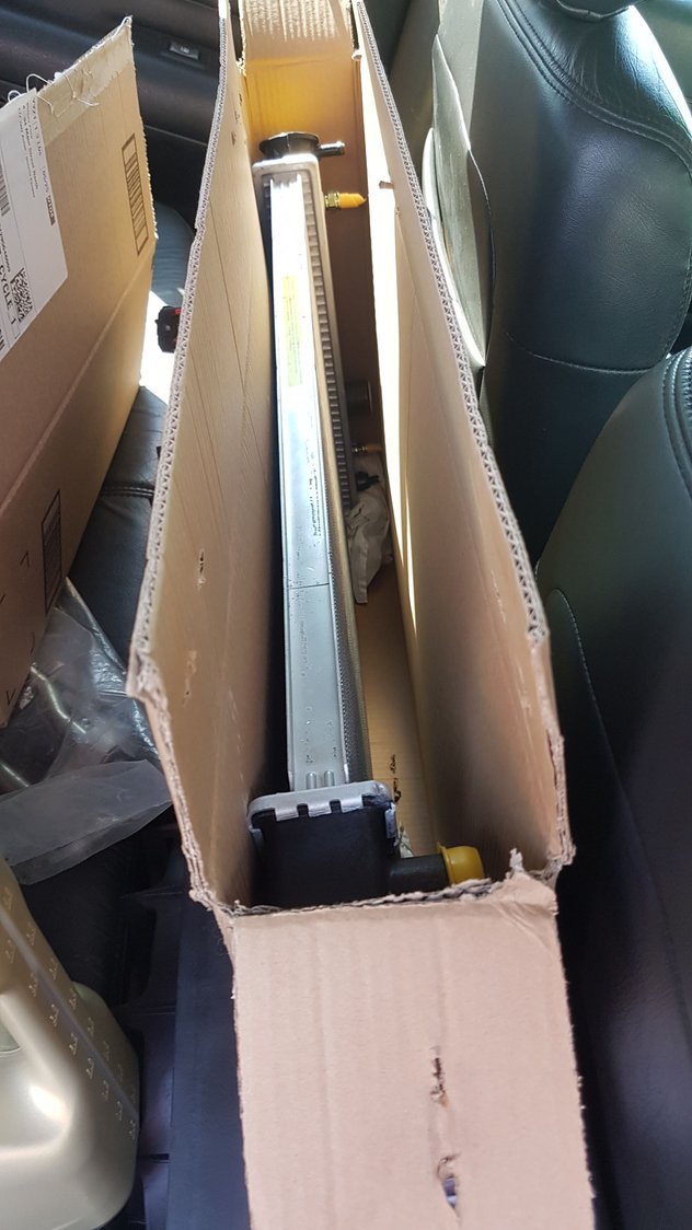

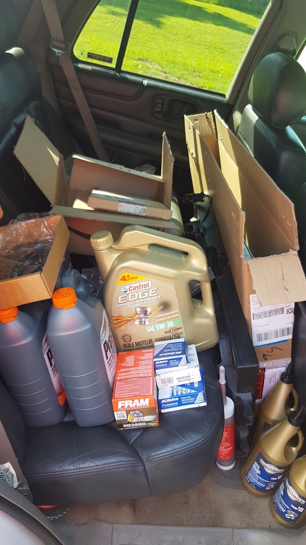

Default The parts going in that's new
New timing gears and chain
New rad and fittings
New gaskets (less head gaskets)
Cooler lines
New fluids, filter and ujoints

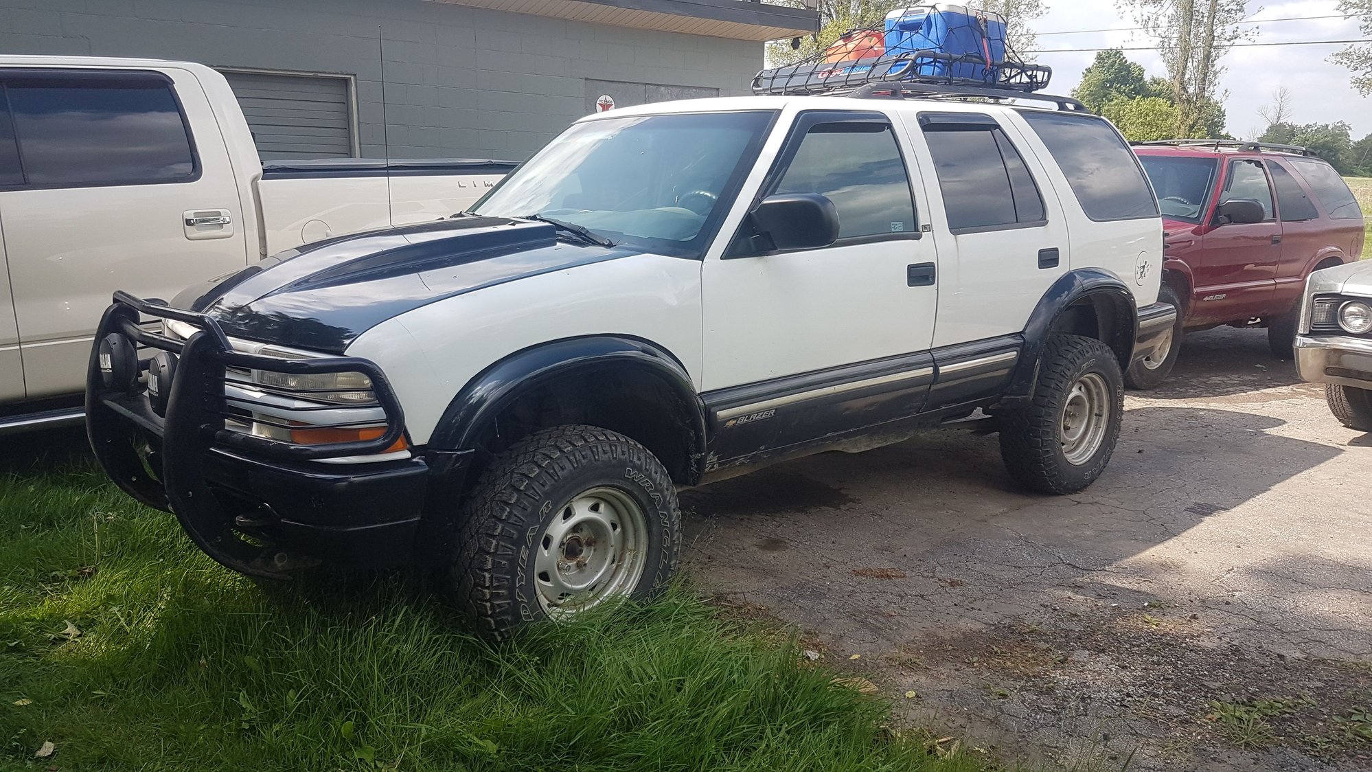

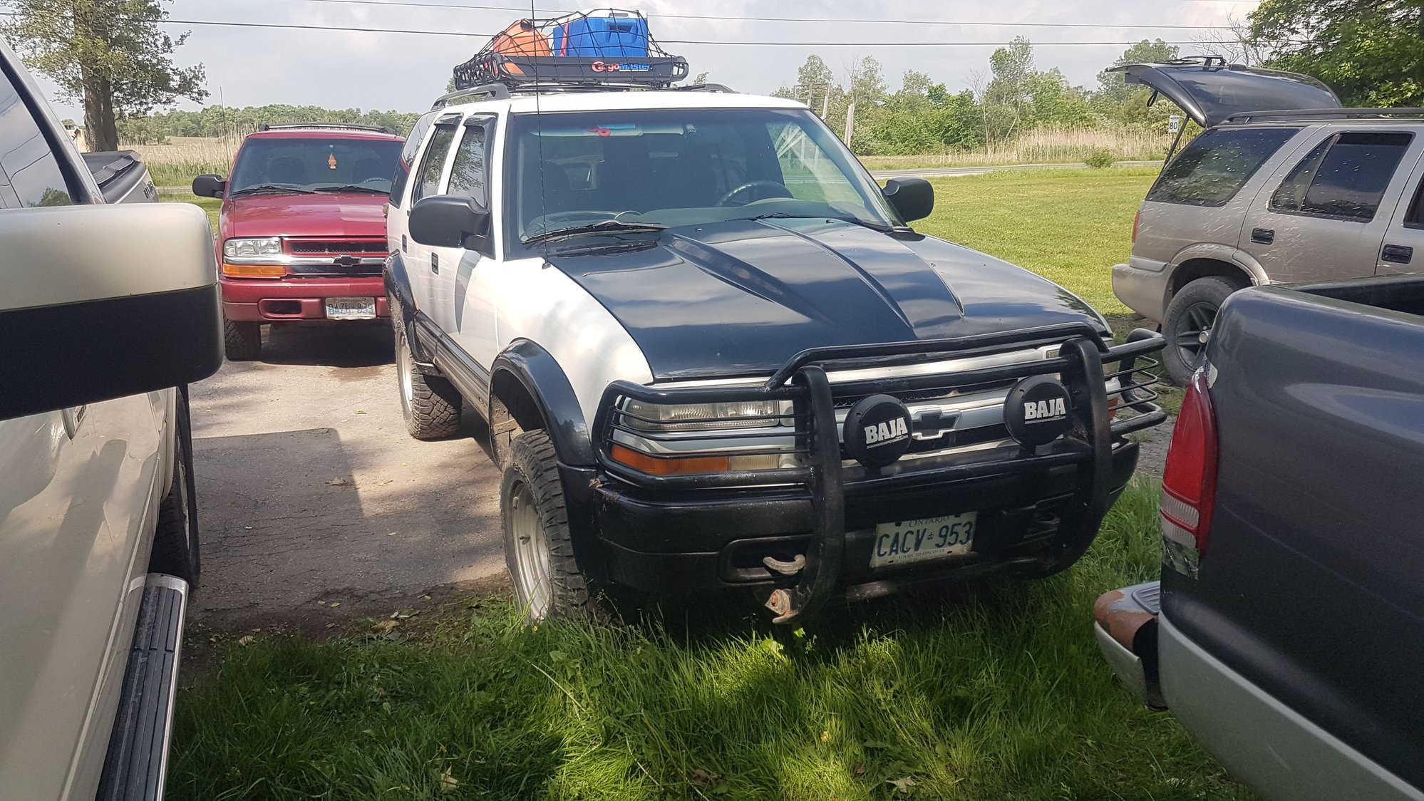

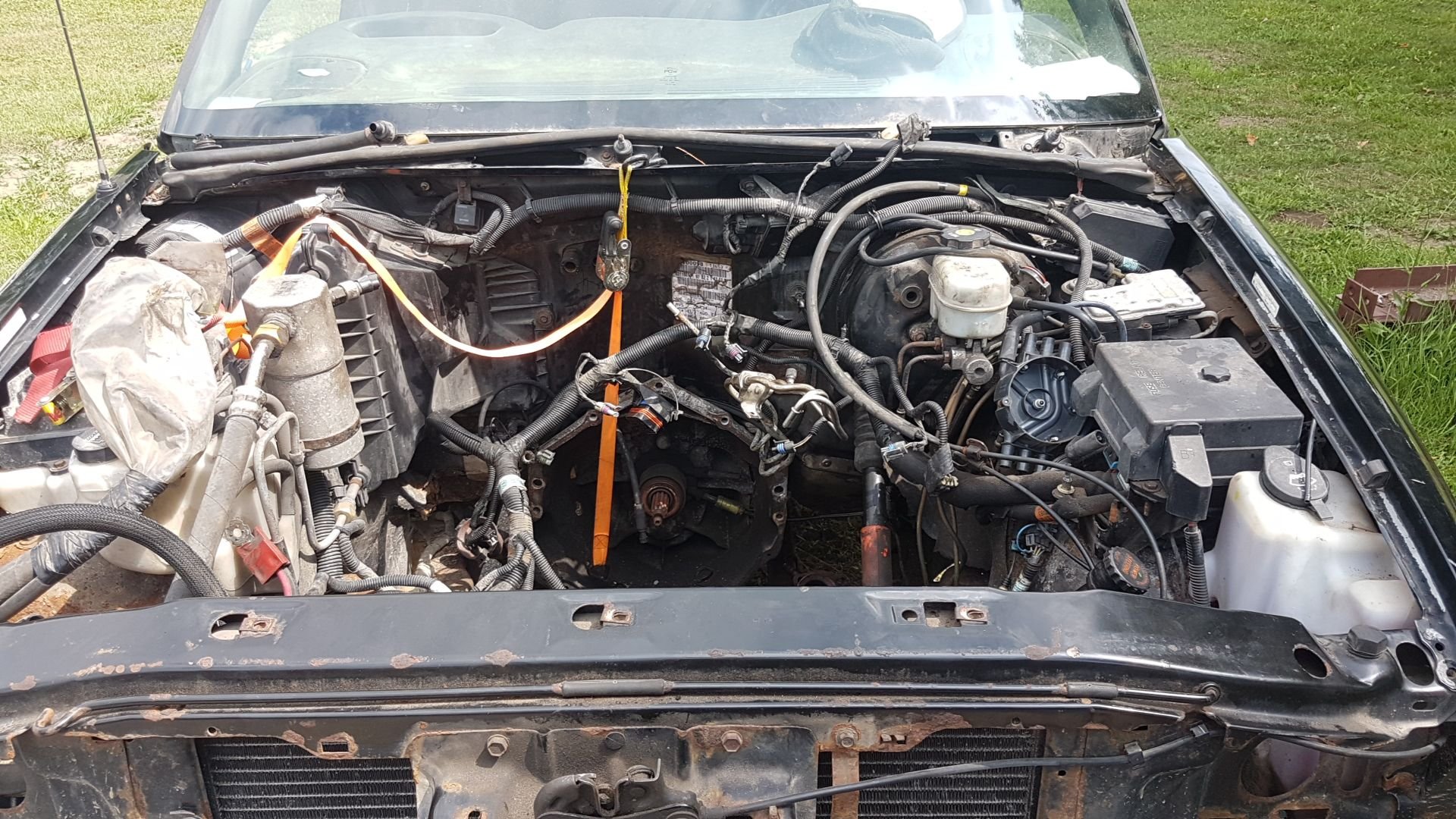

Oh and the neer so new 2000 intrepid dual fans in the last pic lol...
got the hood swapped over in preparation to getting rid of the sonoma, looks good on the blazer, mechanic got offered 350 for it lol. Went to take the fender off the sonoma but they are rotted around the wheel under the flare, so I'm just gonna cut them off. Someone wanted them, but I cant bring myself to selling garbage.

I want a hood like that lol looks good

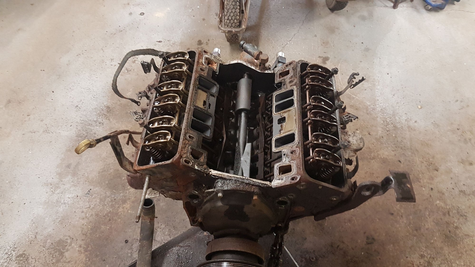

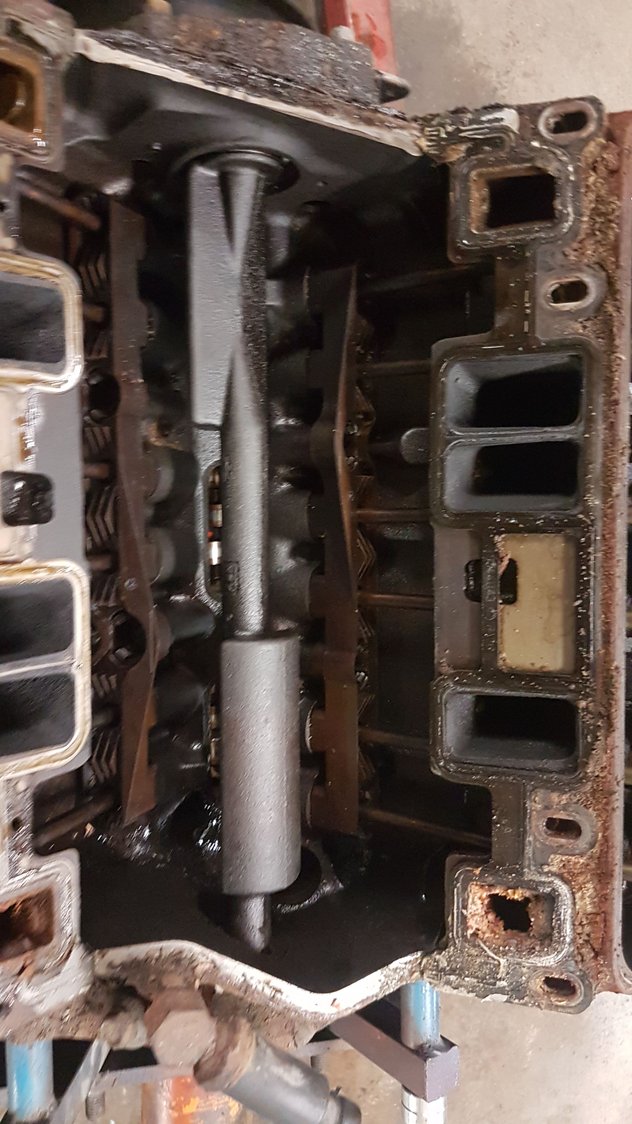

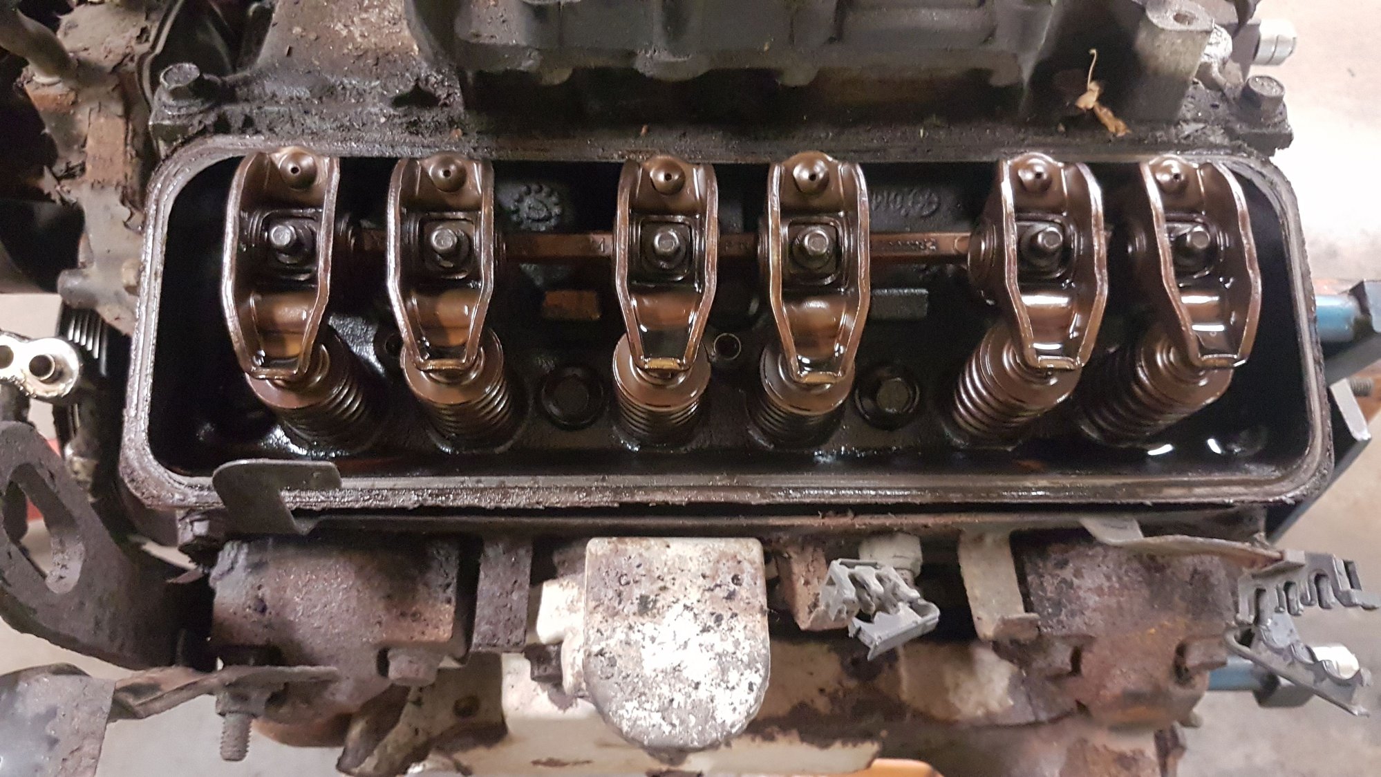

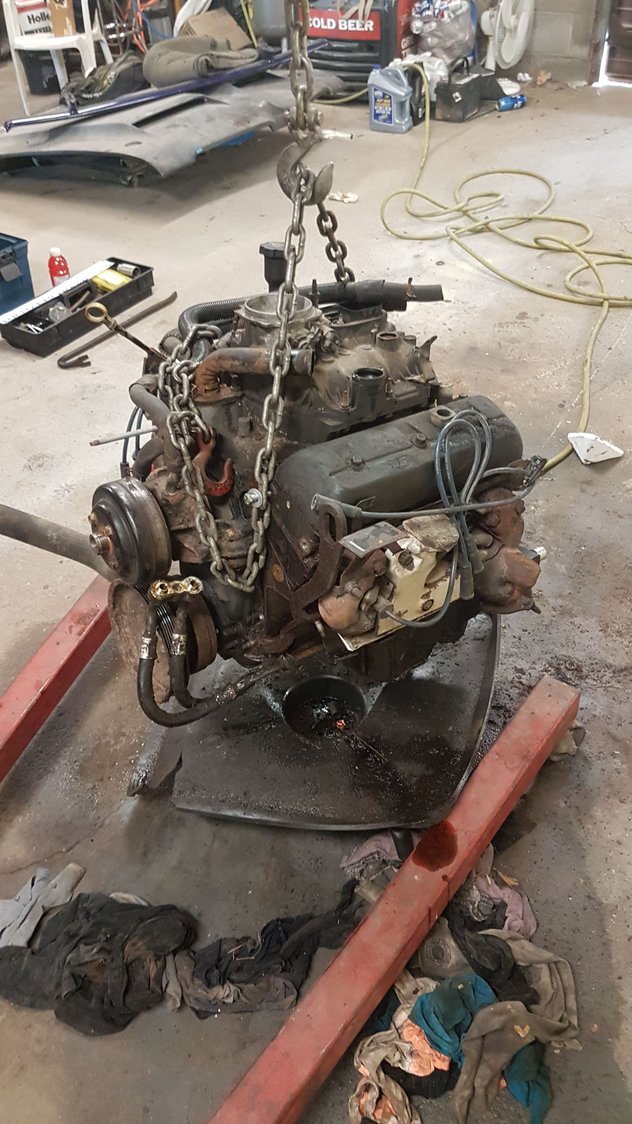

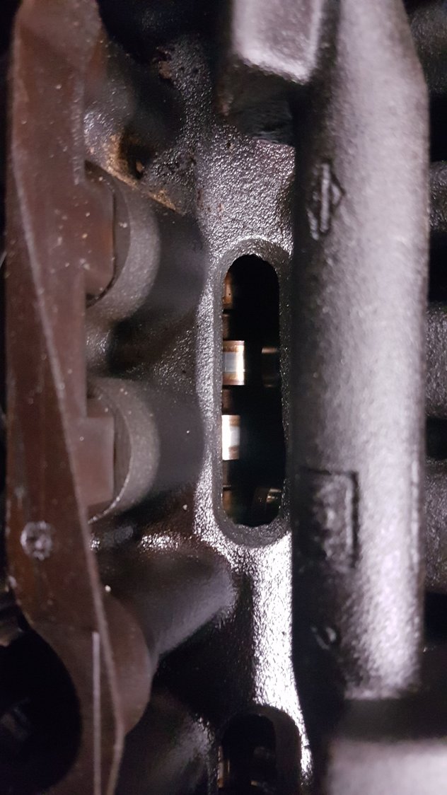

Stopped by the mechanics today, last week his dog passed away so he was taking the week off, but the week before he had a hell of a time getting the engine out. Couldn't do it at all, so today I worked my butt off to leave early, and met him at the shop to give him a hand.
the front diff was about 1" in the way of the oil pan being able to pass and go over it, so I crawled under the truck and removed both lower end supports that are bolted behind the LCA(got a set of engine plate mounts while I was there). Then I removed the two bolts that hold the "axle" to the support arm behind the passenger side front wheel. With a pry bar and a few shakes, we got it out. Strapped the tranny to the air duct at the bottom on the windshield, and the truck is almost ready to be taken by the guy who's buying the remains(making my money back for the truck, and some to pay the bill). Gotta swap the axles before that happens tho, glad hes not in a rush for it. But I bet he will be happy to hear itll be ready lol.
started tearing the engine down, was extremely happy with how "clean" it was. No sign of fluid mixtures, and the only oil on the outside of the engine, was from the power steering leak.
also brought home the valve covers to degrease, clean and detail. I'm also going to go over the "v6 vortec" with white paint.

Job well done Don. Aren’t they cute little motors? My brother has a old (pre balance shaft) one on a stand all hot rodded up in orange and chrome in his shop.

It's funny you say that, I had the valve covers off and brought them to work to clean off. And it took me about 10 min of looking at them to notice how small they actually are... tinny little thing is right!
got some more done today, as well as cut off the back fender flares from the sonoma. Gonna move it and take the axles out early next week.

Replace the bearings while its on a stand, and the (oil pump entirely or its) gears because all that stuff is super cheap insurance. too many stories of a "running condition" engine spinning a bearing a few miles down the road.
