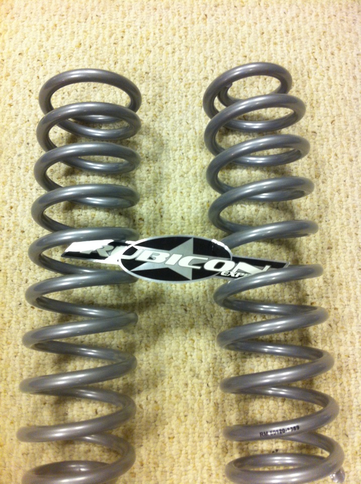

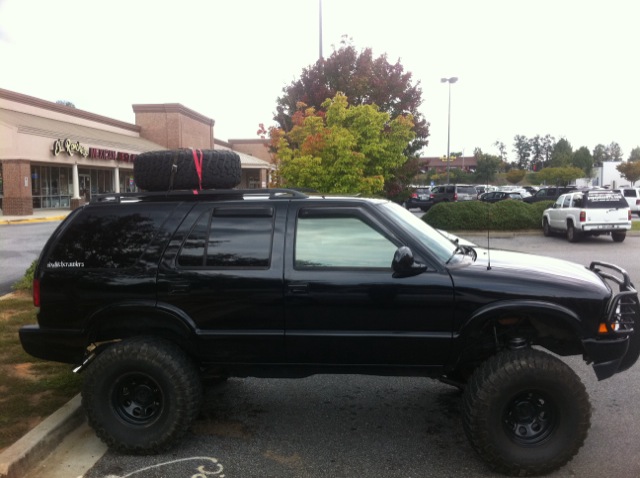

Had several issues with the front driveshaft. After entending and completely rebuilding it and making it thicker I shouldnt have any more problems from it. YAY 4WD!
I also did some research and believe I found the perfrect coil springs to replace the wore out ones and spacer...

And with them on,
