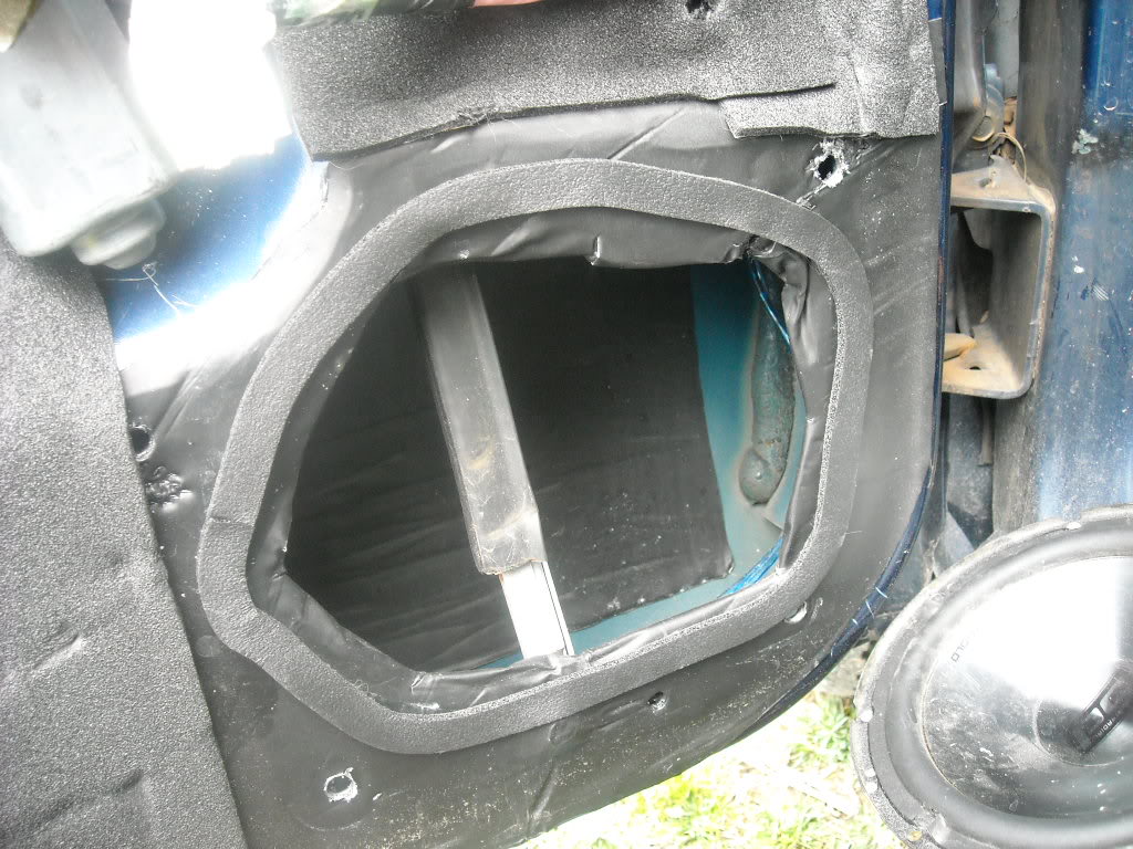

I've applied some CCF speaker gasket tape around the opening of the door for a couple of reasons. One, it's just another way to help decouple the baffle from the door. Two it will help seal it, obviously..
[/QUOTE]
im not trying to be a jerk with this comment and you obviously good at what you do. i love what you did with the door panels, cutting the stock grilles out that is. gives me an idea about mine. anyway, to the point.
if the baffle that you made has no back on it behind the speaker, what exactly are you sealing?? im kind of a novice to the whole speaker sealing, making it sound better thing, so i guess im curious as to what you did that. thats why i started with what that first line.
You're definitely not being a jerk, that's a perfectly legitimate question. Any sound that we hear and reproduce through a speaker system in it's most basic form is a sine wave. An AC signal that has an equal positive and negative rise in voltage which means that when the speaker cone moves it's moving an equal amount (ideally) forward or out away from the frame/motor and rearward or in toward the frame/motor. Due to that the sound wave that is created by the rear of the speaker cone is a completely opposite representation of the sound wave that is created by the front of the cone. If you set a speaker on a table with no baffle, box or anything to separate those sound waves it's really hard to make out exactly what you're hearing. For the most part the majority of what you hear is cancelled and what little you do hear is only what's not gotten cancelled yet due to reflections, etc.
Whether it's in a house, car, boat, PA system, etc. the back wave has to be kept from the front wave (except in a properly tuned ported enclosure, but that's an altogether different discussion) so that what we hear is as clear and uncolored as possible. In a car door, there is a tremendous number of places that back wave is going to have an opportunity to come out of the inside of the door and interact with the front wave. Ideally the best solution is to seal as much as humanly possible in that door to prevent that issue from occurring and that's precisely what one of those functions of that seal is for.
In all honesty, it's really a bit of overkill. If I were to mount the baffle directly to the door, especially with all that sound deadening mat on there, it would seal pretty well and very little of that back wave would ever get through that particular location, if any. I'm a bit of an overkill enthusiast though, and yes I did it to help seal the baffle to the door, but it's biggest reasons for being there was to help decouple the baffle (not make the mating of the baffle and door so rigid that the forces enacted by the speaker on the baffle are transferred into the door's structure) and it gave a little bit of wiggle to the baffle so I could perfectly align the protruding part of the baffle with the hole in the door panel.
Hope that helps explain my actions there.

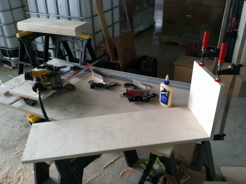

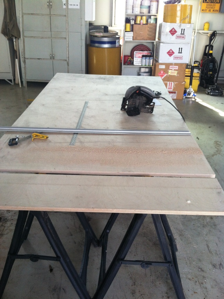

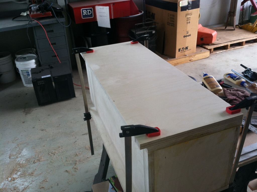

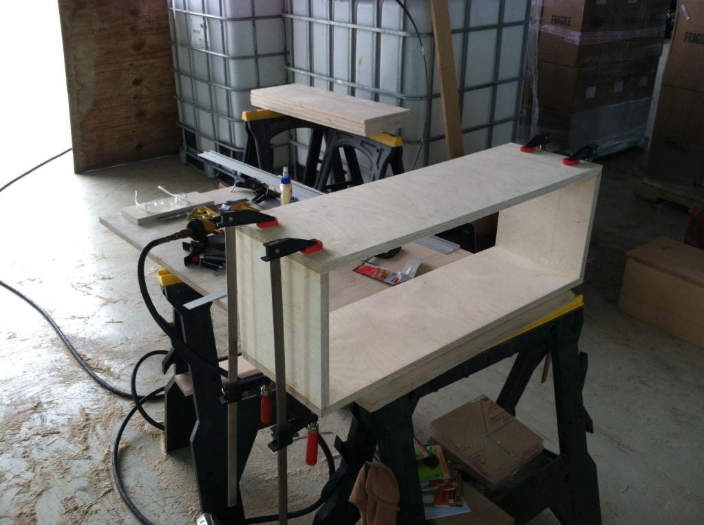

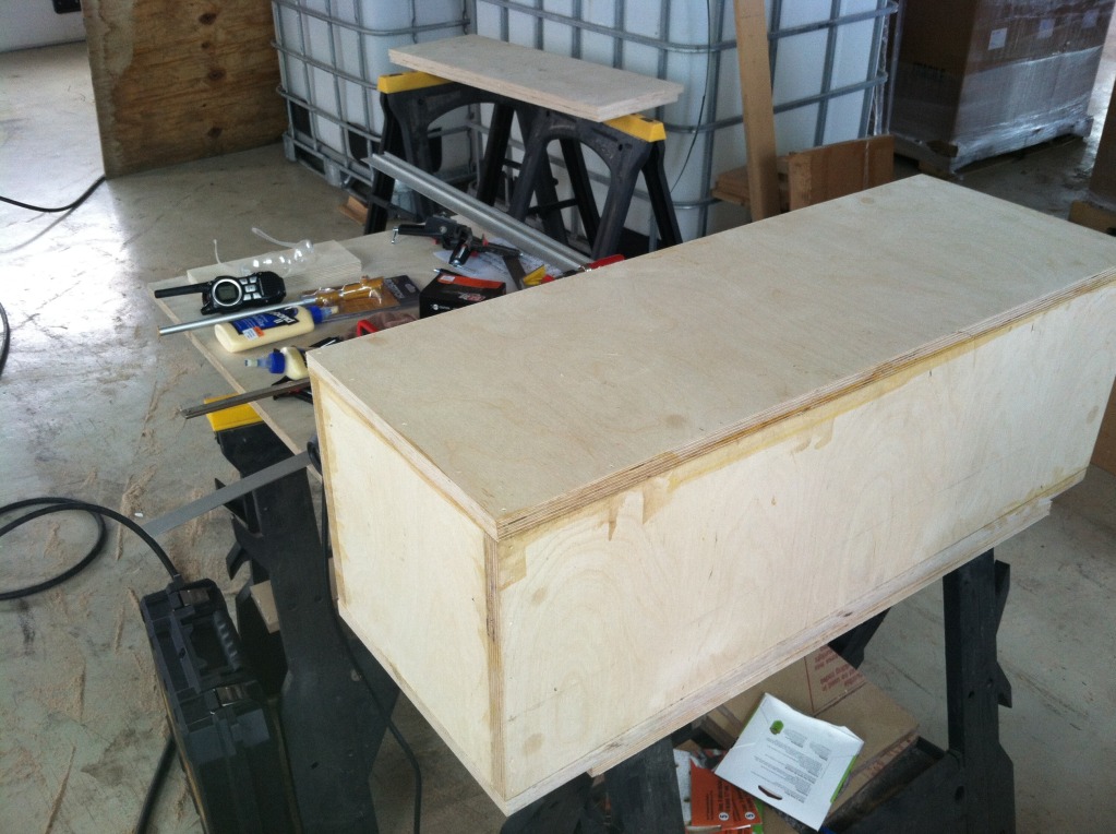

Ok. Finally got started on the enclosure again. Work has been just shy of insane with us running most of our engines moving gas since September last year. In the last few weeks we've been slowing down on the amount of gas we're moving and engines we run so after getting caught up on a few things I had a little free time to start on the enclosure. So here's a few pictures to start it off, lol.
First cut. It is noticeably easier to cut than MDF, I'm looking forward to routing it for the plexi.
Got all the cuts made, beginning the assembly.

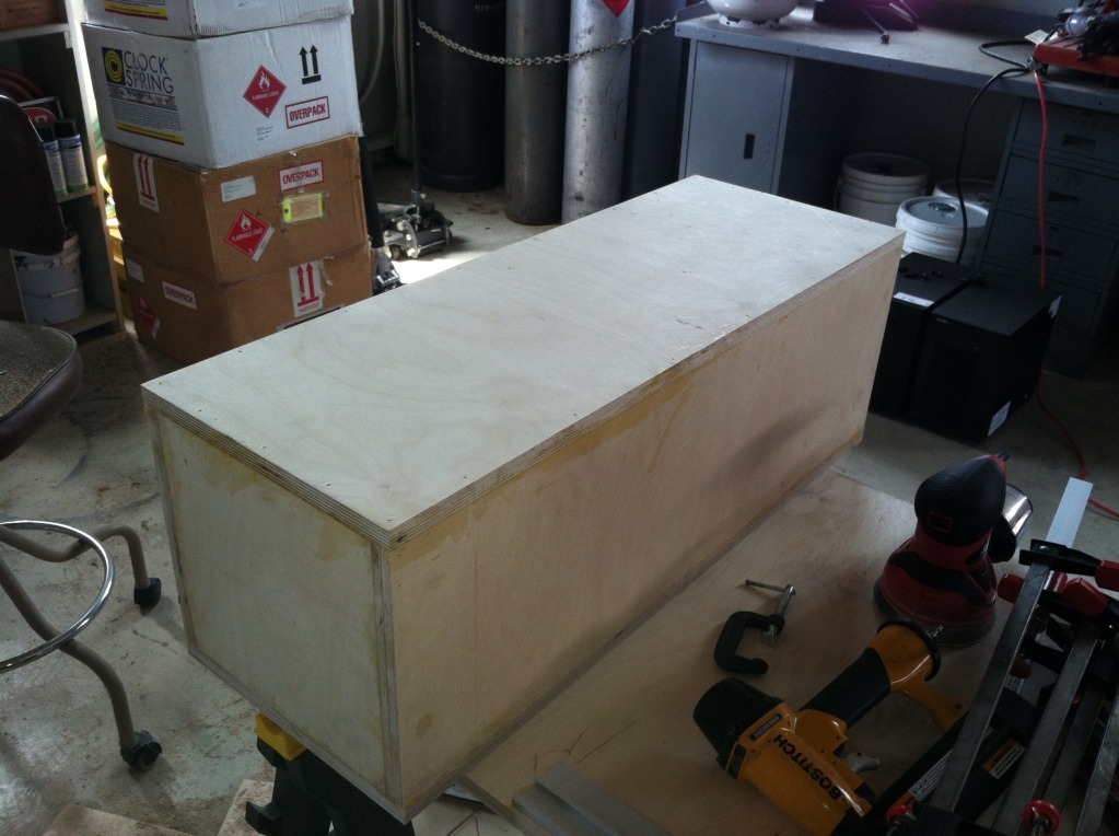

This is how I left it today. With any luck I can get there to work on it some this weekend but I'm not going to hold my breath.

Using plywood for a box? I always heard thats not a good idea from my dad who is a carpenter and by no means an audiophile. He told me that the vibrations would separate the fibres and glue and that plywood flexes where MDF doesnt. He also figured that the plywood would add a "buzz" to the sound, and also wouldnt be air tight. He always built my boxes and used MDF even though he also hates cutting it with his saws (something about it being hard on his expensive blades and the bad smell it gives off). We always used 1/2 instead of 3/4 to cut down on weight, and to add stregnth he would build braces into the corners and rib the large panels. What wood is it exactly?

I'm not sure, but I'm guessing maybe baltic birch. Seems to have lots of layers. Lots of people use it now a days for boxes if you can find/afford it.
Jason is correct. It is Baltic Birch plywood and not the typcial plywood found for construction. It's comprised of 11 layers that are almost completely void free, with much higher quality glues and hardwood plys and the reason why it's $90 a sheet. I've never tried it before, had an opportunity to give it a shot and the money so I went for it. I will say that while it's much nicer to work with so far I don't think I will be spending that much money on materials for a box again. MDF is SO much cheaper and easier to get.
Also, I forgot to update the thread about the original box I had started on. One of my co-workers was cleaning some engine/regulator parts in the parts washer and set them on the top of the box when he got done. The cleaner in those washers and MDF DO NOT GET ALONG! It literally disintegrated the panels it touched and ruined the enclosure.

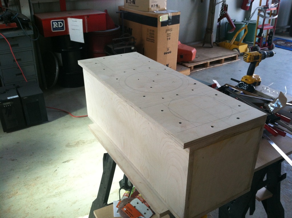

A few more updates. I'm at the intrakit part of the build process now. I have to use careful precision so that the holes and flush recesses all line up perfectly.

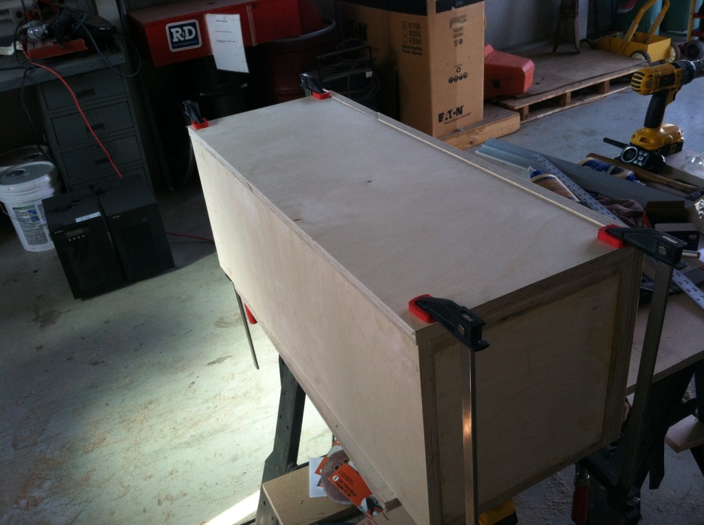

Here's the enclosure with all the regular panels attached.

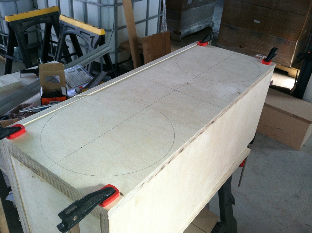

Here I've clamped the top double baffle panel onto the enclosure. Once I got it aligned I measured out the centers for each of the three cuts I plan to make on this panel and traced the outline of the holes to be cut.
Here I've got the outlines drawn. I also used those outlines to know precisely where to put the screws that will hold the baffles together once they're ready to be glued.
Here I've clamped the front double baffle onto the front of the enclosure. Getting ready to measure and mark the centers for the three holes on this side.
This is how I had to leave it today. I got the outlines for the PR's drawn and if you look very closely you can even see the center holes. Those holes are drilled down to the first baffle beneath. That hole lines them up perfectly so I can transfer the hole for yhe plexi windows through both.

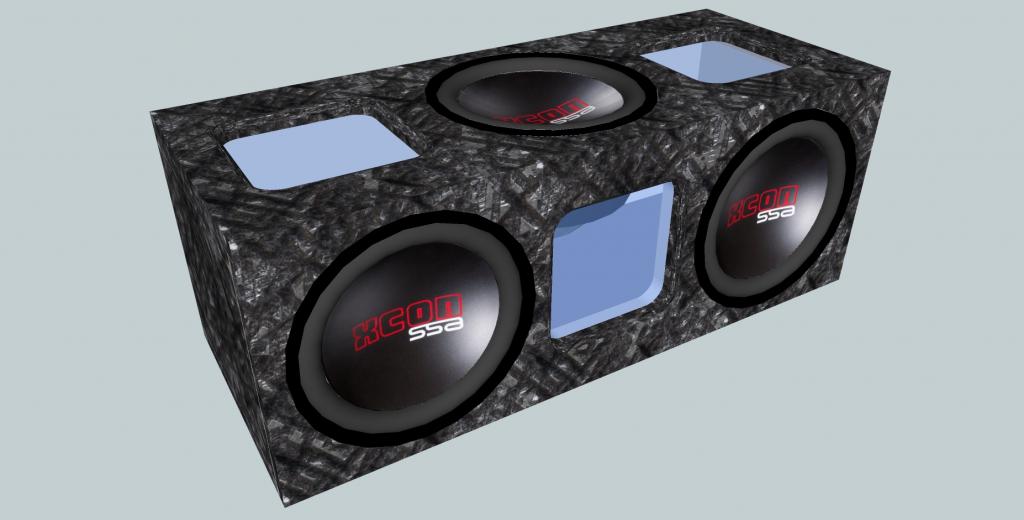

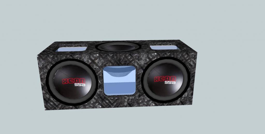

This is basically the design and what it should look like when its completed.
