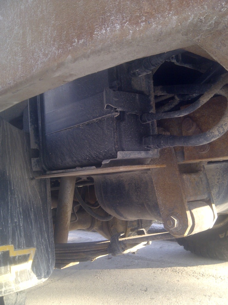

Love the bumper, did you relocate the charcoal canister?
Not so much relocated as raised up. I will get a picture for you.

The black box is now mounted to a plate that is mounted flush to the bottom of the frame. This was only possible because of the body lift.
Attached Thumbnails Blaz's 05 blazer-img-20140513-01021_zpsddbab6d2.jpg   Blaz's 05 blazer-img-20140513-01022_zps80f01e61.jpg

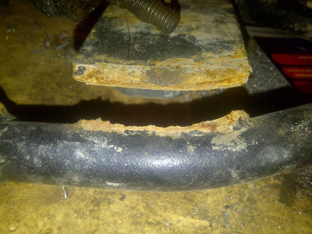

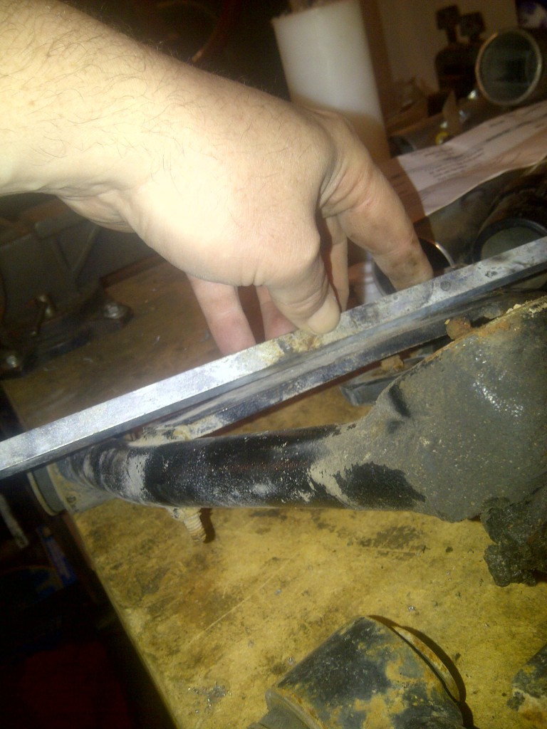

2.5" RC update;
I had CV boot issues and I had CV binding issues. I also found the passenger side upper control arm broken in the center of the weld. I have now swapped back to the factory upper control arms and I will stay with those until I SAS. The BJ's on the RC control arms were still fine and No other issues but changing CV's wasn't my idea of fun. I still had my original CV's in prior to the lift. I went to the junk yard and picked up some GM factory CV's and installed those. I use my blazer off road and as a DD so I like everything to stay in good working order at all times. RC said they will warranty the arms, but I will probably just sell them with the RC shocks. My factory bilsteins went back in and I realized how much rougher the ride was with the RC lift/shocks. I am not saying this lift is a bad lift I am saying it didn't work for me. I am keeping the diff lowering bracket because it didn't cause any issues.
Broken weld.
This pic shows the drivers side arm starting to bend too.
Attached Thumbnails Blaz's 05 blazer-img-20140513-01019_zps71f7a6dd.jpg   Blaz's 05 blazer-img-20140513-01018_zps66da5001.jpg
