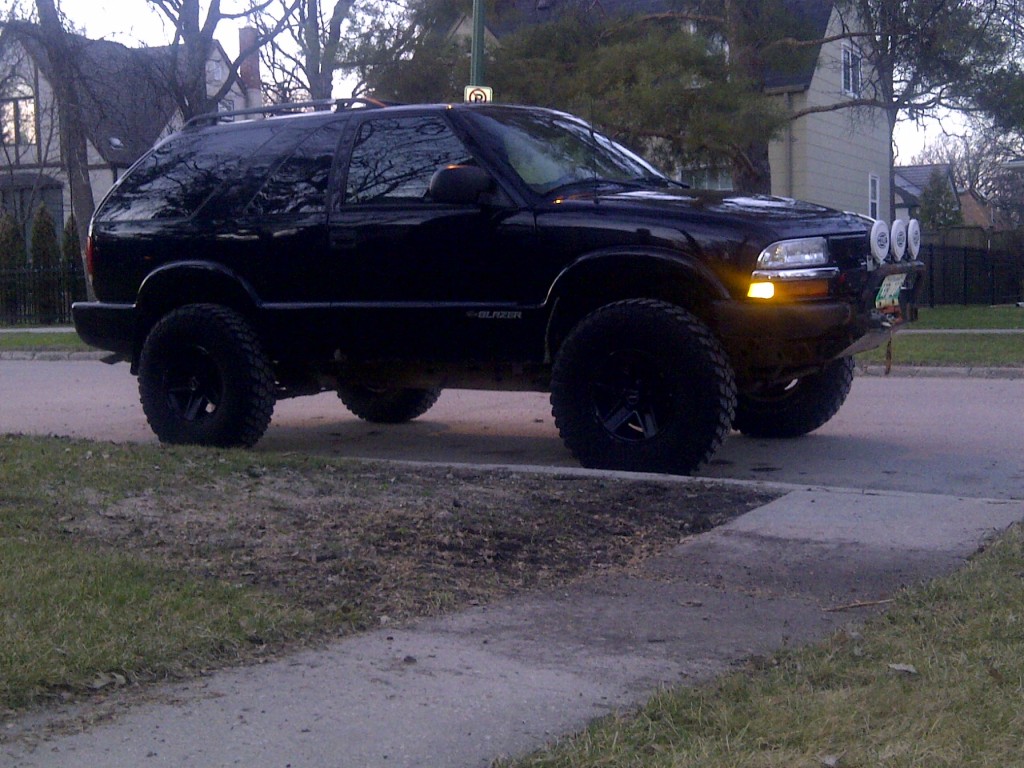

Washed it and took the roof basket off. I am too tall to park underground with the basket now. I think I will make a low profile basket in the future.

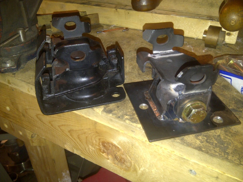

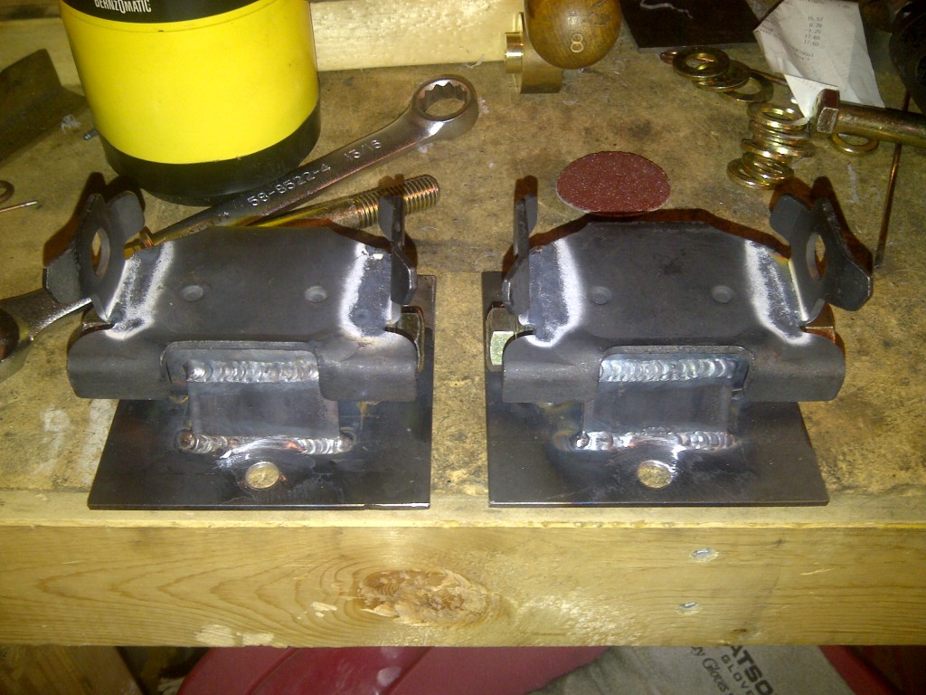

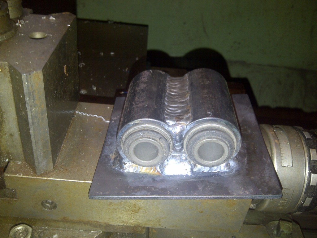

I have had issues with my motor mounts since going to 33's. I have a manual trans. and it is probably partly due to no torque converter absorbing shock. Also, the 3.42 rear end doesn't help. Anyway here is my solution.
I used some leaf spring bushings some 1/8" plate and some 1 1/4" 1/8" wall tube I had laying around. I also used part of the original mount. I was going to go solid mount but this seemed like a better plan. time will tell.
I was going to double stack the bushings but there wasn't enough room.

Looks great! I have the same setup on my Jeep, and it works and lasts awesome.

Wish i could weld like that, as of right i weld no better than a monkey.

Thanks guys. Practice, practice and more practice is the only way to learn to weld. School helps too.

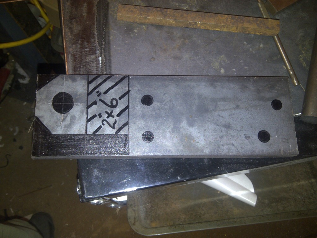

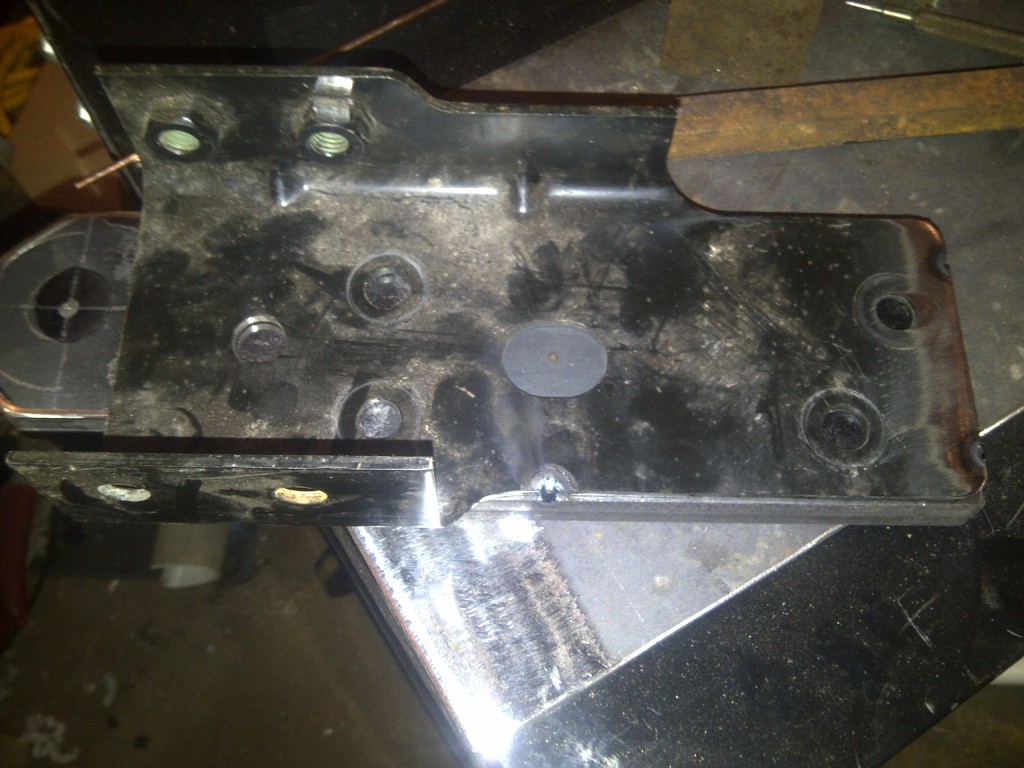

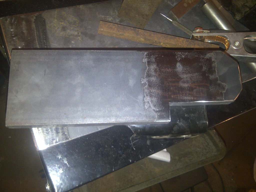

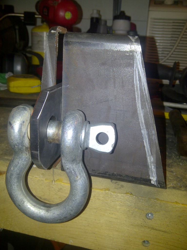

REAR BUMPER TIME!
Sketched out the plan.
Cut and ground the shape.
Tacked the old frame mount to the brackets so I could transfer the holes.

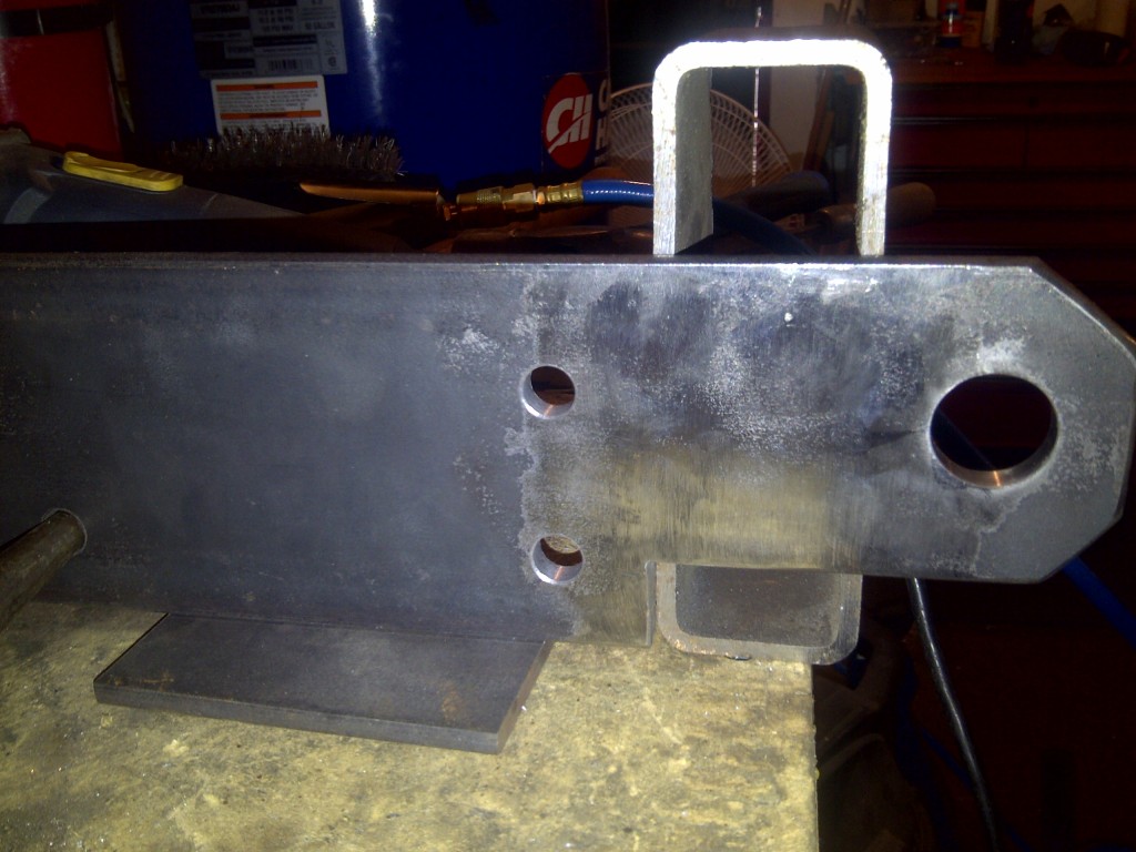

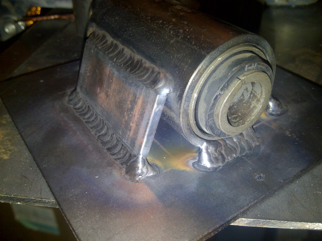

Mounts are finished. I need to order some 2x6x3/16 rectangular tube. The mounts will go straight through the 2x6. I took a couple of pics just to get the idea.
