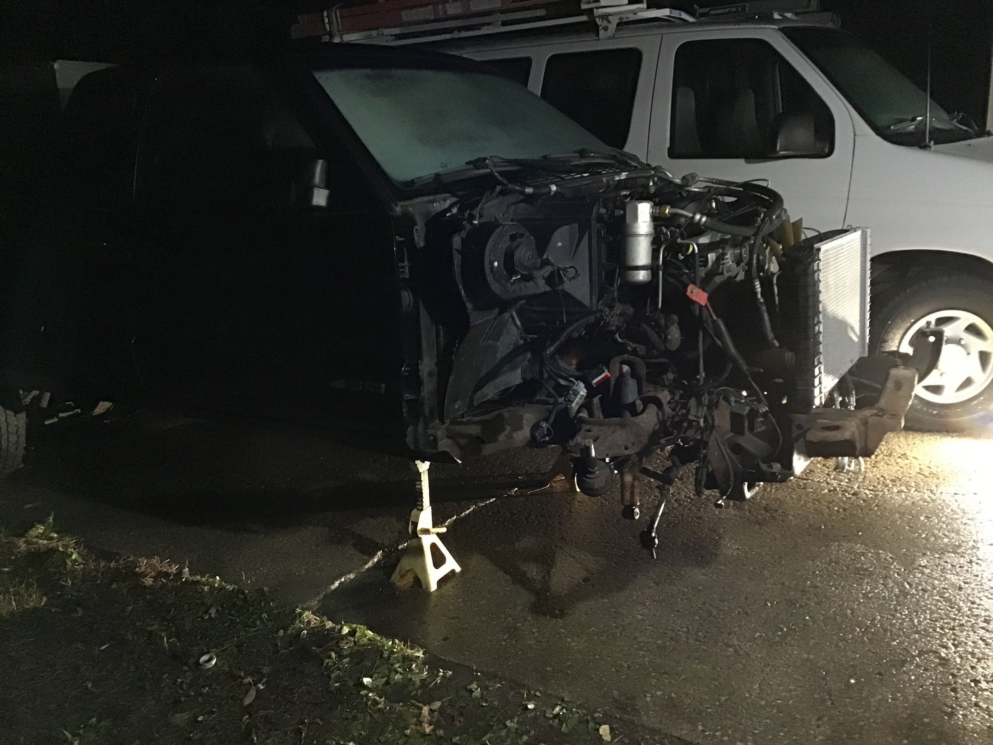

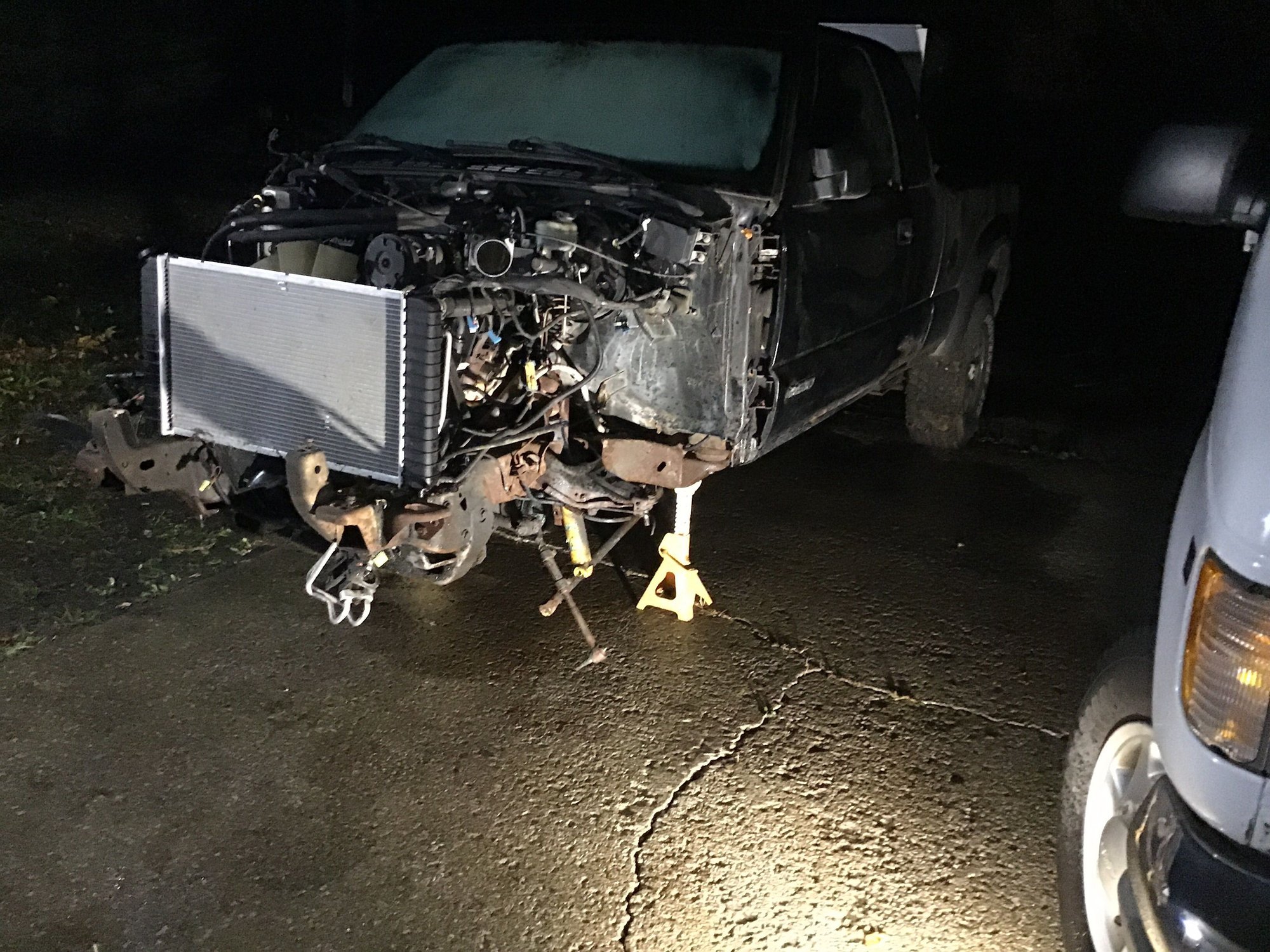

Update .... ZR2 front clip off, fenders will do including passenger inside fender. Driver side gonna order a new one I think....
Also it’s Radiator core support was in pretty good shape. Nothing a wire wheel and sandblaster at grounding points won’t fix.
Got the Driver-side lower control arm off... FYI clean hands and hammer off before beating the sh*t out of control arm to get off the dam torsion bar. Slipped one to many times and had to use die finder to cut big thing torsion bar goes in. Tomorrow night will take 6” grinder and cut the torsion bar mounting bracket and slice the key on 2 sides to avoid hitting it with a torch.
Passenger side took 6 hits with hammer and the torsion bar come flying out of the key. Took sawzaw put 2 notch in lower control arm close together in a v pattern. Drove a cold chisel in notch smacked the control arm a few times and out came the torsion bar.
In case I didn’t note I got the blazer keys and torsion bars out last night.
