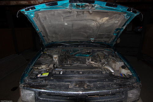

Now I'm scared that this has gotten too built up and it won't be as cool to you as it is to me. Things rarely go smoothly for me and this little project was no different. I ended up having to change plans, mounting points and parts several times, but I'm kinda stoked about this, and I'll likely be doing this mod to my Durango too at some point. Anyways, after 3 trips to the parts store trying to find the exact parts I need, I'm finally finished this mod. I'll start with a photo.
Notice something missing? The hood prop rod isn't up you say? Yup. That stupid thing drives me crazy every time I have to work under the hood. Now I understand why it wasn't an option on my Blazer, but on my '07 fully loaded Durango it's a downright shame.

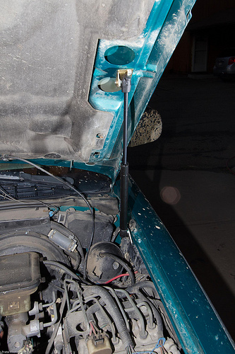

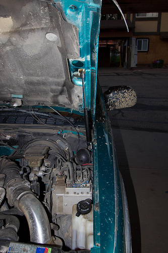

Like I said earlier, I'm not the first to do this mod, and quite possibly some people on here have already done it too. It was something I've wanted to do for several years, and I first saw it on the S10 forum. I followed fairly closely what was done over there. I used 2 56lb lift rods. I think you might get away with anything between 45lbs and 60lbs. 30lb rods are definitely not strong enough. I used stainless steel bolts to attach all but the upper passenger side mount. That one just didn't have access to put on the nut so I used rivets. This was the first time I've ever used a rivet, but it seems to hold just fine. The lower mounts I attached right beside the upper rubber hood guide. The hood mounts I attached centered over a small dimple on the side of the main ridge. Here's a couple more photos if you're interested.
As you can see, I had to remove the vacuum ball from the bottom of the hood and stash it below. I realize that this is a highly sensitive piece of equipment, but hopefully it won't throw off the system too much.
I did paint the metal after drilling the hole since it will definitely be exposed to water. I do think I'm going to reinforce the rain tray, since it does flex when the hood is up.
