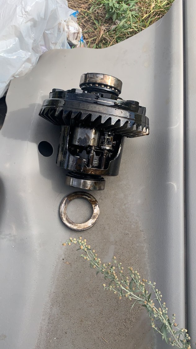

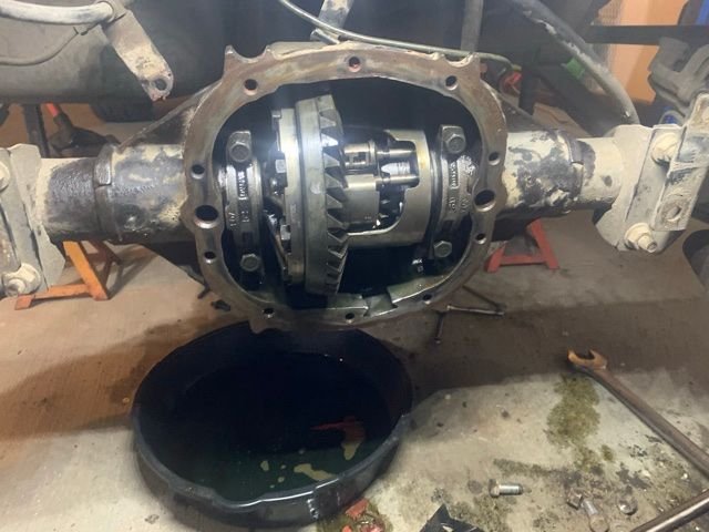

So followed blazen’s mounting steps and installed intrepid e fans used an heyden 3651 controller and put a probe in the head for the temp sensor heatwave a few weeks ago cooked the clutch fan so had to be done. Also went to the man mall yesterday and got a replacement g80 carrier for the rear end found a place that will take the old bearings off it and install the new ones cheap.
Got snow coming soon and want to have the locker back did not enjoy an open diff last winter and during the off roading trips

Was out in the garage late last night got the g80 carrier all installed and touched up all the paint
been trying to find a new hood been watching for a black Jimmy with a good hood and a tire carrier
