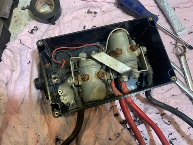

Spent the day in the garage yesterday my new hawse for the winch came in and new 20k lb synthetic line came and I pick up a proper winch mounting plate and got a abs weather proof box for the control pack. Put the control pack in the new box looks much better
New box
All moved over

the old cable was a mess when I took it off and the winch was in pretty good. The new control box is behind the grill it fit perfect.
