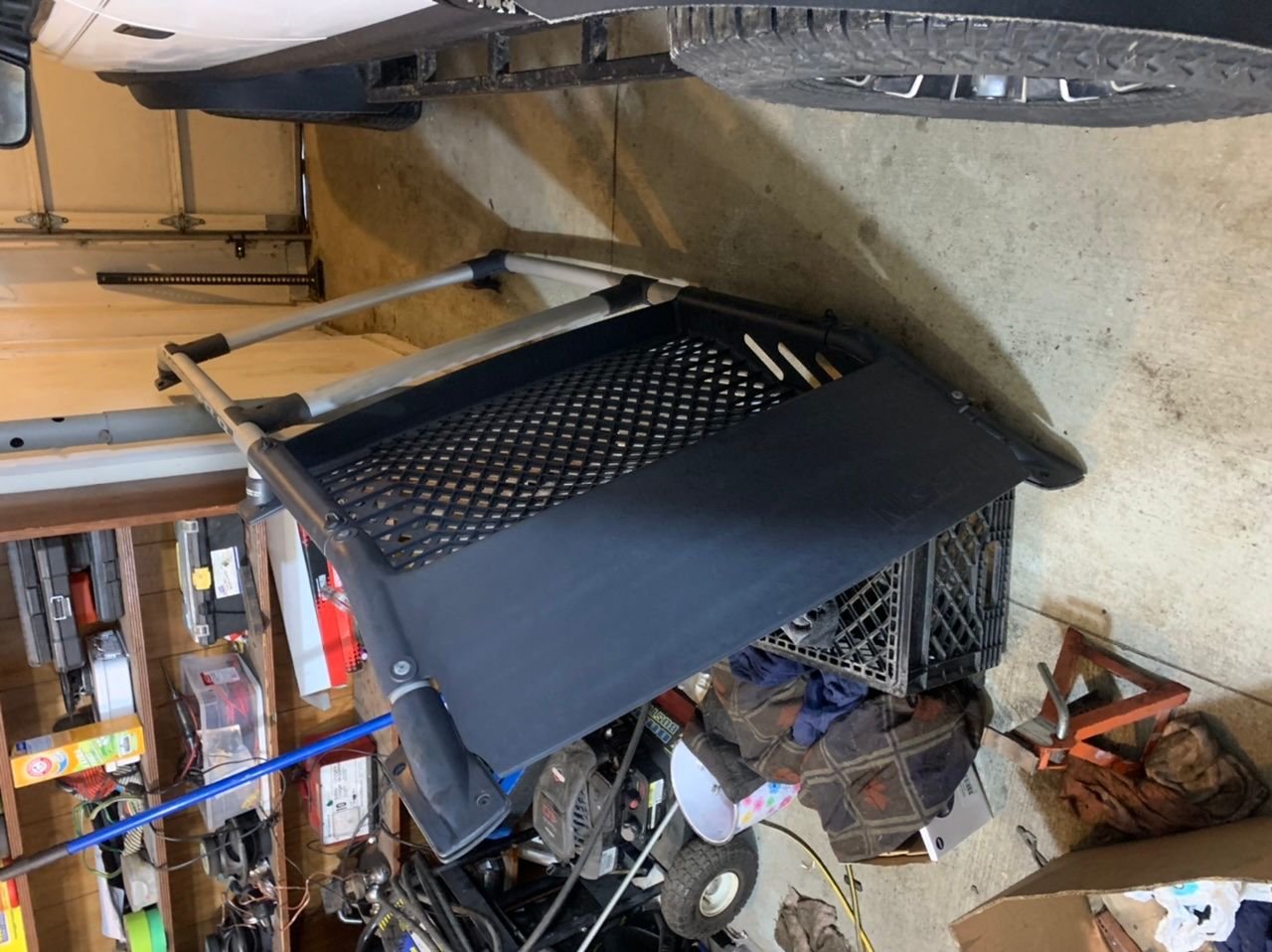

So did a few things had to replace my driver shaft as the slip yoke had some mayor play with the ujoint bearing caps and was cheap to get a driveshaft at the wreckers then it was a new slip yoke $40 vs 120 for just the slip yoke and I got a different roof rack as my homemade was super heavy.

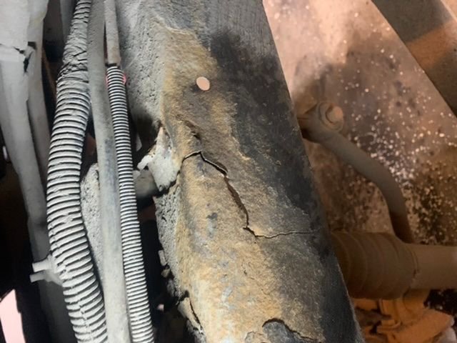

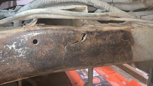

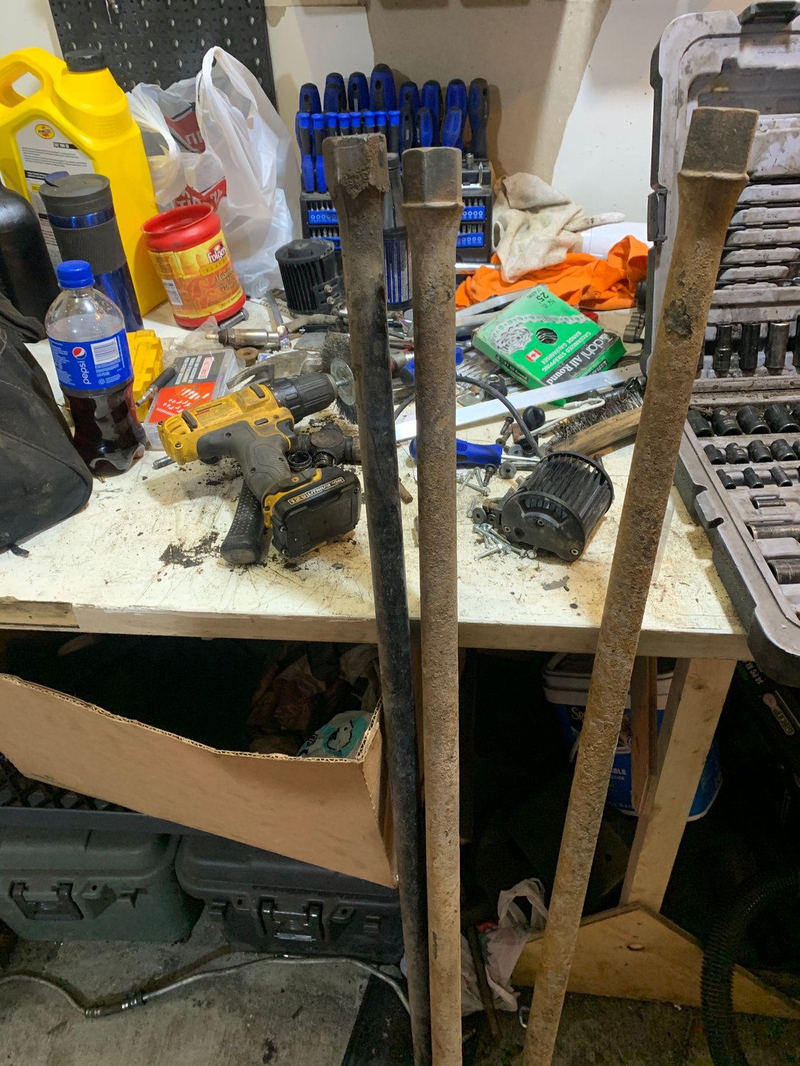

So an update I had to replace my torsion bars found a set of zr2 ones for $60 I had to remove them myself. Turned out mine were in backwards. Raised my height back up and found out my new shocks were shot, rough country is sending me replacement ones as well as a control arm bushing. I have a few parts in order should be here this week
Black one is the old one the new ones are thicker
thursday I’m doing some frame repair have a crack on the drivers side
Old Mar 23, 2021 | 03:08 PM
  #126
Ewww... that doesn't look good...
Those bars look nice, easy to pull? Any tips?

Getting mine out were a lot easier then getting the zr2 ones out took some hammering and a couple hours

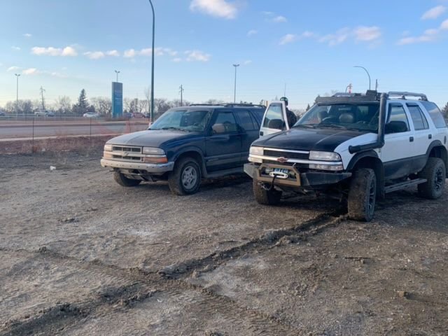

Got my frame all fixed up and cleaned it up nicely. Then my mom went and bought a 2000 blazer ls so I have been put in charge of keeping hers running now too. She will be bringing it today for a complete tuneup
My moms 4dr ls beside mine

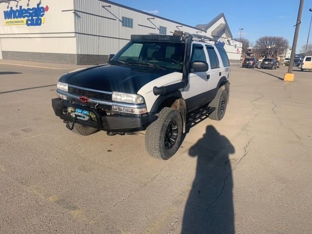

So been alitte bit since last update. I’ve painted like I do every spring and swapped out my front seats from leather to a split 60/40 cloth was super hot yesterday and I burnt me a$$ lol abit more comfortable but that could be cause the seat was shot
