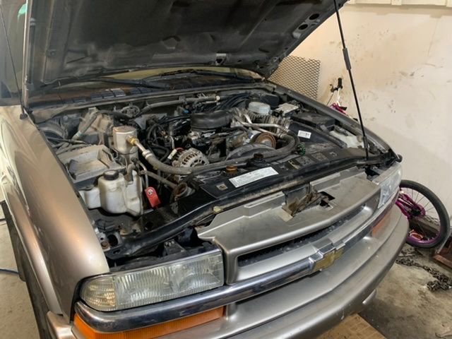

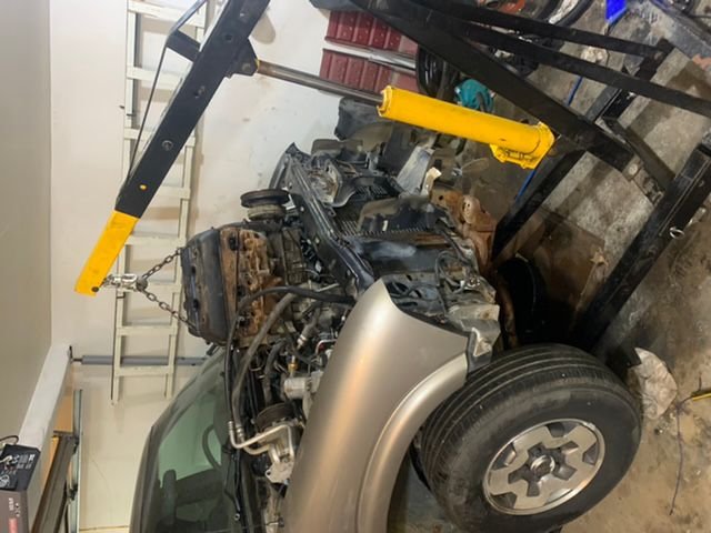

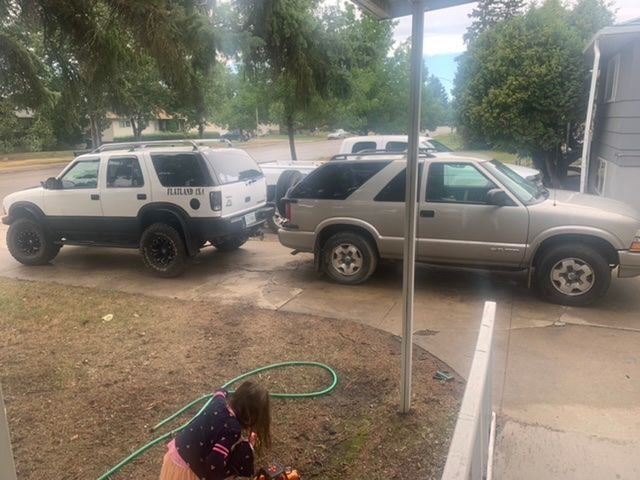

So few updates. My father in laws blazer has been sitting for over a year cause he took out the bottom end so he finally convinces me to swap the new motor in for him. Made out pretty good gave me a new snap on creeper and an engine stand and a set of Mac tools 6ton stands plus paying me.
Old engine out
New engine in
Backed out and ready to go

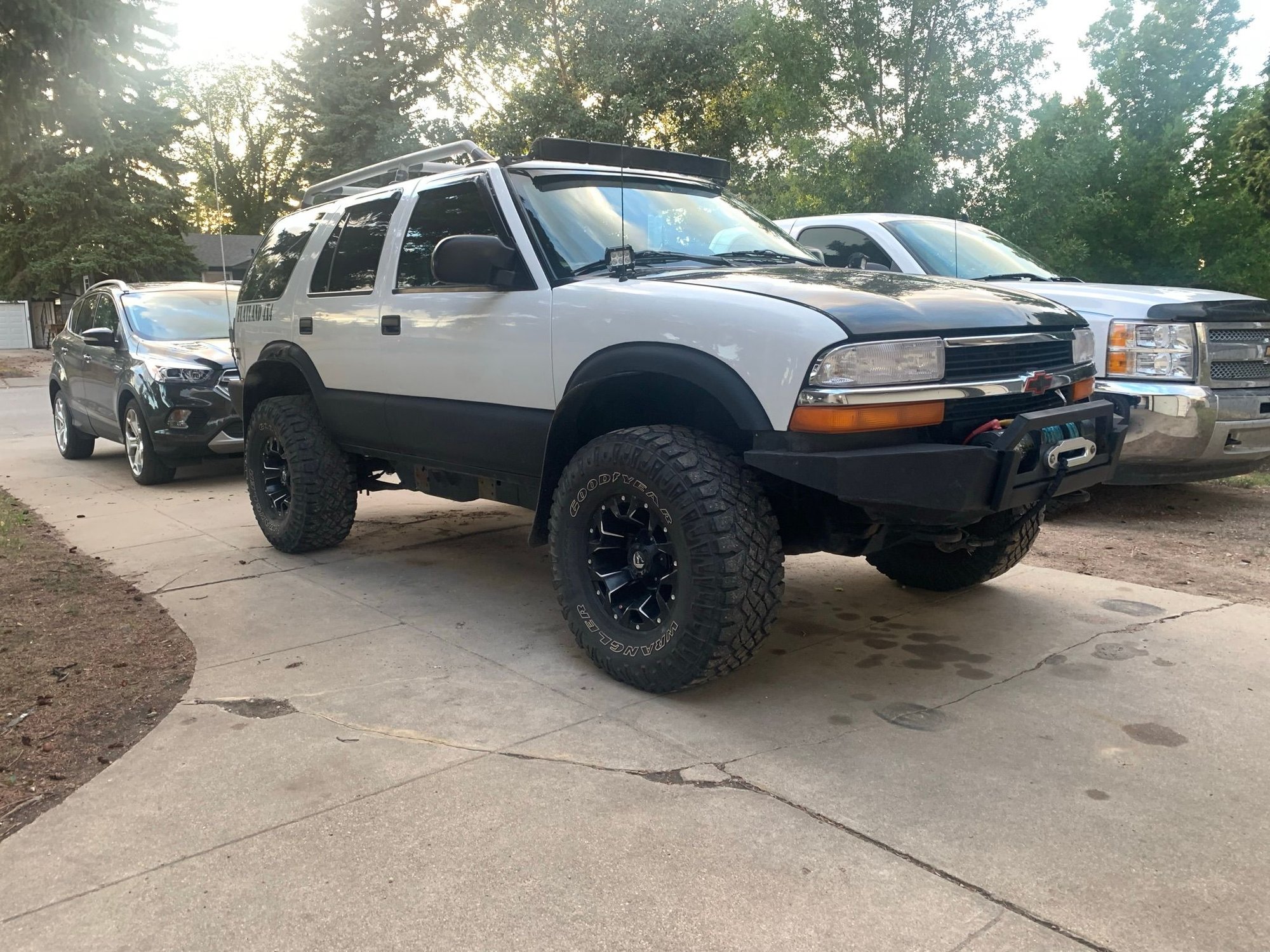

in the middle of doing the swap I went on an overland camping trip and decided my 31s were too small and bumped up to 33/12.5

Old Aug 13, 2021 | 11:10 AM
  #133
Those fit nicely under there!! I'm convinced that I'm gonna go to 33 when my front end and body lift get done!
Old Aug 13, 2021 | 11:16 AM
  #134
Hadyss's Avatar
Joined: Mar 2017
Posts: 412
From: saskatoon, SK
I really do like how they fit and look. I do hit the frame at full lock but I’m gonna build up the stops for that. And hard flex I rub a little bit but again no sway bar allows for more flex so if I put it back it should limit that
Old Aug 14, 2021 | 07:42 PM
  #135
Hess13x's Avatar
Joined: Dec 2018
Posts: 697
From: Idaho
That looks perfect with the 33s..

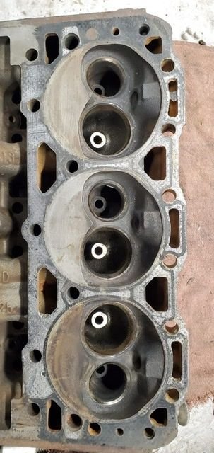

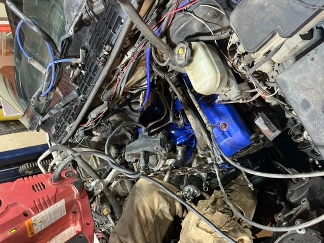

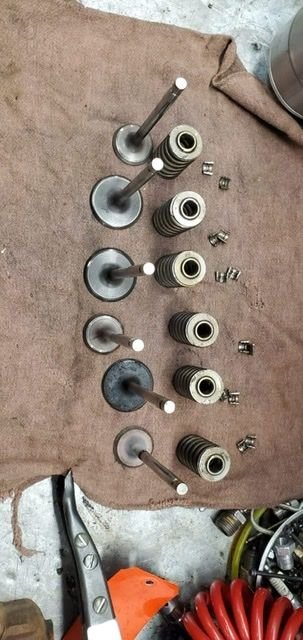

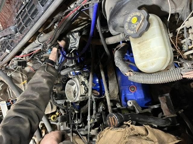

So I decided to rebuild my father in laws old engine since it was low mileage. Gathered everything up and here are the pics. It is now done and installed and runs amazing.
My brother took the heads to his work to grind the valves and clean them all up

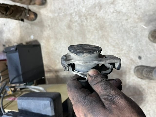

When we pulled the old engine with 372k km on it the engine mounts were shot
I went with new everything. My old engine was an l35 and the new one is a lu3. I’d upload the video of it running but it’s too large. The cam in the old block was eating my distributor gears and timing chain was super stretched

Old Apr 20, 2022 | 02:30 AM
  #140
Very nice!!! Love that blue!!...
Edit: how are you liking the zr2 axle? Lol
