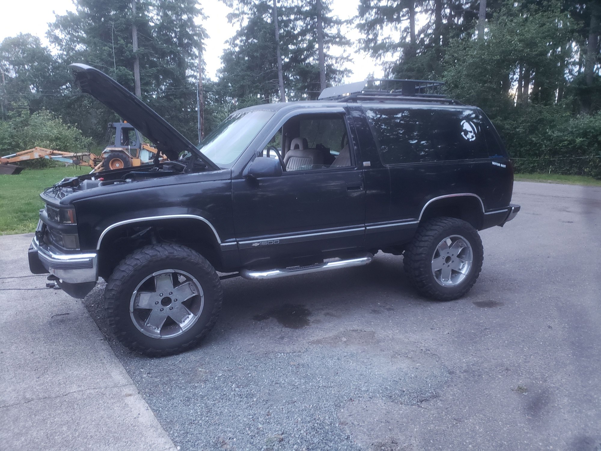

Hay so I have a 94 blazer with 4in lift kit, 35x12.50r20 tires, has a vortex 350 crate motor with tbi on it, aluminum drive line rebuilt tranny, and motor it's also tuned by Brian Harris. Now I'm at the point that it's also gonna needed regeared. My intent for the truck is towing here and there as needed a car trailer. Along with just whatever driving when I do drive it.. so my problem is I have no clue what ratio would be a good choice. It's a gt4 at the moment I believe it's 3.83. any idea or info or related builds that could give me an idea of what kinda gearing I should be looking into doing on my truck.. for info purpose here's the best as she sits..
