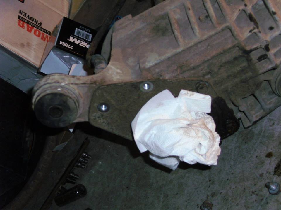

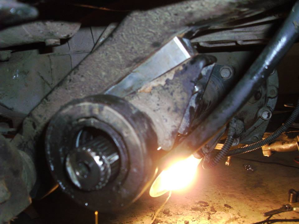

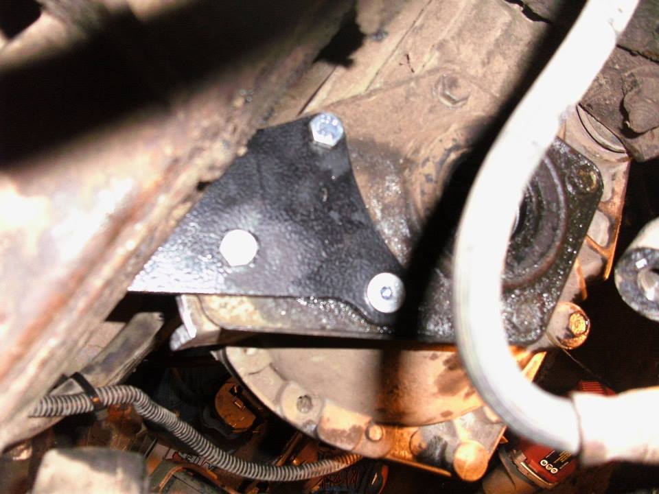

Ok, so the blazer finally hit the ground last night, everything is on. I just have to adjust the torsion bars, and tighten the shackles. But first i have to figure out why my 4x4 actuator is getting vacuum... thinkng about putting the cable lock on it and bypassing Gm's problematic engineering anyways lol. but heres some pics of the diff brackets and what not if anyone is interested in this lift.
this one is of the tab you have to cut off. you dont need to use the template the lift comes ith just cut it at the top line of the plate. i will have pics of the lift and tires on monday or tuesday after my alignment.

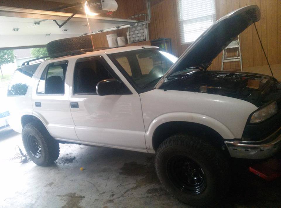

here she is in all her glory, but i cant drive it until i get it aligned, and im having rubbing issues on the backs of the front fenders, thanks to running 4.5bs lol. so ill get more pics mid week.
What size tires?? =S Not good news since I ordered 31's and 15x8 with 3.75bs...

there 15x8 4.5bs 31.1050.15 im rubbing on the back side of the front fenders on both sides. it could be because i havnt got it aligned yet and my caster angle is FU*KED
It's not the alignment. I had the same issue on mine. I picked up a set of similar rims with 3.5-4" BS from Craigslist for $100 and took them to a shop to get the tires switched. The lower BS made me rub the back side of the front fenders really bad so I had to put my stock rims back on. You may end up having to do some major fender surgery to get them to fit.
I've been thinking about picking up another set of rims with smaller BS but I'm nervous I'll have the same issue with only the T-Bars cranked and 31s.
