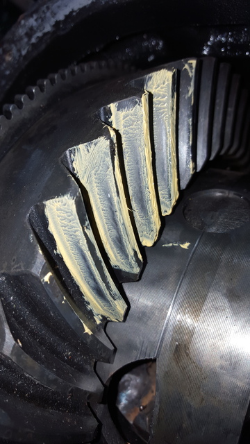

I think people tend to over exaggerate axle work. It's really actually pretty easy you just have to take your time and listen to what the paint is telling you to do and if you go to far with shims one way just go back the other way till you get it right. It's very time consuming but not hard now get out there and get it done man!

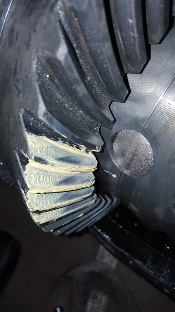

Well, the big problem is my very first axle set up is with used gears, so the pattern looks nothing like it's supposed to with new gears. I think with new gears I wouldn't have a problem, lots of information on what the pattern is supposed to look like. I haven't found a lot on what used gear patterns should look like, and the few I have found look different from each other and how mine look.
Right now I think my drive pattern looks ok, but the coast pattern looks a bit off to me. So I don't know if I should run it or try changing it.

Post up a pic.

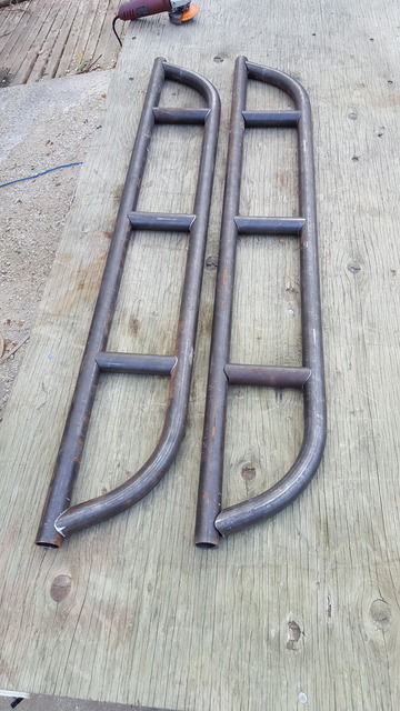

I have also been working on some sliders for blaz. They're ready for him to weld.

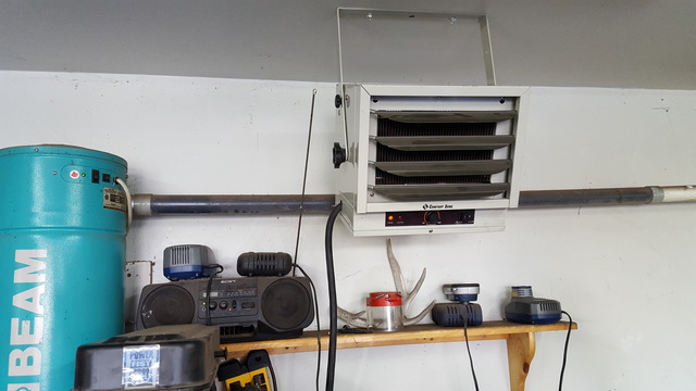

And installed a heater in the garage, 7500 watt. Should keep the garage nice and warm so maybe I'll be able to get things done a little easier this winter

Your pinion looks a touch to deep try moving it out a bit and bring the coast side a little closer to center. You may also need to move the carrier closer to the pinion after moving the pinion out. It won't be perfect but it should be better.

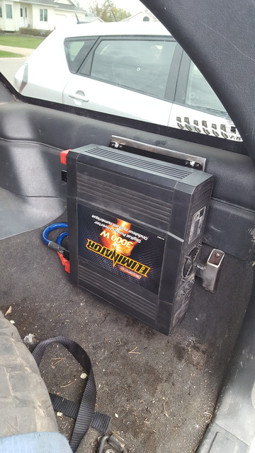

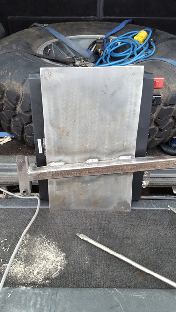

Made a bracket for the new inverter. Needed to space it away from the panels since it's so much bigger than the old one, and I didn't want to have to make new holes so I made the bracket to mount to the same spots as the old one.

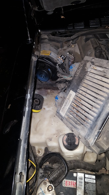

Went wheeling over the weekend. But had to address a couple things Friday night. The blower motor I put in a while back was making some unpleasant noises, so for the sake of my sanity, it needed to be changed. Managed to do it without partially removing the fender this time, but I needed to move the computer out of the way.
Replaced it with a new one this time, so hopefully I'll never have to do it again. Might burn the thing down if I do.....

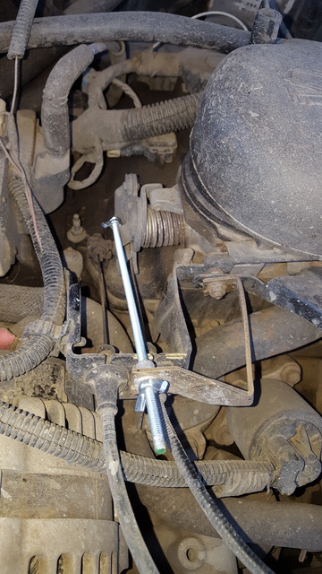

The Inverter also has trouble running my air compressor at idle, so I made a quick and dirty adjustable high idle bracket. The bracket itself could be a little stronger, has a bit too much give to it, but it worked and that's all that really matters.
