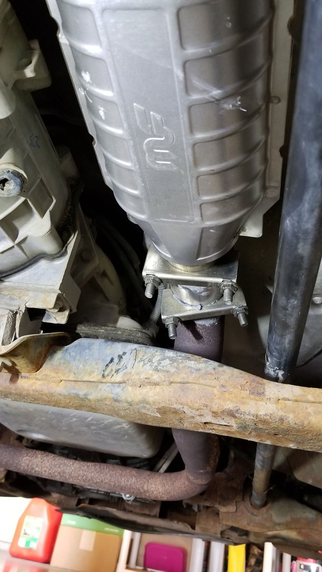

Been quite a while since an update. Son's been driving it everyday, and nothing has been too important to really work on at the moment. ----Until now, haha
A couple weeks ago, there was a loud rattle at lower RPMs, and it threw a code. Checked the code and it was a P420 for emissions. Listened for the rattle, and sure enough, the cat was rattling to beat the band. To save money, I have ordered up a universal cat and an extension pipe from amazon (received yesterday). I plan on cutting the pipe in front of the old cat (which has been replaced before), and disconnecting it from the yoke just ahead of the muffler. Once out, I should be able to cut the pipe just behind the cat before the bend, and clamp that into the cat. Then in front of the cat, use the extension pipe (cut to the right length) to reconnect from the cat to the "in" pipe. Planning on using some exhaust sealer and clamps to button it all up. Will update when this is fixed.

7-21-18.
Got the Catalytic converter installed. Kind of a hack job but it works and is solid. Total cost with clamps, sealer, cat and pipe was about $115.
