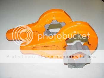

I am pretty sure the new torsion keys add more lift without cranking them due to the degree in which the torsion bars go in. So in theory once installed you could get 2 inches of lift on top of what you would have after having the original ones cranked in the first place, otherwise why would they even give new keys.... Thats why the term rekeyed is used on some leveling kits. They also sell adjustable keys for some trucks that you can adjust what degree you have the tosion bars enter the keys. Heres a pic.
so on another note, yes you should install the new keys!!!
