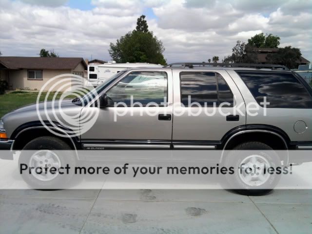

okay here's how she sits rite now.
can anyone give me specs for stock height or something so I can compare mine.
I just want the dam thing level, or something.

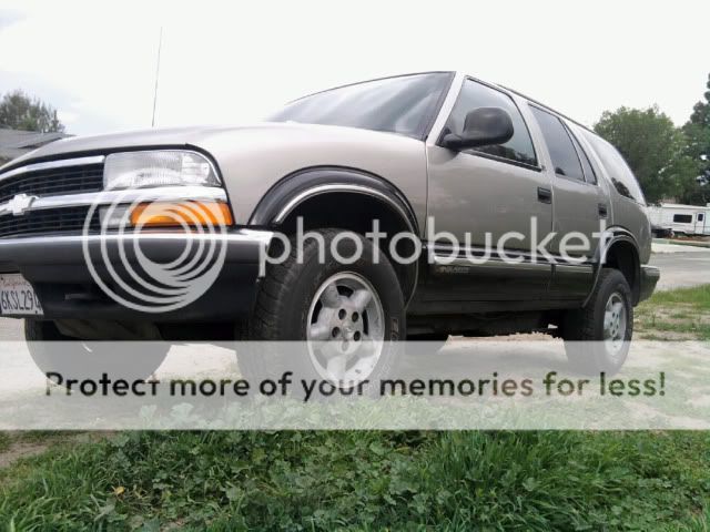

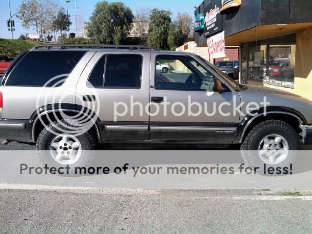

GOT THE TIRES AND INSTALLED THEM
Goodyear Duratracs
31x10.50x15
These things don't rub!!! wow.
The 2 inch lift helped.
BUT...if i go over a steep bump, say drive way, while turning. The front rub.
So, I had the extra $. So i ordered a body lift.(gonna need to paint the frame)
Well here she is. I love the look, and the tires are a dream...
I'm Detailing it tomorrow, so new pics once again.
THanks

Looks awesome man. I was gonna say, the tires look to be real close to the rear openings on the front fenders. The BL is gonna look sick!
