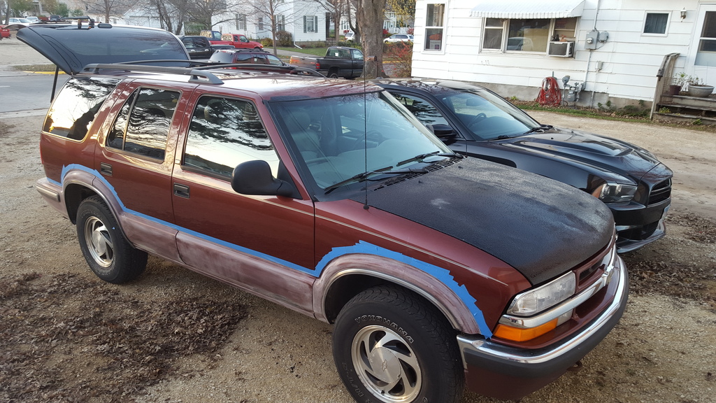

alright so i decided to start a build thread for my 1998 blazer (new to me) so far i havent done a whole lot but plans are building. right now i am concentrating on getting it road worthy, it has some special needs right now nothing too serious. BUT i did pick up some bed liner and POR-15 rust proofer and had a blast so this is where ill start. also did the quad light mod and have HID's in both hi and lo beams 55wat 6000k kits.
mechanically i will have new distributor and cap, new spark plugs, new spark plug wires, new front wheel hubs and bearings, new brake pads and rotors all the way around, new pitman arm, new idler arm, new upper and lower ball joints.
Attached Thumbnails my MINNESNOWTA winter beater build!-20151103_164216.jpg   my MINNESNOWTA winter beater build!-20151103_164230.jpg   my MINNESNOWTA winter beater build!-20151104_162201.jpg   my MINNESNOWTA winter beater build!-20151104_162139.jpg   my MINNESNOWTA winter beater build!-20151104_162057.jpg
