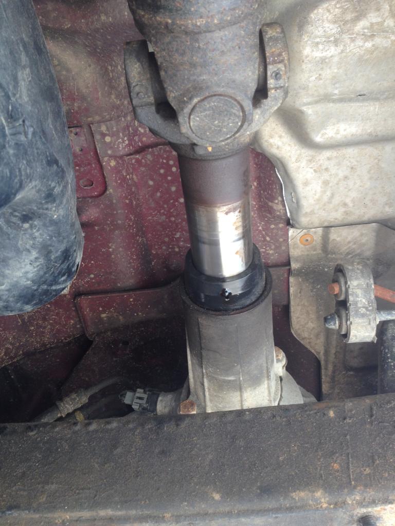

I got the shaft back together this am and in the truck and like I figured I will have to move my axle forward. I've only got about an 1 1/2" of spline into the trans which certainly isn't enough. I'll look around for an extended cab shaft for a few days and see of I can come up with one or just move the axle.

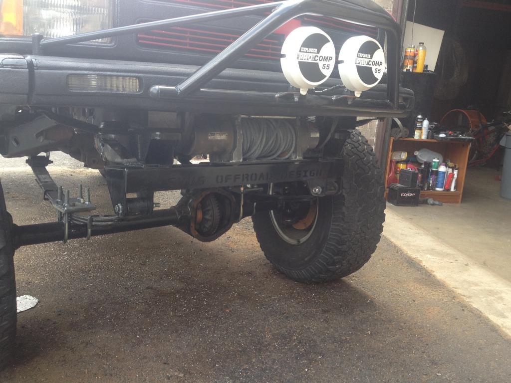

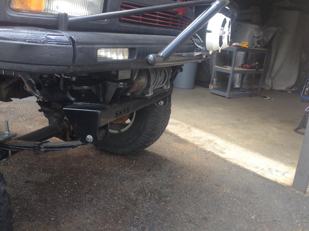

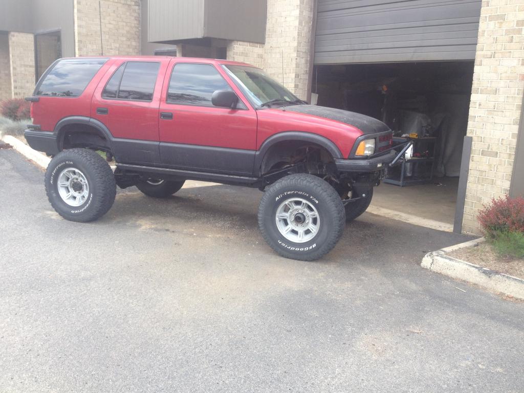

Got my winch mounted and wired today and got the front end put on. Sadly I'll have to take it all back off to build my fairlead mount but I wanted to see what the truck looked like so owell. I'm happy with it since I thought I was going to have to cut my factory bumper but with the BL the winch sits perfectly below the bumper and is up out of the way and well protected.

The winch looks good mounted under there, has a little of a stealth look to it.

Yep looks good, add the truck is a bit more level!

Thanks guys! Yeah I'm really happy with how it's turning out so far. I still can't believe that I managed to not have to cut my bumper to make the winch work in that location.

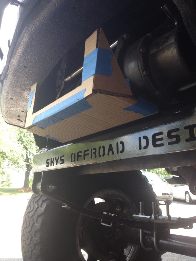

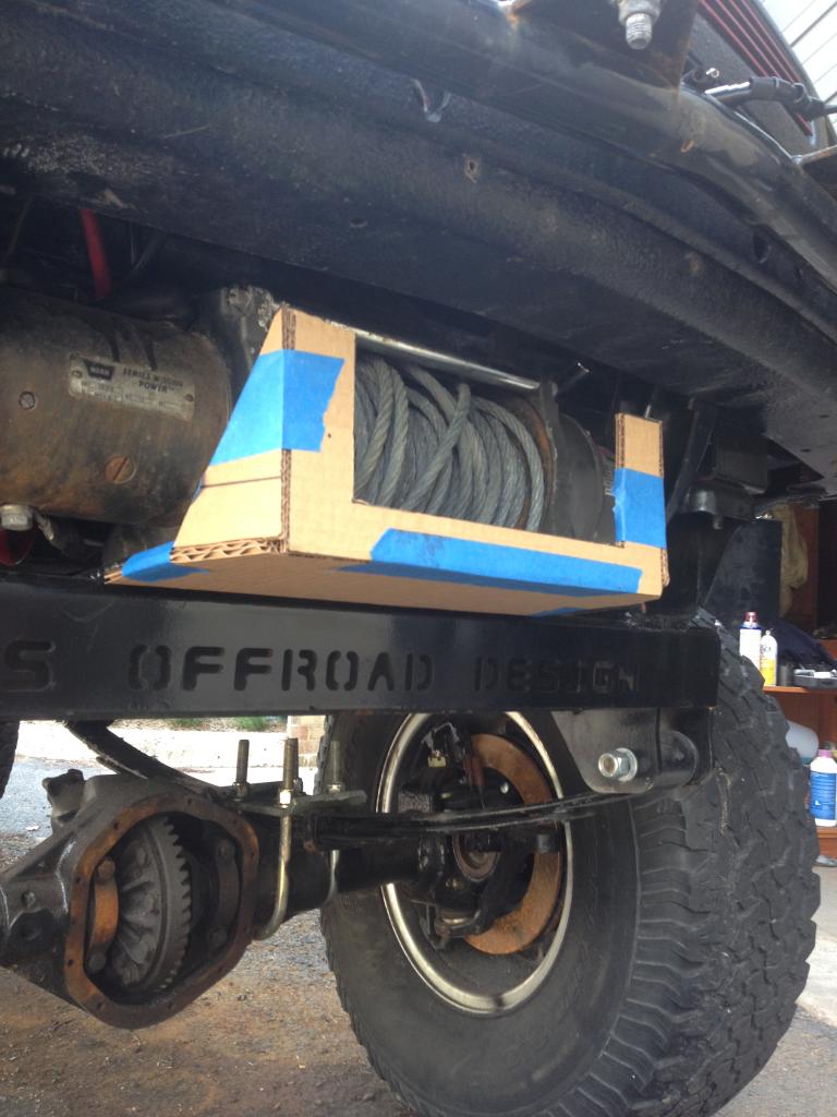

Got started on my fairlead mount today but kept getting interrupted so I didn't get finished yet. It will be removable to ease in R&R of the winch rather than welding it on. I've got all but two pieces cut and ready to weld so I should be able to get it finished up tomorrow. It's all 1/4" plate so it should be plenty sturdy. Here's the cardboard mock up

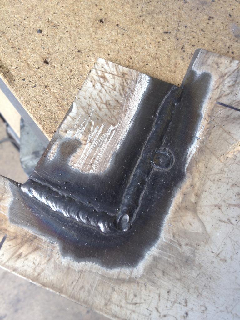

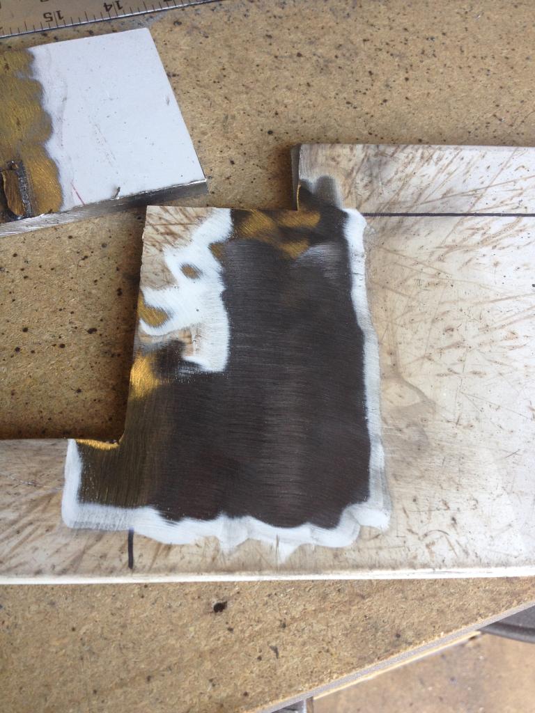

I also ran into an issue of my scrap not being quite wide enough so I made it wide enough lol! I beveled all the edges and welded it up and a few minutes with a sanding disk on the grinder and she's gooder than new!!
Side note: sanding all the powder coat off this steel sucks a** but I guess I shouldn't complain since it was free!

That's some nice welding there. Good job.
