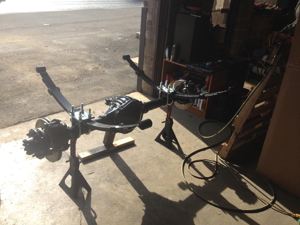

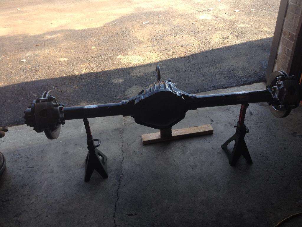

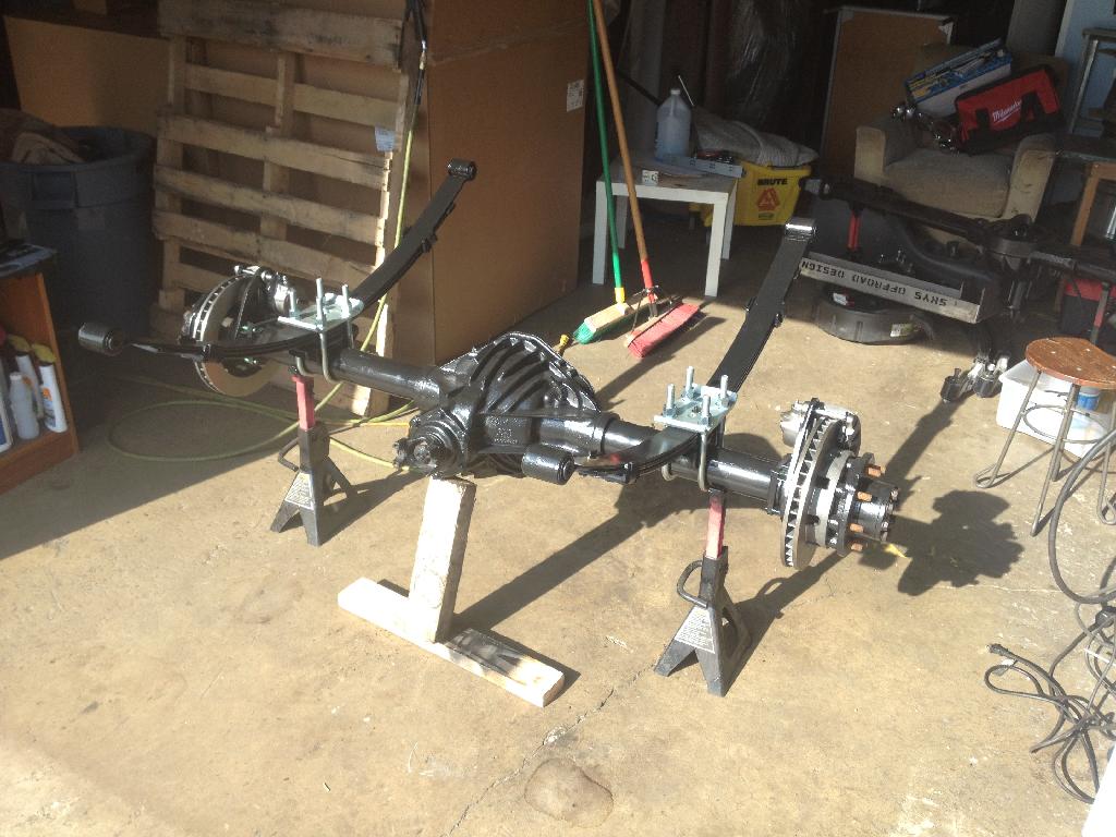

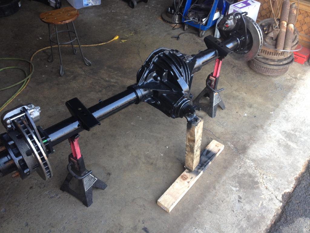

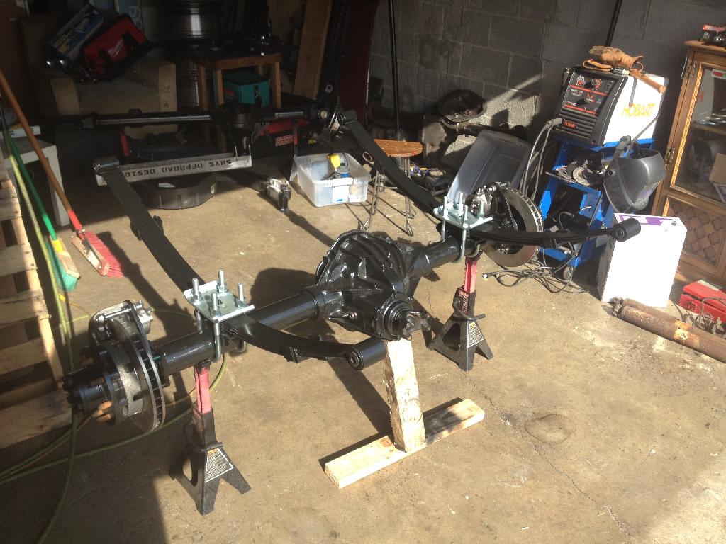

Well the build is still going on with little things here and there as time allows me. Over the last couple days I have managed to get my spring perches welded on and painted and then painted my springs and mounted them so I can get the brake lines made up in the next few days. They are dead level at about a 6-7 degree pinion angle which is what the back of the trans was as as well.

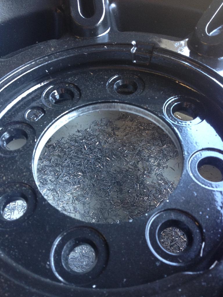

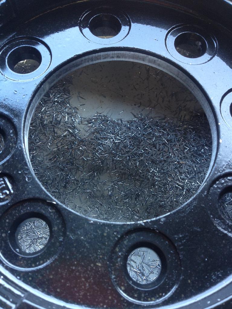

I also got my hub centers opened up on the H2s to fit over the 14 bolt hub. I did all for for rotation and conformity.

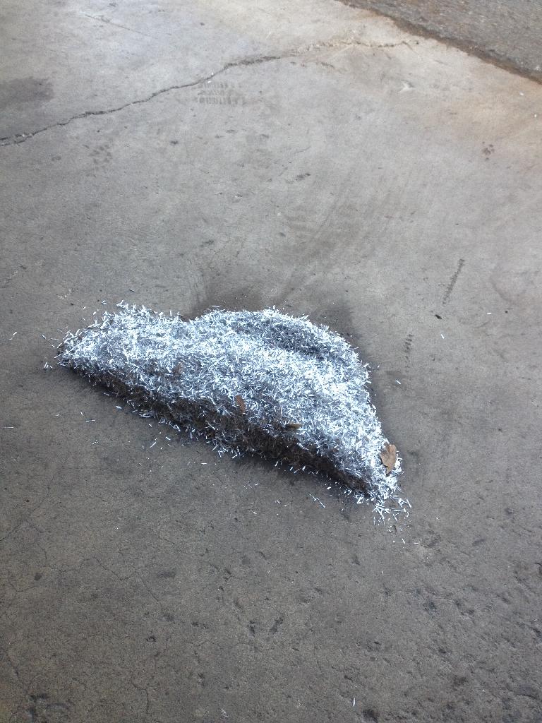

Made a hell of a pile of aluminum shavings!

It's looking good Rex. Do you have an idea how much wider the wheels will sit than your current setup?

Thanks El!! It will be a few inches wider than what it is now. I will see if I can get a shot to show approx difference tomorrow.

Looks like a new axle.
