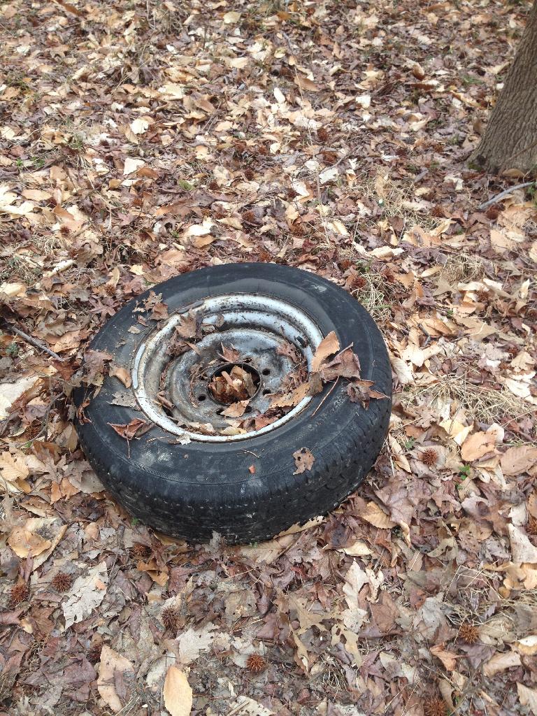

I walked down a trail behind my shop today and noticed a bunch of tires laying around so I figured I would check them out! Nothing good until I came upon these.

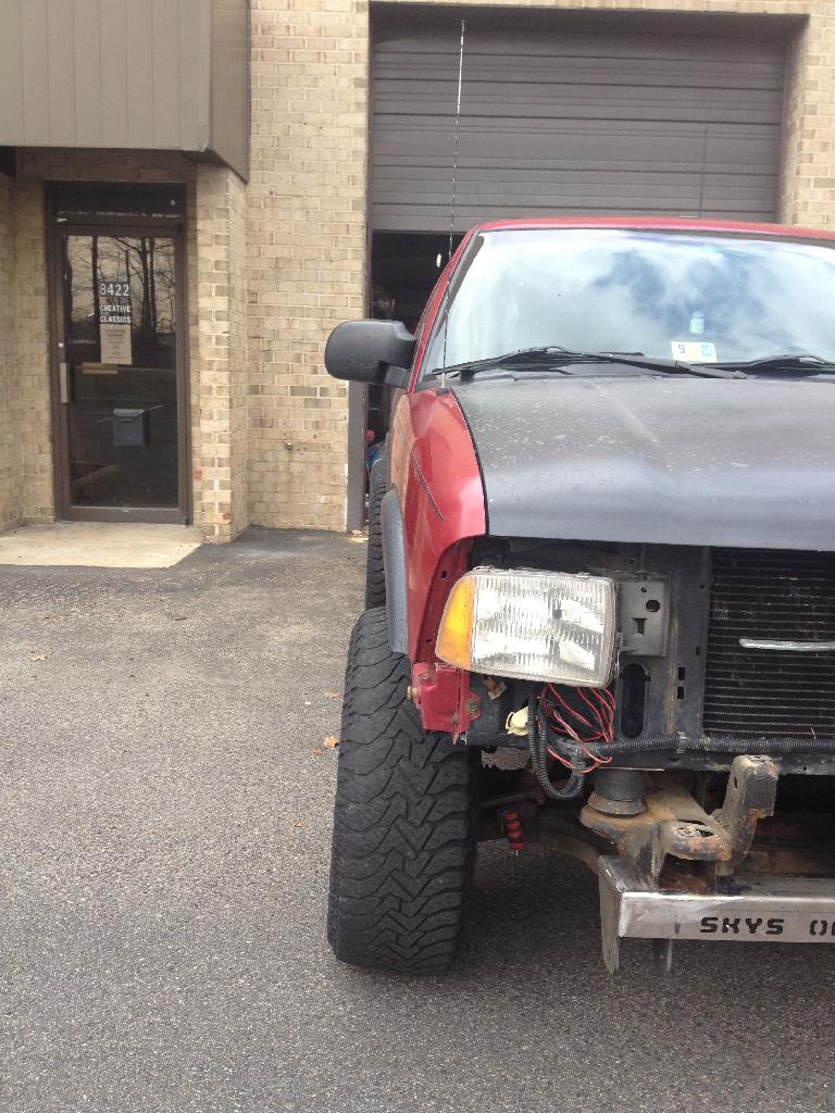

Two perfectly good tires on 8x6.5 wheels!! So of course I wheeled them back to the shop and mounted them on the 14b so I could move it around and play until I get some real tires for the H2 wheels. I decided to see how wide it would be and to my suprise its really isn't much wider than it is right now. Of course these tires are not the 37x12.5s I'll be running but it gave me a good look at it anyway. I was also able to verify that I welded the spring perches on at the correct width lol.
This is with the axle centered. You can barely see the tire peaking out in the back.

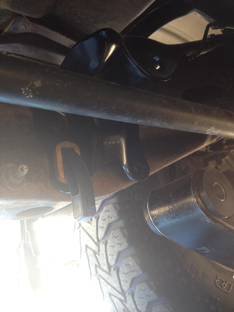

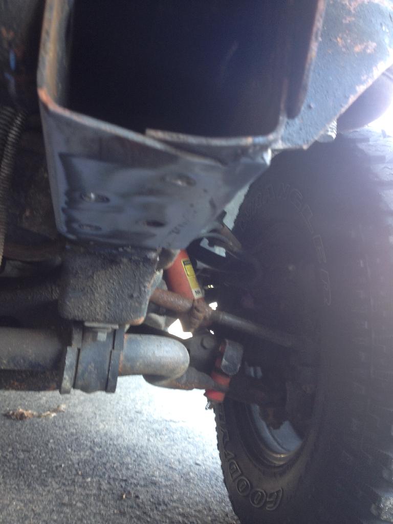

Then I started to look into how I was going to mount my rear hangers and after looking at a ton of the build threads using the Sky kit I just didn't like the options. I don't think any of them are bad I just want my shackles tucked up inside the frame a bit rather than hanging down below it. After looking at the tube thru the frame like rabbit and acehaag have I was thinking of going that route and then I looked a BLZr1's rig again and saw that he used the dakota shackle mounts and shackles. I decided to look into this some more and used google to find shackle hanger pics and found that a ranger's rear shackle hanger is a bolt on piece very similar to the dakota but cheaper They are $20 at advance so I went and picked one up just to appease my curiosity!
Its a bit hard to see in the pics but as far as I am concerned this is going to work out very nicely.
The edge of the mount is almost even with the tbar as is the spring so I think with a bit of careful fab it should work out pretty well.
After checking both sides I ordered the other hanger and the shackles from Advance online using code (TRT30) and saved $21 on the purchase its a $26 savings if I were to return the mount I have and and by two with the code but its not worth the hassle for $6 lol. I will pick them up on my way home tonight. I don't believe anyone has ever used this combo before for an SAS so we will see how it goes and hopefully I have come up with another option for people want to swap their trucks!
