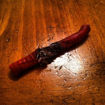

Last night I get home from work and jump in the truck and head down the road to run errands. I go over a speed bump and a few minutes later my stereo starts cutting in and out (like a CD skipping). I get out on the highway and notice that the truck is idling really rough and almost wanting to cut out. Light turns green, I go, truck dies. I fire it up, limp it to a gas station, it dies again. I fire it up again, it barely starts this time and the electrical system is fading in and out until it completely blacks out, locks the key in the ignition and gets stuck in park. WTF.
Somehow, the power cable running from the battery to the main fuse block popped out of its holders on the radiator support and fell down into my belts. The belt chewed through over 50% of the cable.
Made for one hell of a Monday night

Cable replaced, 175 amp fuse in the link replaced...good as new for 20 bucks!
