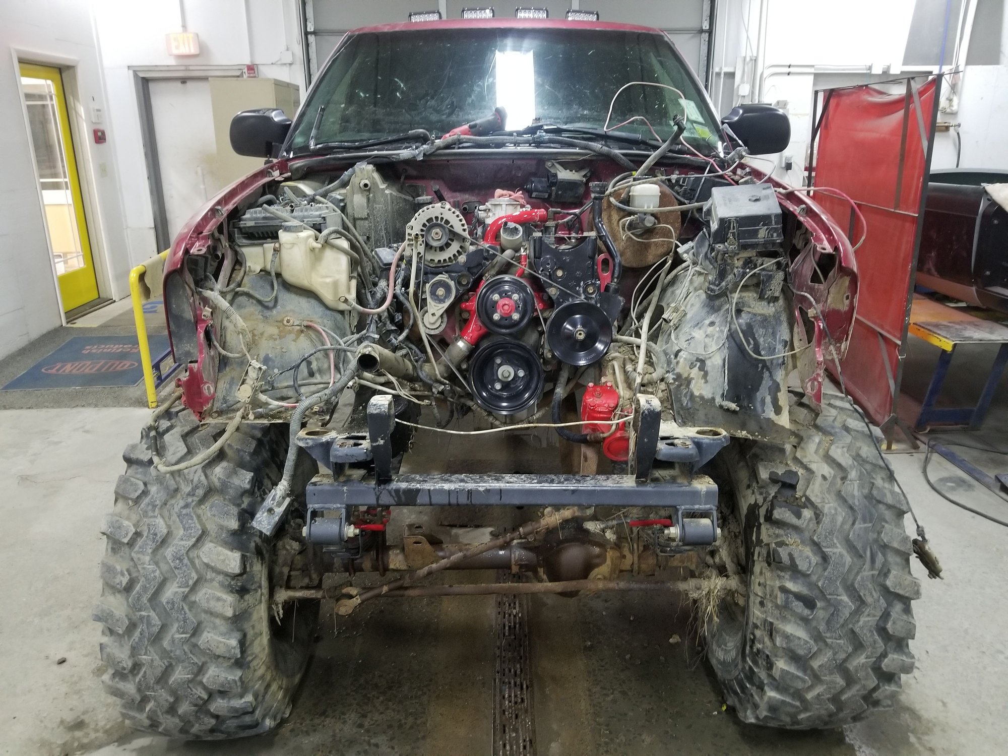

Then the real work started

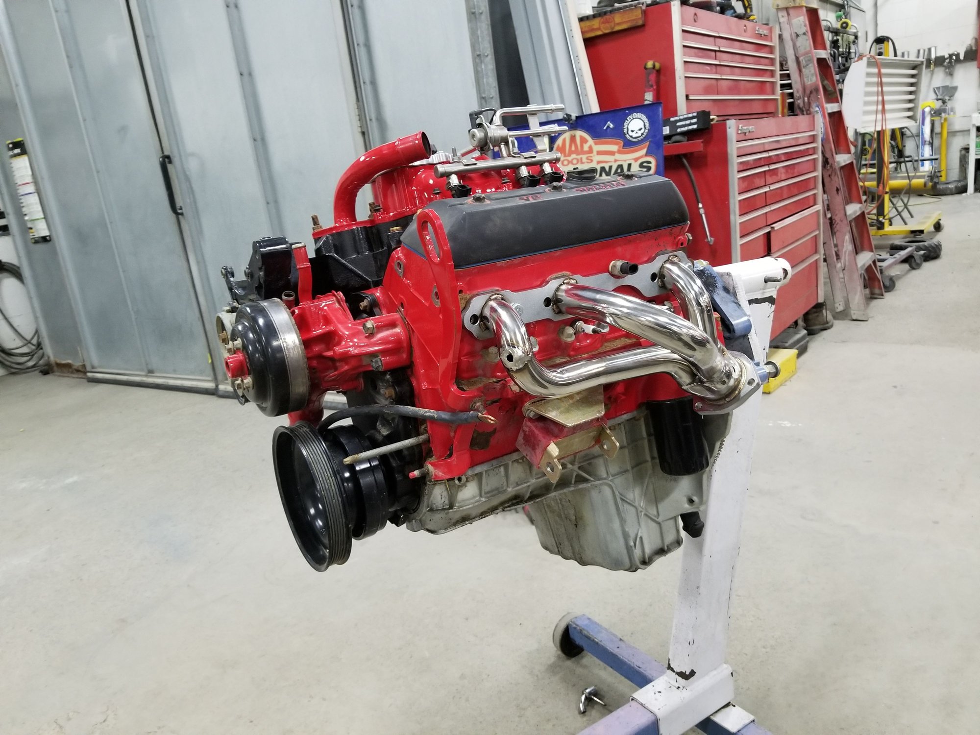

Pulled the motor, it's getting an oil leak fixed from in between the timing chain cover and oil pan. Also ordered a set of stainless headers for it.

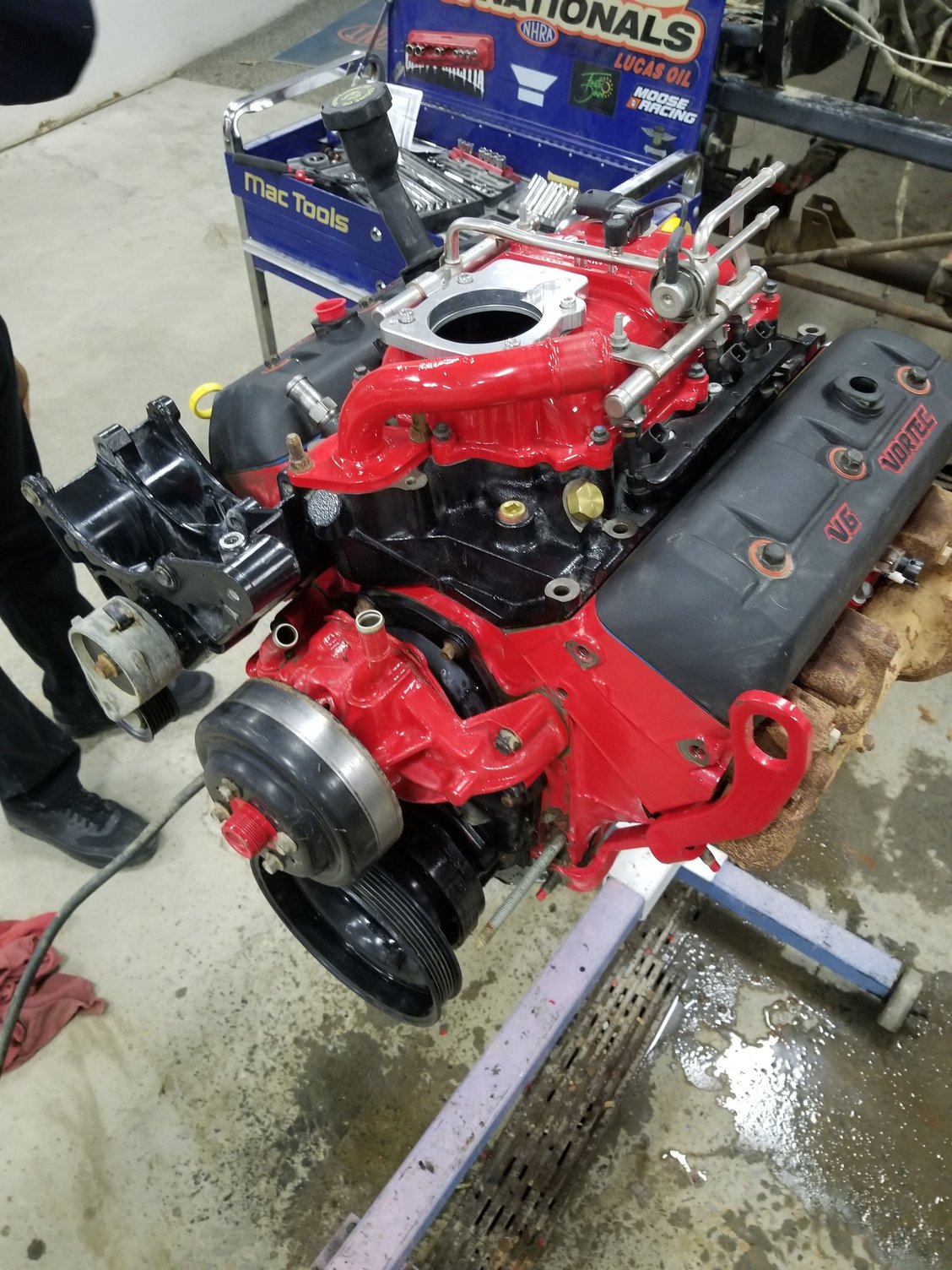

Started mocking up the marine intake.. its finally time to make that conversion happen. Just have a couple things to sort out with it before I put it on. Have to put a fitting on it to run my thermostat bypass hose to, and drill a hole for my map sensor(the port for the marine map sensor is too large for the factory one)

got my headers today so I mocked them up for a test fit. They fit well, I'll just have to get shorty spark plugs to keep the wires away from them.
looks much better than the rusty manifolds. And should flow better too.
I also bolted up my intake manifold... then this happened while torquing it..
thought I was pretty screwed for a few mins. I took it back off and just barely had enough meat sticking up to spin it out with a hammer and chisel. I'll be getting all new bolts and re tapping the holes before reinstalling it tomorrow.
I'm going to have to pull the steering shaft to put the motor back in since it goes thru the headers... so I'm going to take that opportunity to do the flaming river ujoint mod.
